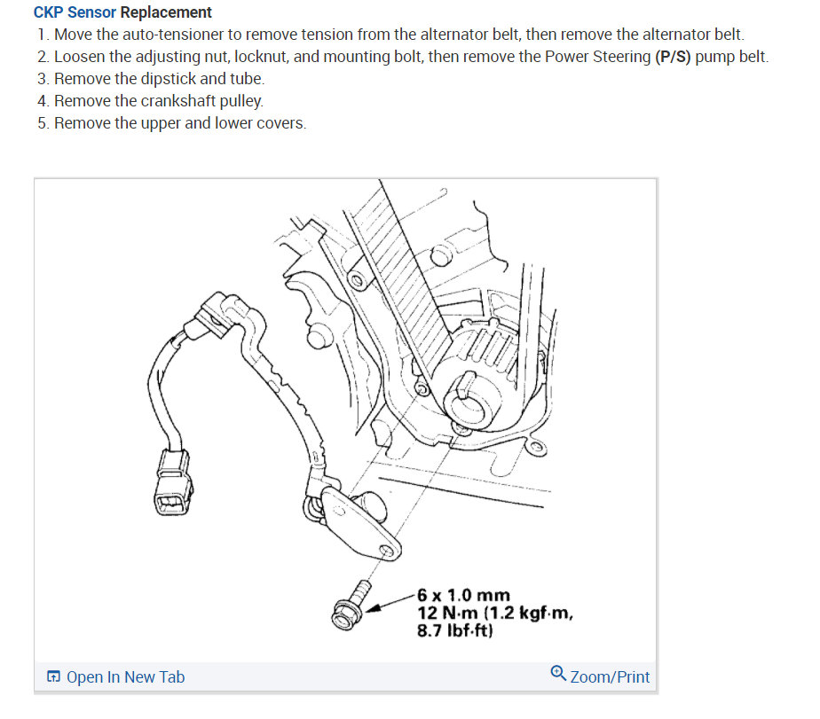

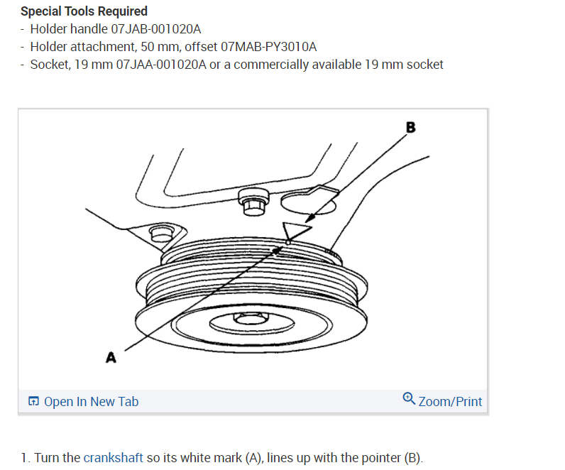

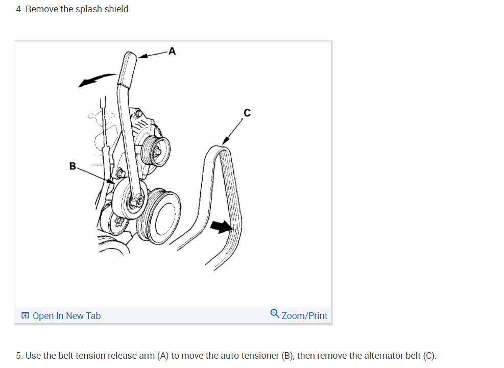

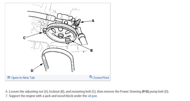

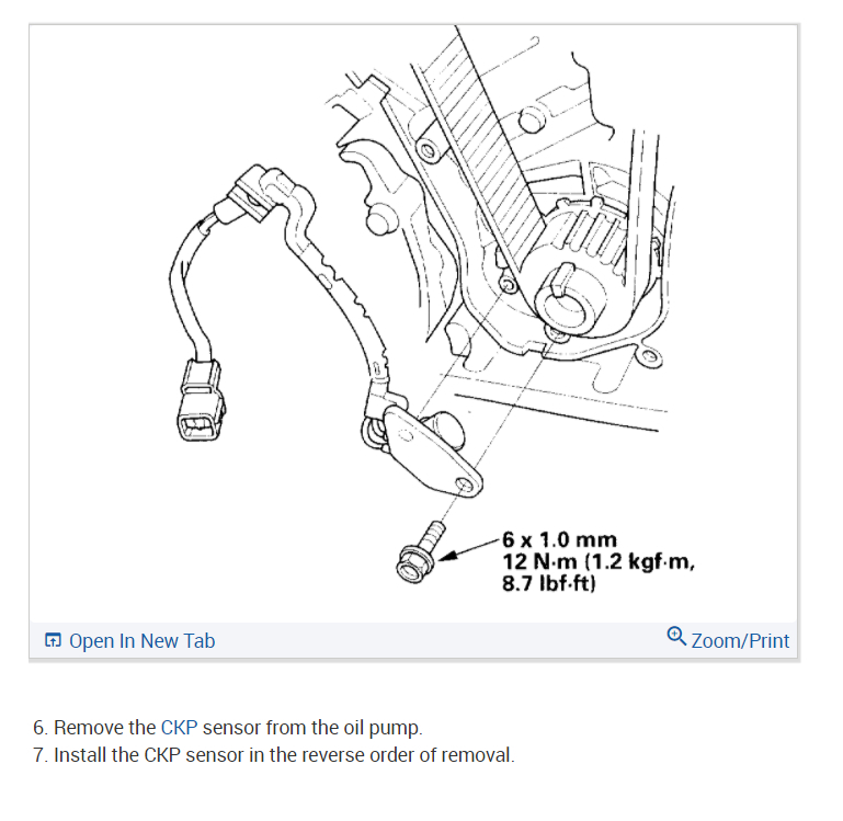

I am trying to replace the crankshaft position sensor. I am having trouble locating it. What all needs to be removed to get to it
Apr 12, 2021 at 4:11 PM
Good morning,

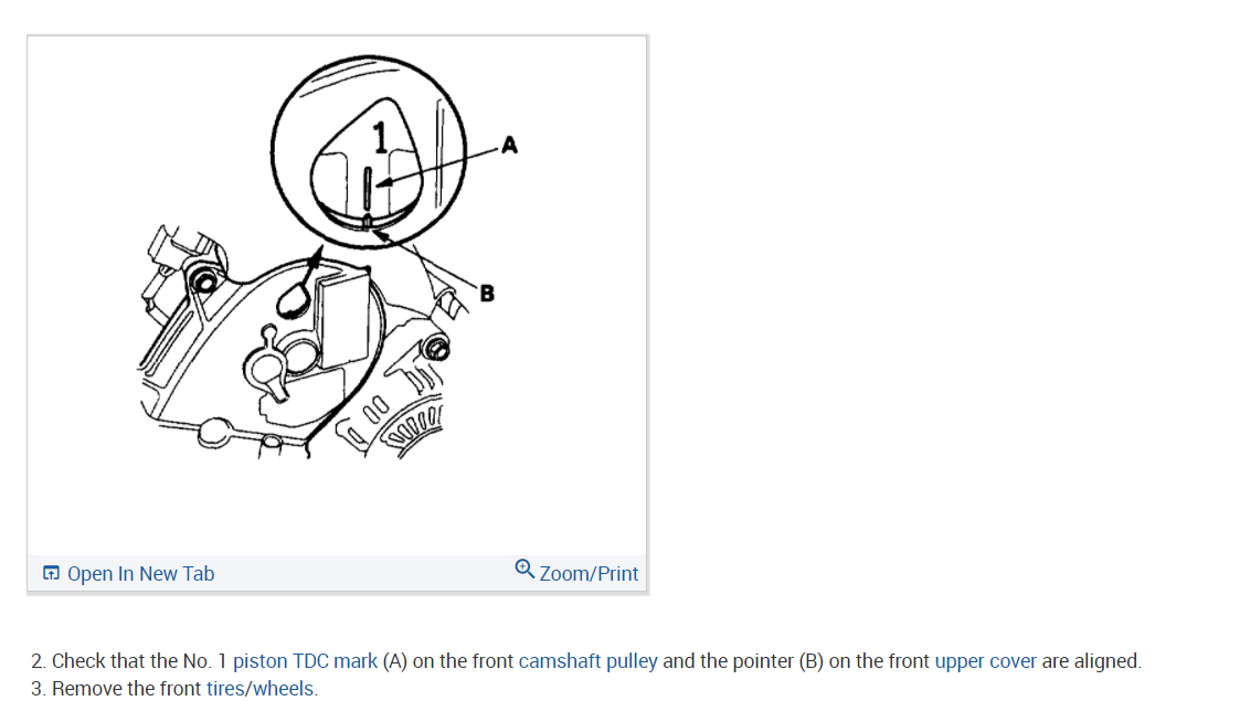

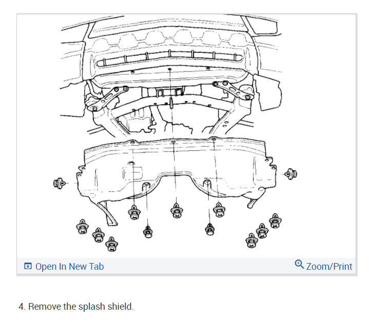

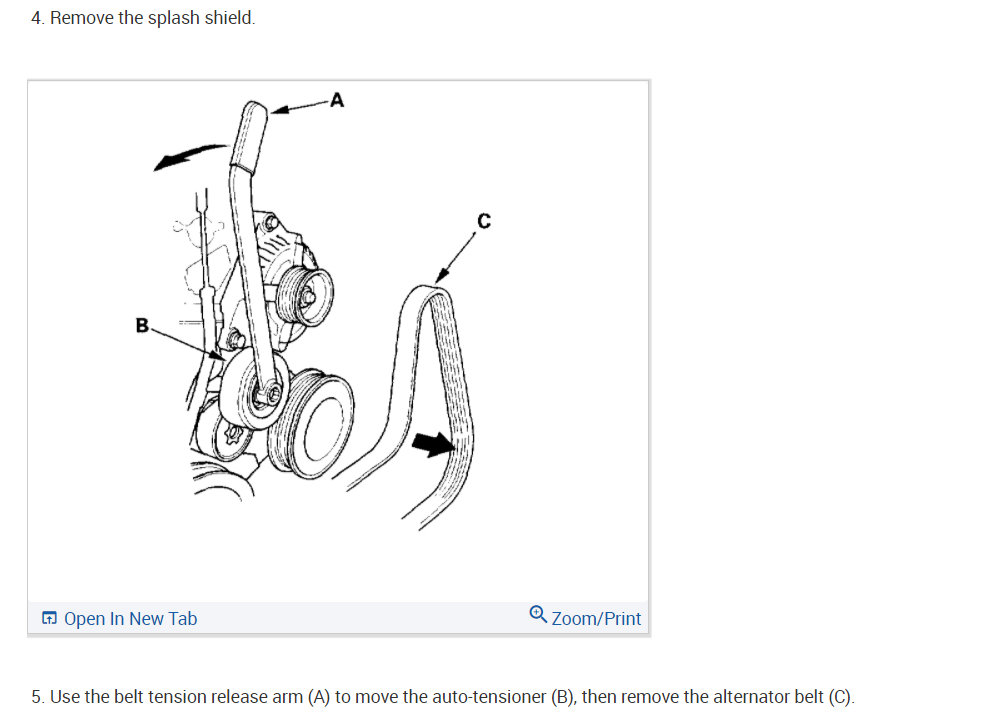

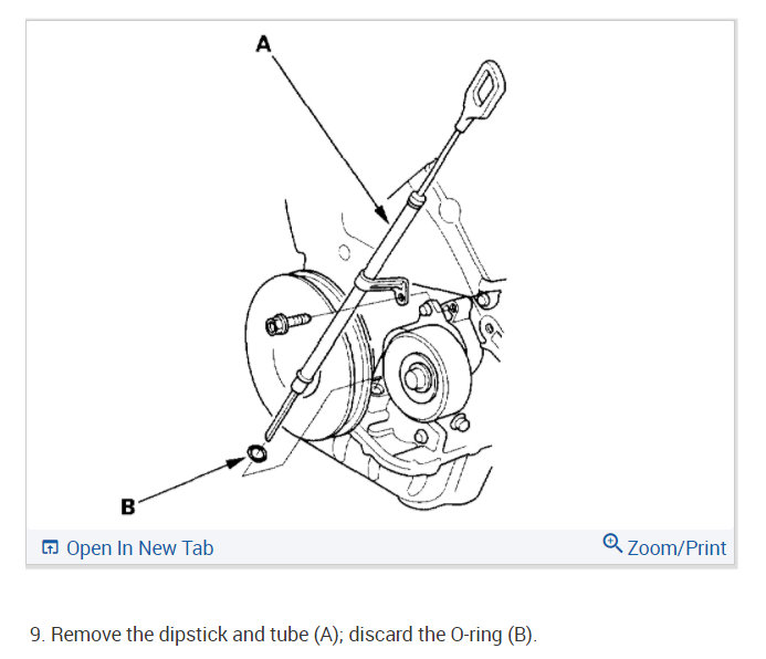

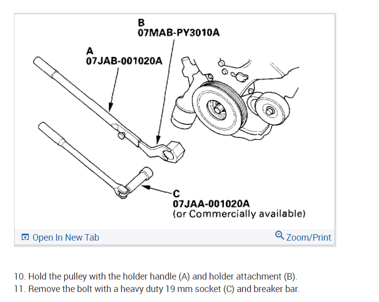

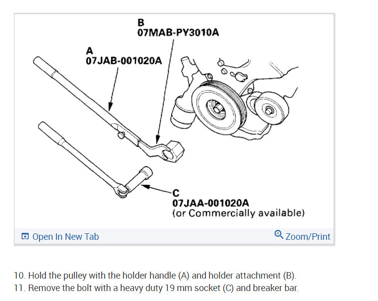

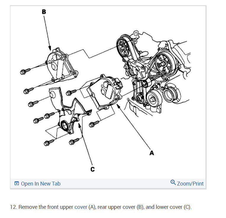

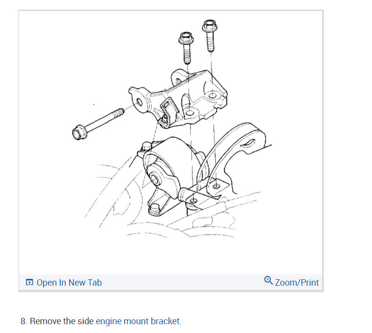

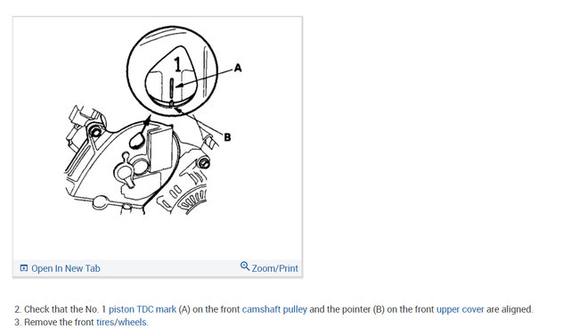

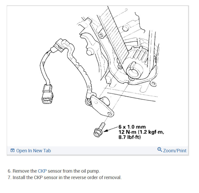

I attached the steps for you for the replacement of the crankshaft position sensor below. It is under the bottom cover for the timing belt at the crank pulley.
Apr 12, 2021 at 6:45 PM
