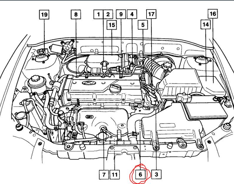

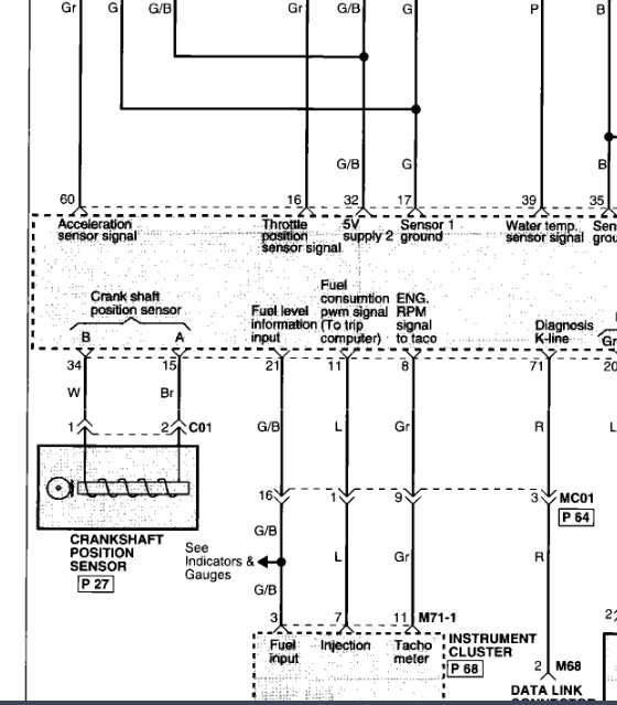

I need to know which is the ground running from my sensor there are 3 wires black,yellow,white. please help

According to the wiring diagram the crankshaft position sensor is 2 wires-Black and Brown. I've attached pictures below of the wiring diagram and its location. Hope this helps and thanks for using 2CarPros.
