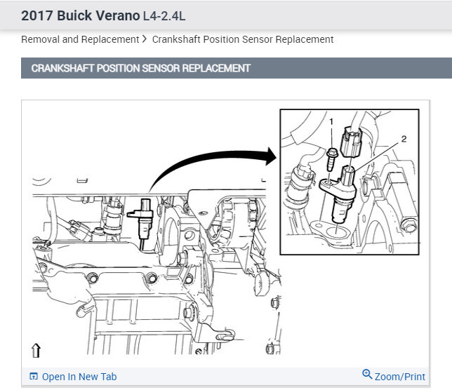

Where is the crankshaft position sensor located?
2017 BUICK VERANO
68,000 MILES • 2.4L • 4 CYL • 2WD • AUTOMATIC
CHRIS MARSHALL
I cannot find something that will tell me where the crankshaft position sensor is. And I can't seem to find it.
Sep 7, 2023 at 4:23 AM
  • 110,244 POSTS

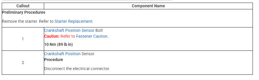

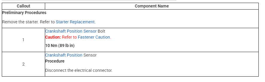

The starter needs to be removed for you to see it. If you look at the pics below, I attached the directions specific to this vehicle for replacing it.
