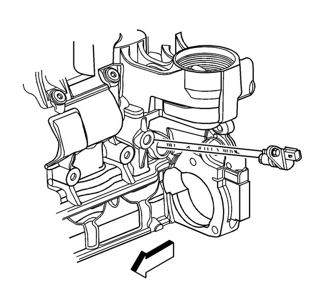

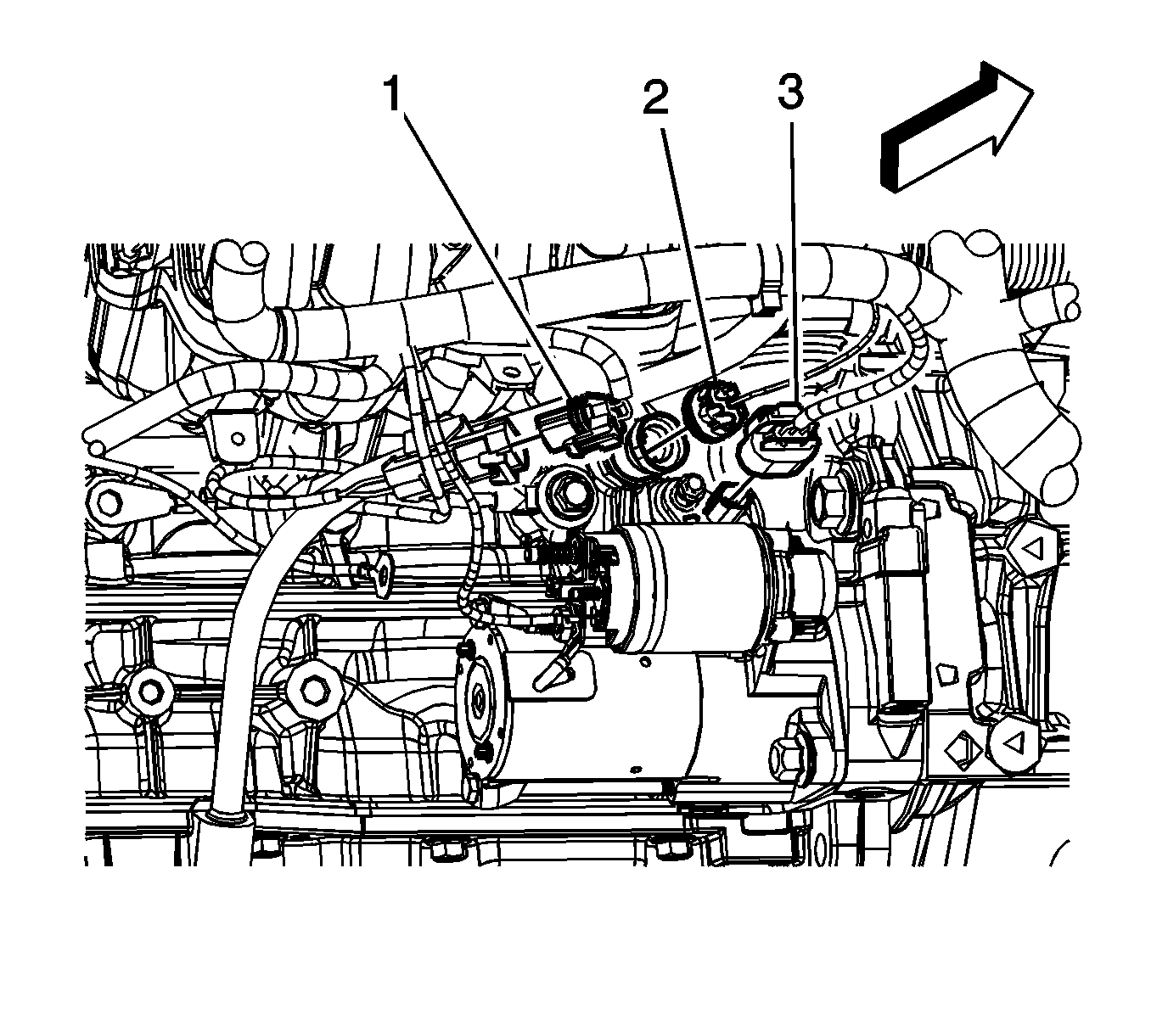

Here are directions for removal and replacement. Make sure you did what the directions indicate. The attached pictures correlate with these directions.

picture 2
3. Remove the CKP sensor bolt.
4. Remove the CKP sensor.
INSTALLATION PROCEDURE
picture 2 again
1. Lubricate the CKP sensor O-ring seal with clean engine oil.
2. Install the CKP sensor.
NOTE: Refer to Fastener Notice in Service Precautions.
3. Install the CKP sensor bolt.
Tighten the sensor bolt to 10 N.m (89 lb in).
picture 3
4. Install the starter.
5. Connect the CKP sensor electrical connector (3).

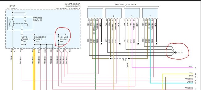

Since the issue changed after replacing the sensor, that sounds like where the problem is. Have you checked the connector? Has anything come loose?
Take a look at the attached pic. Check the fuse I circled as well as check for ground for the coils.
Let me know what you find.
