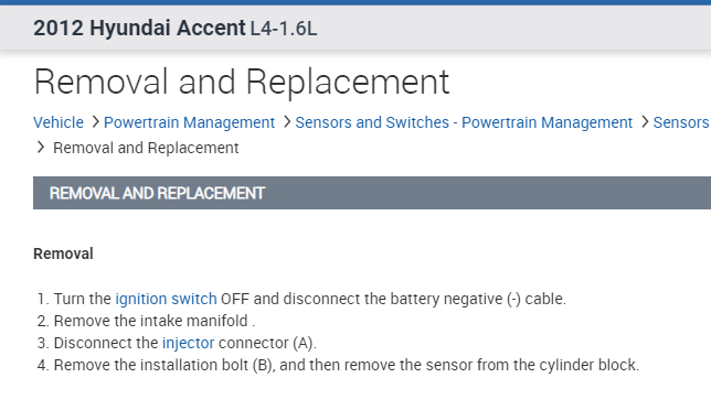

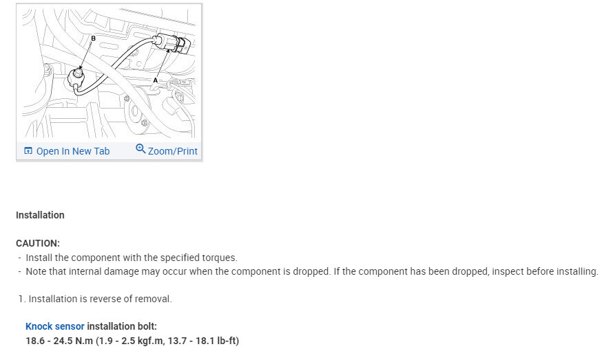

Hello! I wanted to let you know that I think we have found the problem. As of two days ago I had a check engine light come on, and was finally able to have a test ran. The code for it was the code for the Knock Sensor ignition piece. That was the only code though. I’m going to replace this sensor and hope that this will fix the problem.
Sep 10, 2023 at 11:31 AM
  • 110,244 POSTS
Thanks for the update. I'm glad to know you were able to get a code.
If you look below, I attached the directions for replacing the knock sensor. I don't know if you need them, but I figure I would add them just in case. Also, if you let me know the code that was found, I can see if there is anything other than the sensor that may have caused a problem and let you know.
Take care of yourself and if you have a chance, let me know if the sensor resolves the issues.
