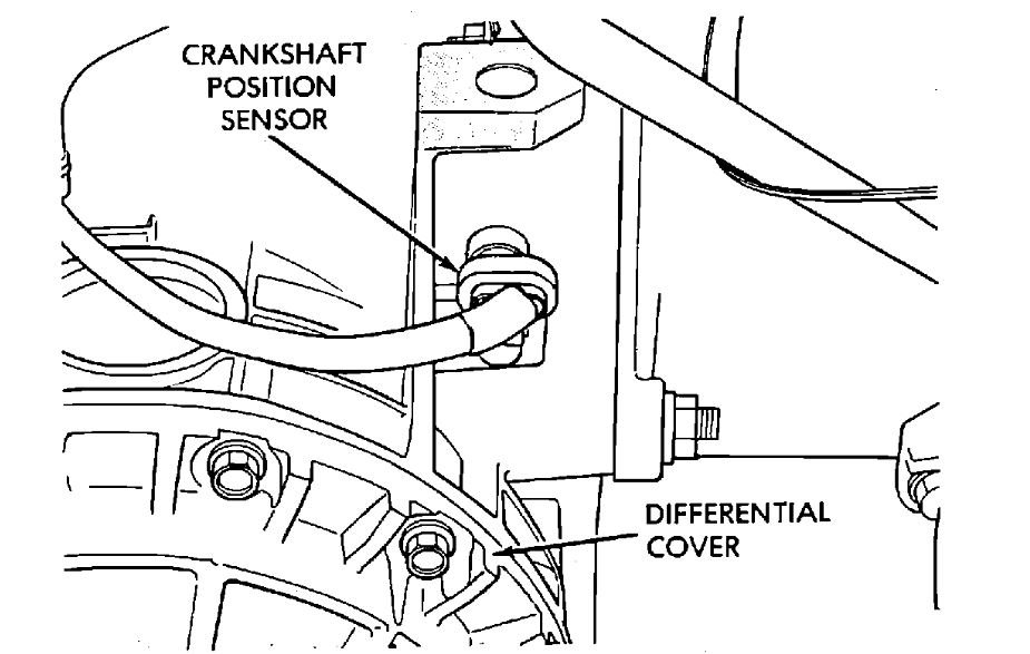

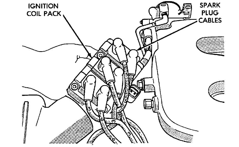

Replaced alternator and fuel pump, but no spark.
Mar 9, 2019 at 1:30 AM
Good morning,
There are several V6 engines.
Can you tell me the size? 2.7 or 3.5? That way I can get you the exact locations as they differ.
Mar 9, 2019 at 4:46 AM
DAMARIS H
3.5.
Mar 9, 2019 at 6:22 AM
Below are the locations and procedures for you to view.
Crankshaft sensor attached
REMOVAL/INSTALLATION
1. Disconnect sensor electrical connector.
2. Remove sensor mounting bolt.
3. Remove sensor from vehicle.
NOTE: DO NOT pull on sensor electrical lead.
4. Reverse procedure for installation.
Coil
REMOVAL
1. Remove spark plug cables from coil.
2. Remove electrical connector.
3. Remove ignition coil fasteners.
INSTALLATION
1. Install ignition coil fasteners and torque to 12 Nm (105 in-lb).
2. Install electrical connector.
3. Install spark plug cables to coil.
