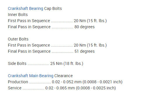

Installed crankshaft bearings and crankshaft checked clearance was in spec.

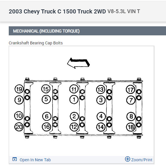

Installed caps and tightened to correct torque and angle to all bolts’
I know the numbers on crankshaft is correct for 5.3. I go to turn it and it’s locked up.

Will it turn if you loosen the main bearings one at a time, is there one that is loosened that will allow the crankshaft to turn? You lost clearance on one of them. Also, do you have Plastigauge available to you? If so, remove the caps and test each one. One of them is causing the problem.
I attached the torque sequence and torque below. Let me know if that is what was done. I don't think over-tightening would cause this. I suspect there isn't enough clearance at some point, but anything is possible.
