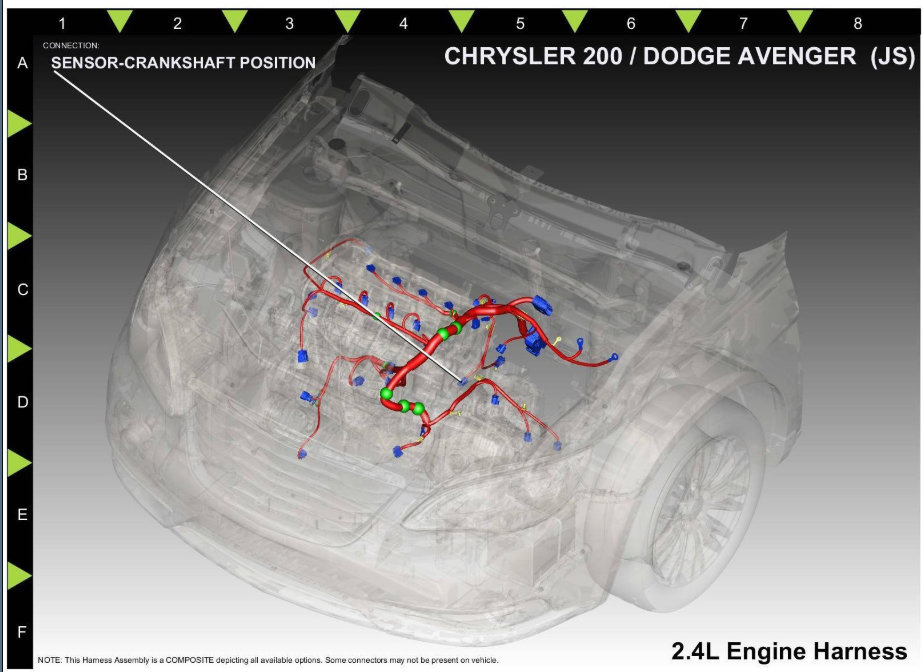

Need to know where both of the camshaft sensors and the one crankshaft sensor are located. Engine is a dual vvt 2.4l.
Apr 26, 2020 at 1:44 AM

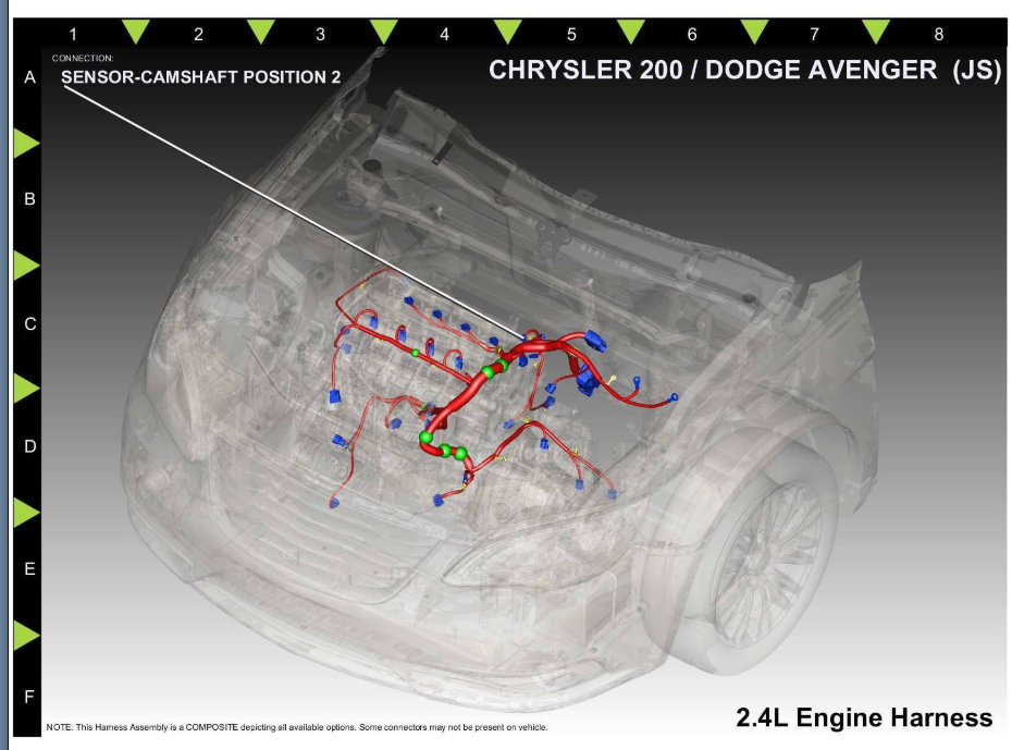

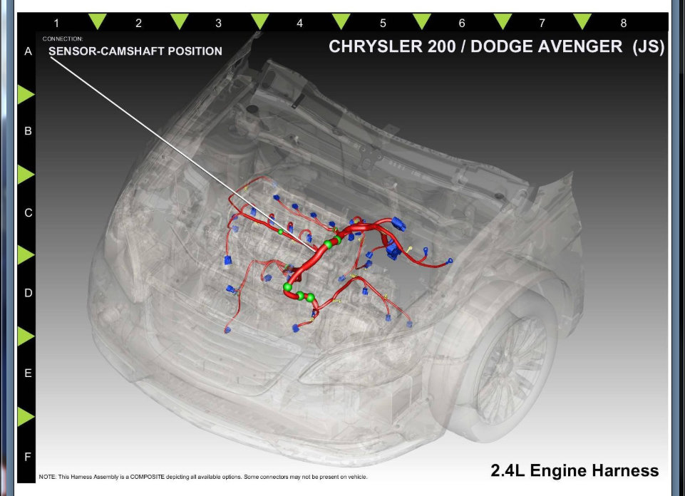

I attached the locations of each sensor. Please let me know if you need more info and I will send it over. Or if you need help figuring out your issue, just provide the detail of what is happening. Thanks
Apr 26, 2020 at 1:52 AM
DONNERGIRL
Hi, thank you for your quick response. The diagram for the crankshaft sensor doesn't add up to what's on the car, can't tell exactly. Can you send me a better detailed view please? Thank you and have a Blessed day, Donna
Apr 26, 2020 at 2:22 AM
DONNERGIRL
Hi Kenny, I found it down at bottom of heat shield. Boy the 2 camshaft sensors were melted and one was broken off inside and had to lay across motor and whittle the plastic out with tiny eye glass drew driver, all while doing it blind, just by feel. Thank you So very much for all your help! Have a Bless Sunday and you and your family stay safe and protected!!!
Donna
Apr 26, 2020 at 4:25 AM
Thanks for the update. Glad you got it. You stay safe as well. We are almost through this.
