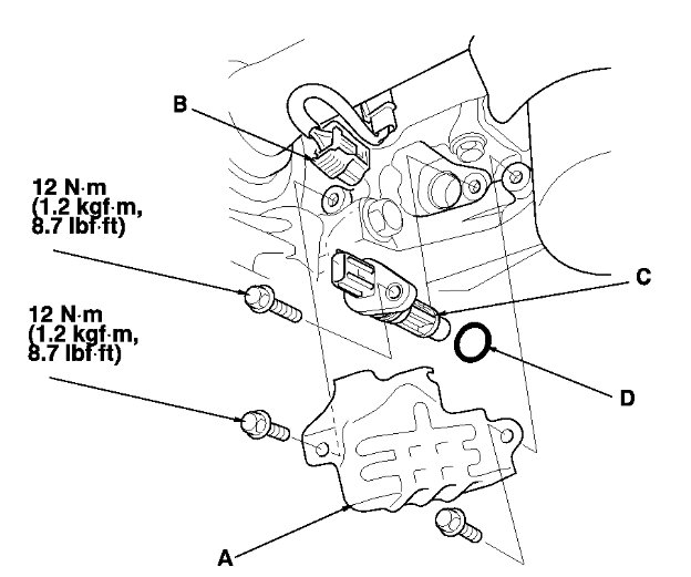

If I put a crank shaft sensor on my car listed above EX model, but the sensor is LX will it work?
Tuesday, April 14th, 2020 AT 10:14 PM
DANNY L
MECHANIC
5,648 POSTS
Hello,I'm Danny.
Yes, the sensor is the same for both the 2.4 liter EX and LX. Here is a tutorial showing what is involved for the replacement:
I've attached a picture with instructions below.Hope this helps and thanks for using 2CarPros.
