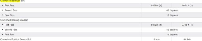

I need crankshaft pulley torque.

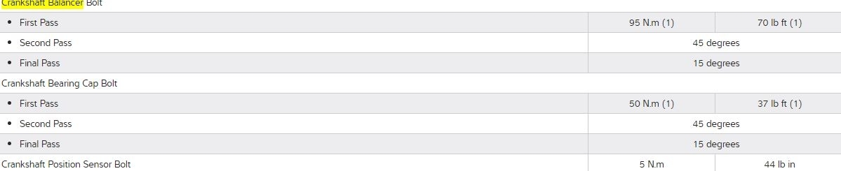

I believe you are referring to the crankshaft balancer (harmonic balancer). I have attached the torque specification for all crankshaft related bolts for your review.
Let me know if this helps.
