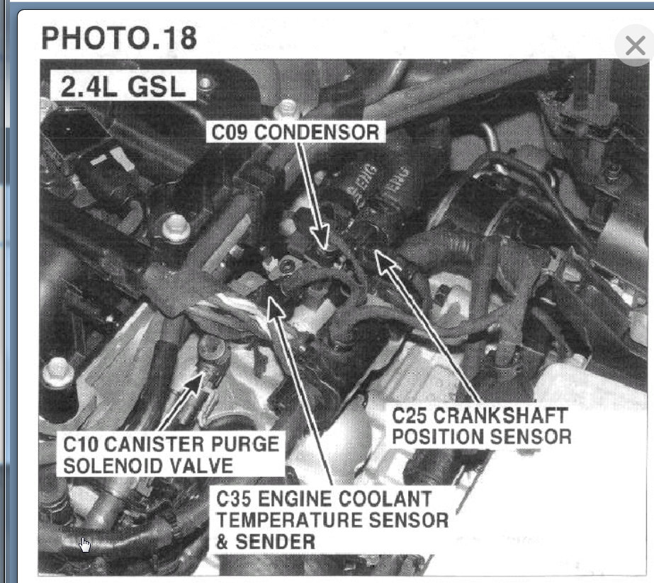

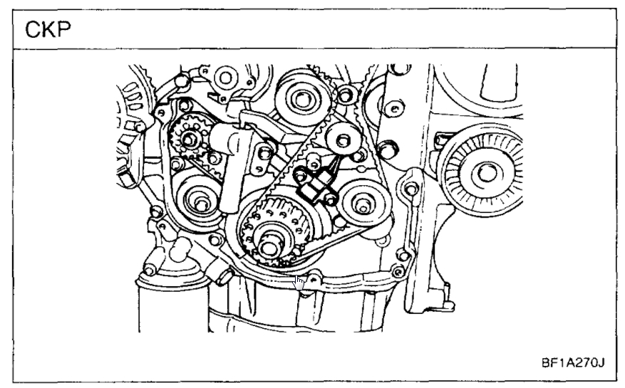

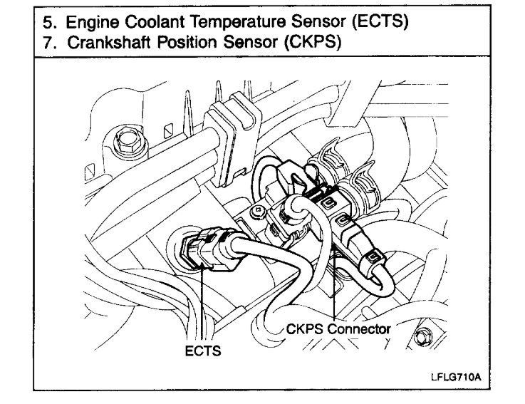

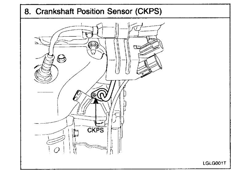

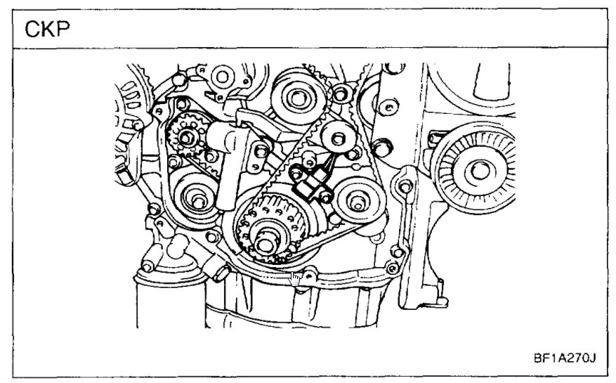

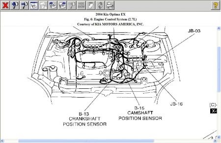

Good morning,
You did not list the engine size so I attached pictures of both engines of the location. Why are you replacing the sensor? Do you have a code or does the engine not run? Check out the diagrams (Below). Please let us know what happens.

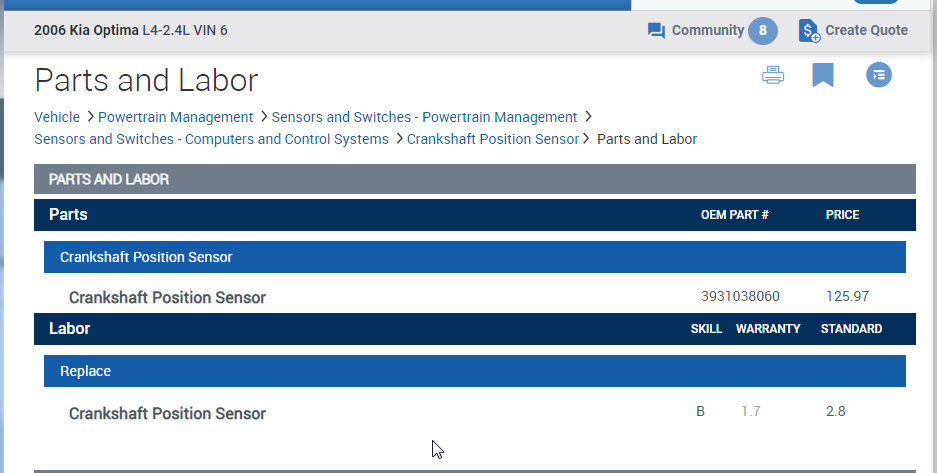

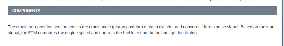

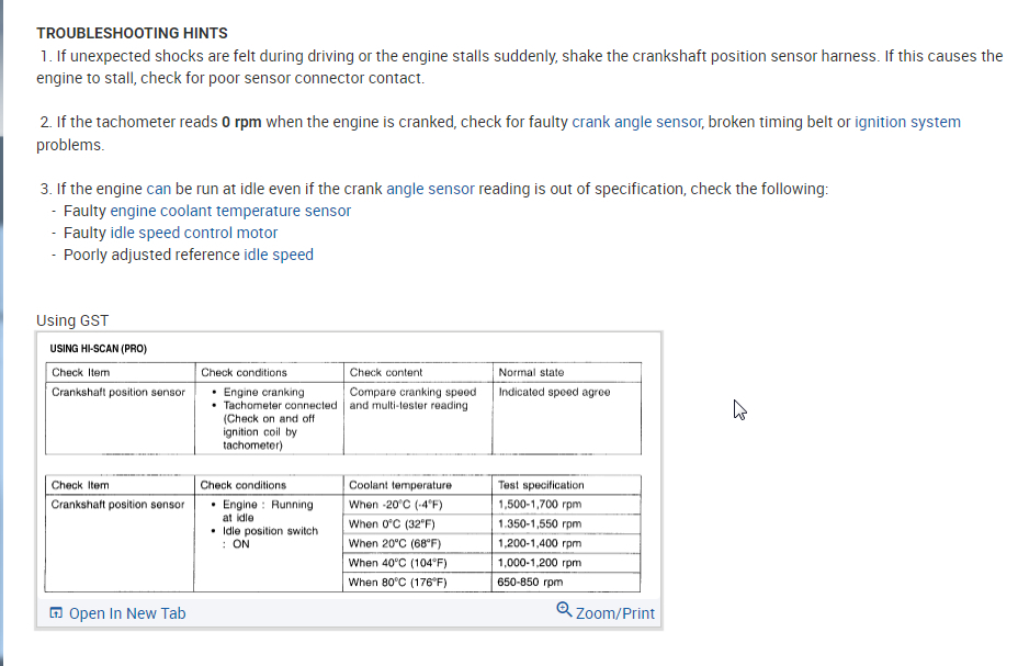

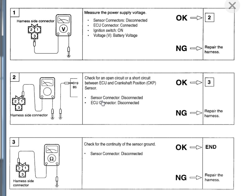

Where is the problem here im find a lot of different opinions some say the ifs sensor or crank sensor or cam sensor car runs fine light just came on?
Friday, February 5th, 2021 AT 10:16 AM (Merged)

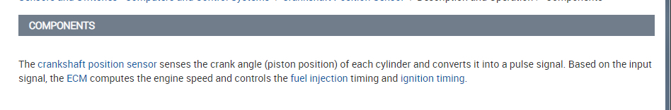

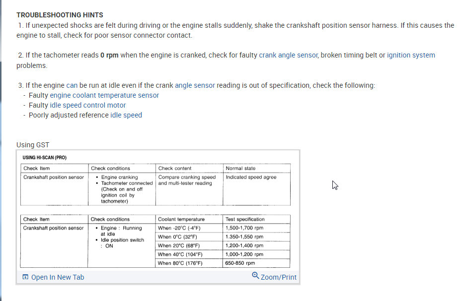

Here are some guides on how to replace the CKP sensor plus some more info on what happens when a CKP sensor fails.
Plus here is some more info on how to replace, location, and general info on the crankshaft position sensor.
Let us know if you need more info. Thanks

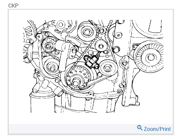

I need to know the location of the crankshaft position sensor, and the location of where each end plugs in.
+1
Friday, February 5th, 2021 AT 10:17 AM (Merged)
  • 75,992 POSTS
See below, the other end is at the computer
https://www.2carpros.com/forum/automotive_pictures/12900_cps_8.jpg

Engine cranks but no ignition to plugs code is PO335 crankshaft position sensor circuit malfunction. Will this code cause no ignition. Where is the sensor at.
  • 75,992 POSTS
The CPS is on front of engine
https://www.2carpros.com/forum/automotive_pictures/12900_cps_44.jpg

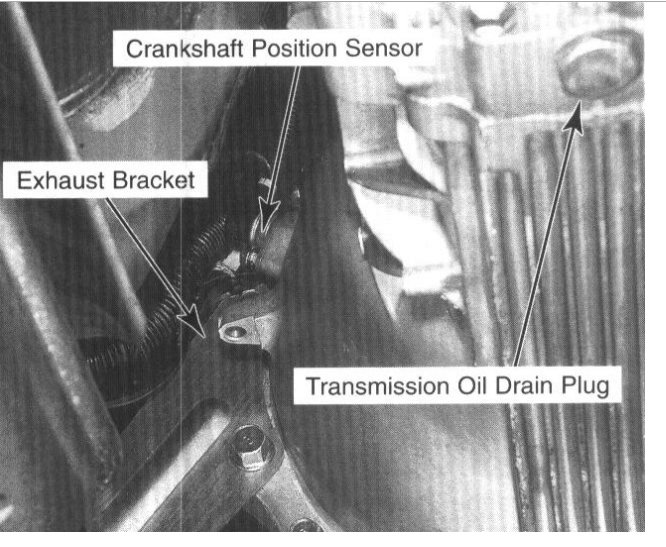

Where is the crankshaft position sensor located in 2.7 v6 engine
Friday, February 5th, 2021 AT 10:27 AM (Merged)
KHLOW2008
  • 41,814 POSTS
The crankshaft angle sensor is located on the bell housing on the drivers side here is a guide to help you see what you are in for when doing the job.
Cheers

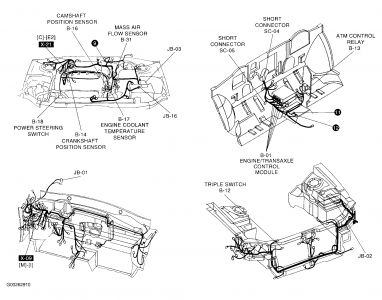

SANRON1
  • 2001 KIA OPTIMA
I would like to know location and how to route wire?

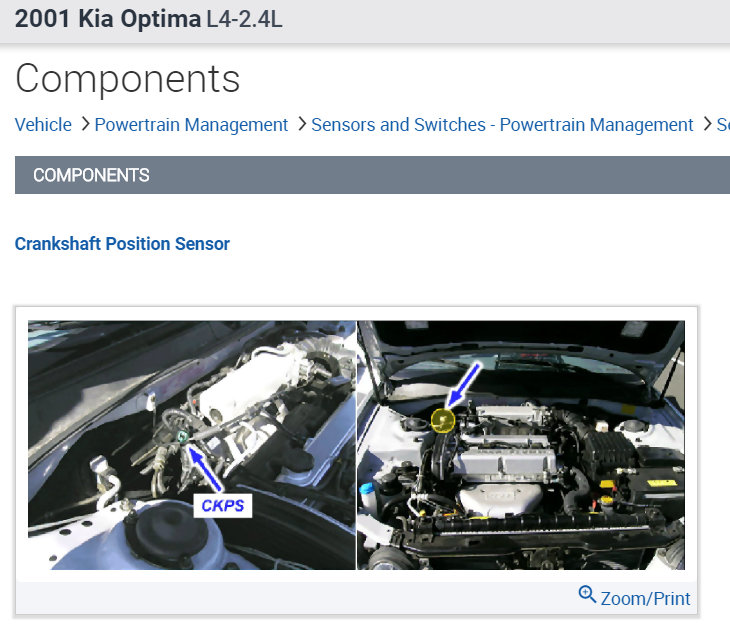

  • 75,992 POSTS
Here is a guide to help you see what you are in for when changing the sensor out plus the location of the sensor for both the four and six cylinder engines below. Check out the diagrams (below). Please let us know if you need anything else to get the problem fixed.
