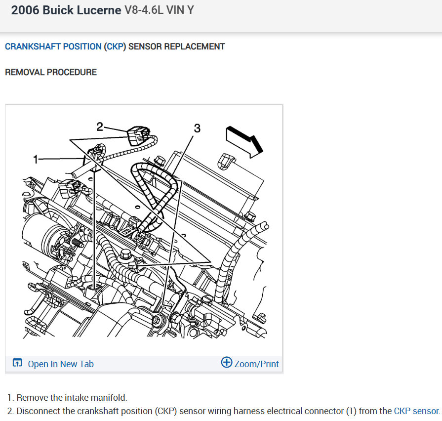

Where are the crankshaft position sensors located on the vehicle listed above CXS?

Wow, you are not going to like this, it is under the intake manifold. Sometimes GM misses the mark when it comes to ease of service. :/

Yep, it sure is. here is an image so you can see. Check out the images (below). Let us know if you need anything else.

Ken L, can you tell me where i can find that picture?
Sep 14, 2025 at 9:09 AM
  • 55,694 POSTS
It is in the post above you, I got the image from Alldata which we have permission to do.

No, you can get a DYI subscription for it. You need to remove the intake manifold.
1. Remove the intake manifold.
2. Disconnect the crankshaft position (CKP) sensor wiring harness electrical connector (1) from the CKP sensor.

Ok, cool. Thanks and will do. I've already had to take the intake manifold off about a month ago to replace the starter, which turned out not even being the problem.
Sep 14, 2025 at 11:41 AM
  • 55,694 POSTS
Sorry about that, bad timing, it might be the connector is not fully seated. Let me know when you remove the intake.
