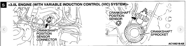

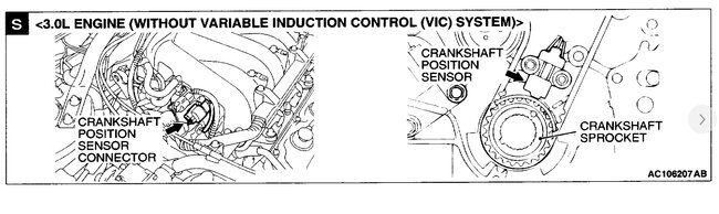

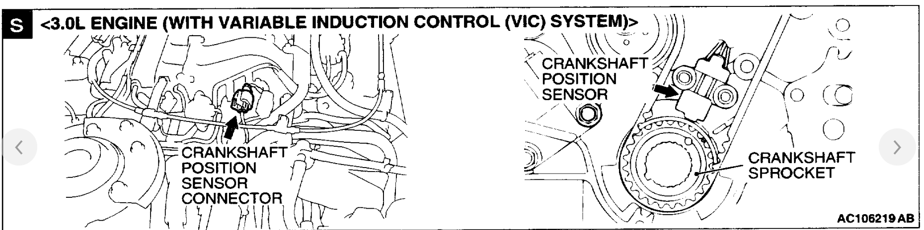

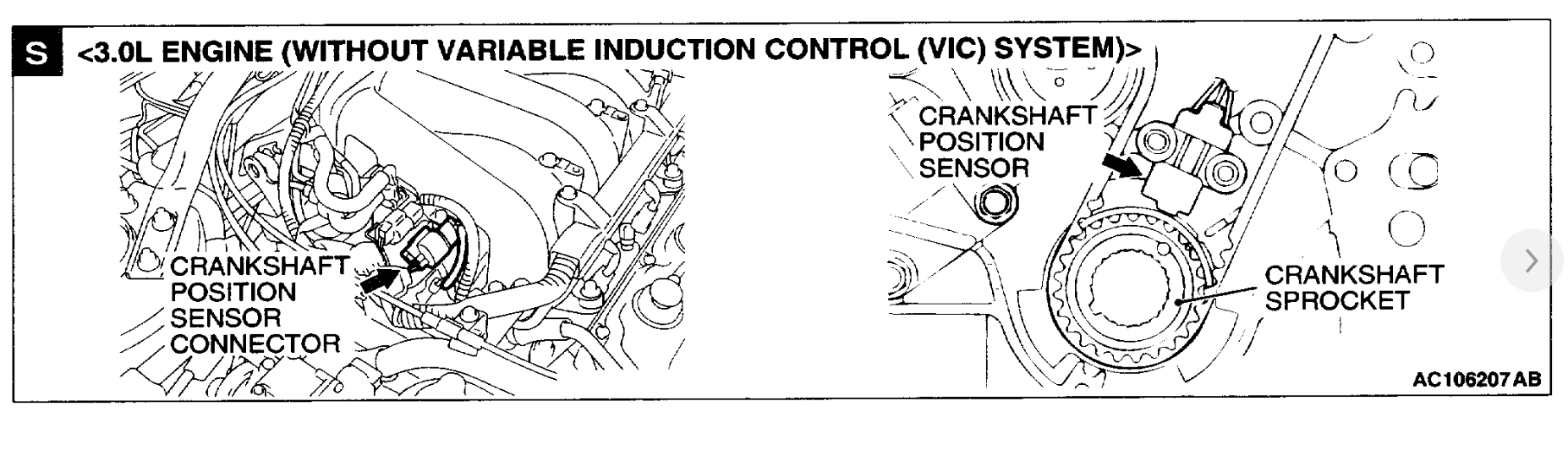

No power to plugs , will crank wont start. Shut off while driving . Checked every fuse .
Jun 12, 2023 at 3:20 AM
  • 55,770 POSTS
When the engine has no spark most of the time it is a crankshaft angle sensor here is the location and how to change it out in the images below. Also, I have included two guides that can help as well.
https://www.2carpros.com/articles/how-to-check-for-ignition-spark
and
https://www.2carpros.com/articles/car-not-running-advanced
