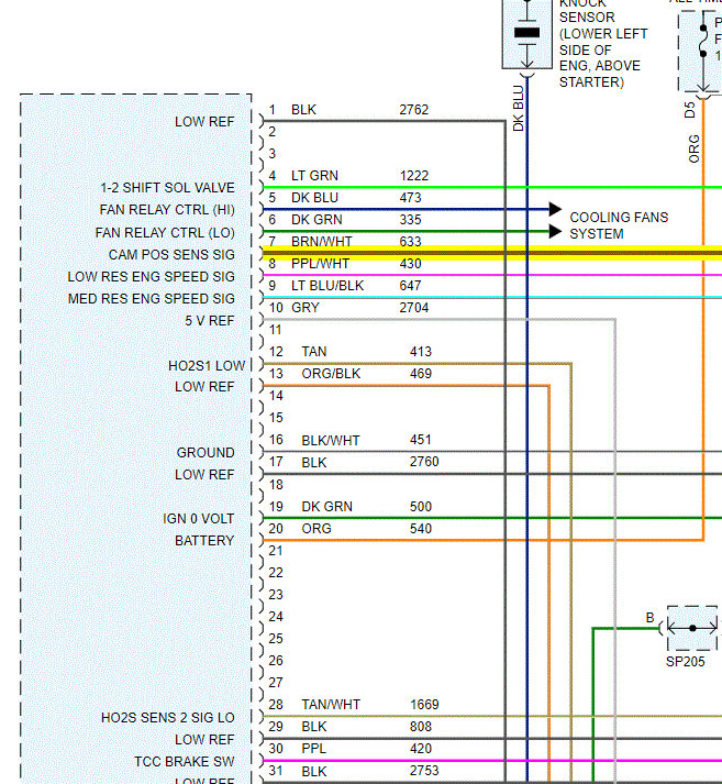

I scanned it with SnapOn Ethos it says no cam present in the data. I replaced cam sensor and PCM. There’s like a 16 wire connector for the fuel injectors and I don’t get any pulse there there’s power. I think the cam sensor comes out of that harness also it plugged in under the power steering pump. Does anyone have a diagram of that connector?

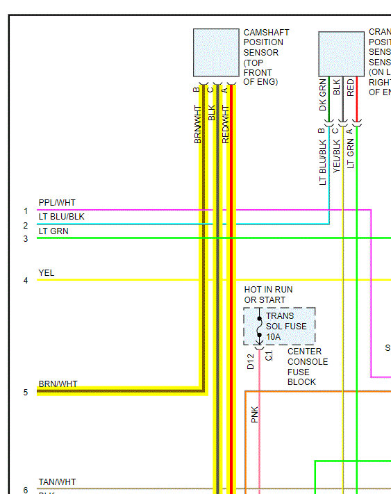

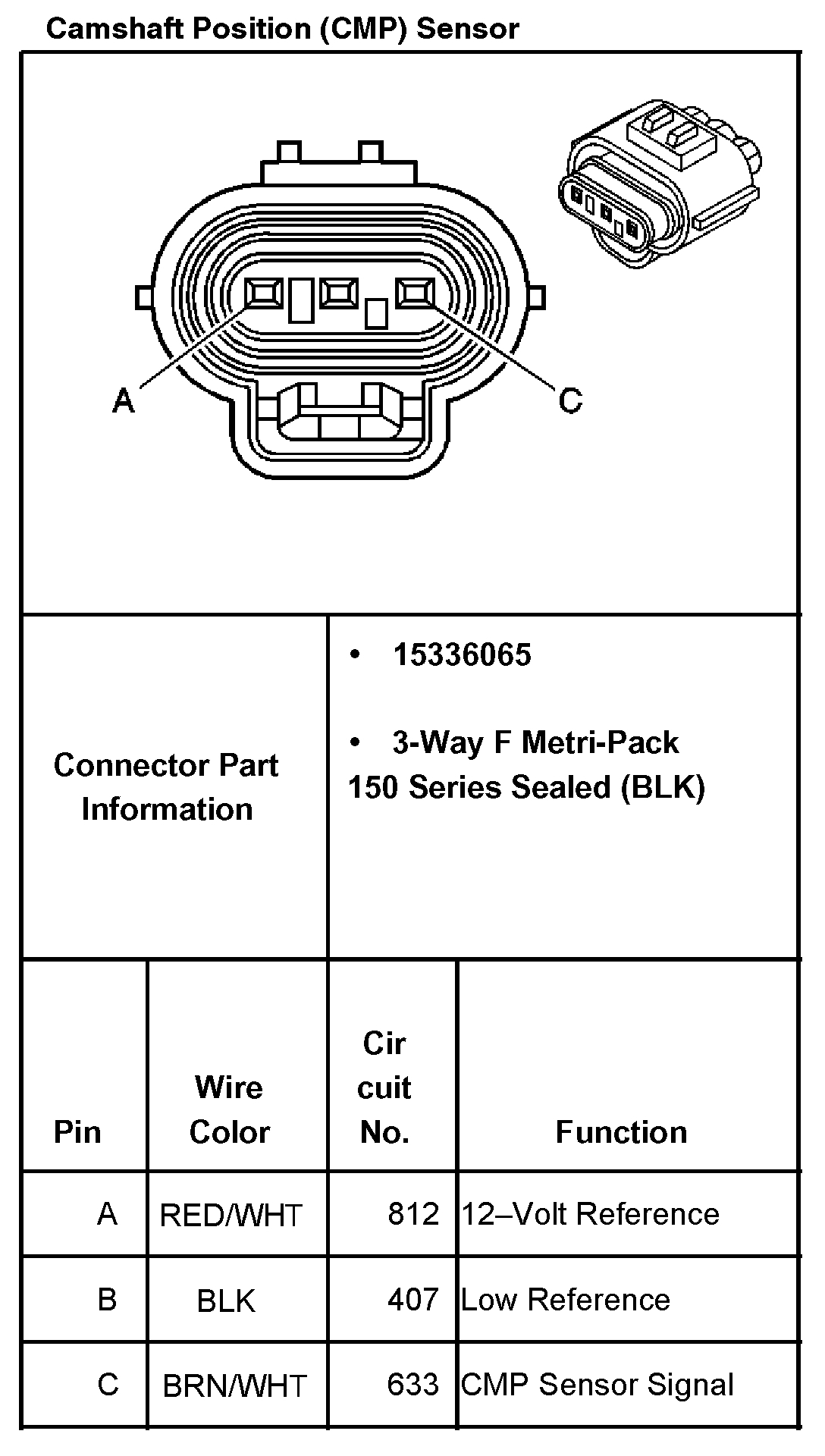

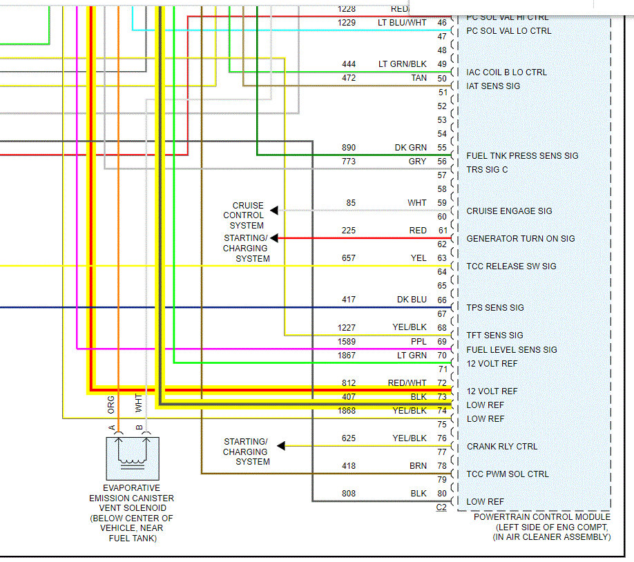

I attached three pics below. Pic 1 shows the cam sensor. Pics 2 and 3 show where the wires from the sensor end. All three go to the PCM.
Is this what you needed?

The sensor is used by the computer for fuel injection timing. As far as a magnet, yes, but I don't see how it would fall off.
If you look at the attached pic, it shows what each wire is used for. Note: Low reference should show continuity to ground. I'm adding them in the event you want to check.
