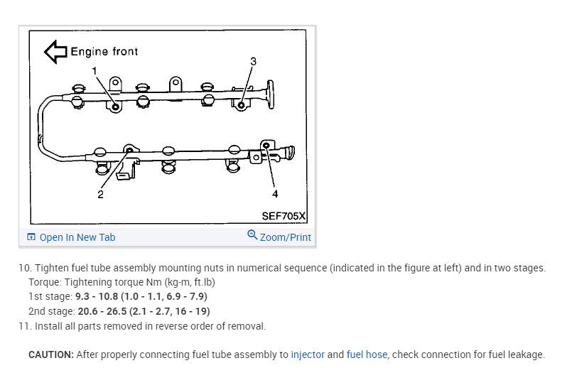

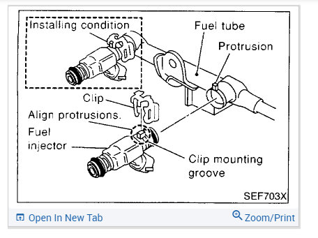

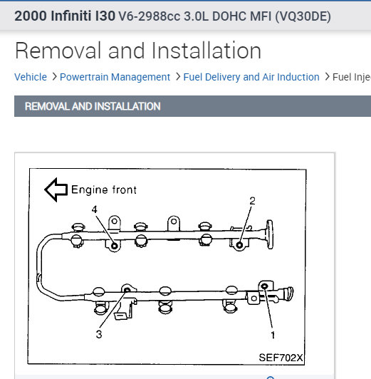

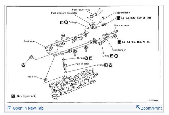

I attached the directions below for replacing an injector on this vehicle. If you have questions, let me know. I hope this helps.
