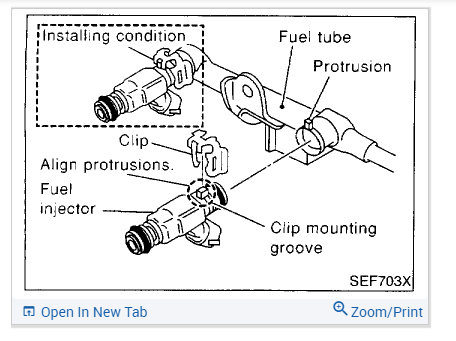

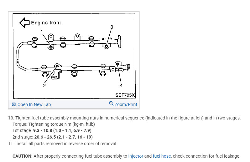

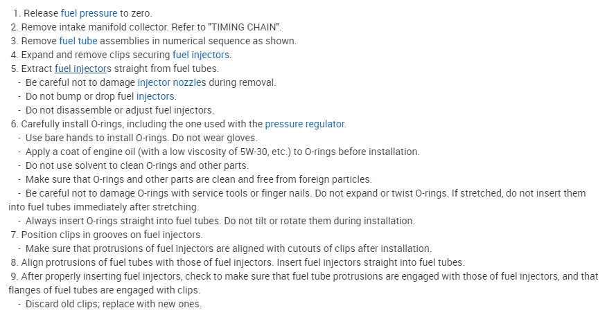

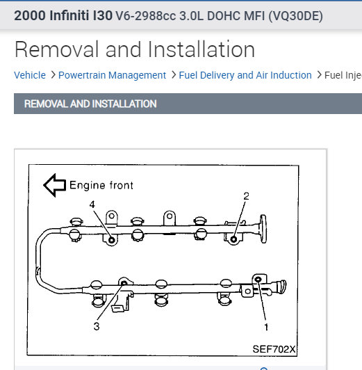

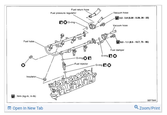

Wow, that isn't good. LOL Regardless, I'm glad you found the issue. I strongly recommend changing the motor oil once the injector is replaced. Chances are there is fuel mixed with it.
I attached the directions below for replacing an injector on this vehicle. If you have questions, let me know. I hope this helps.
