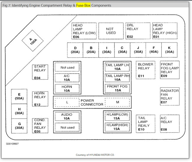

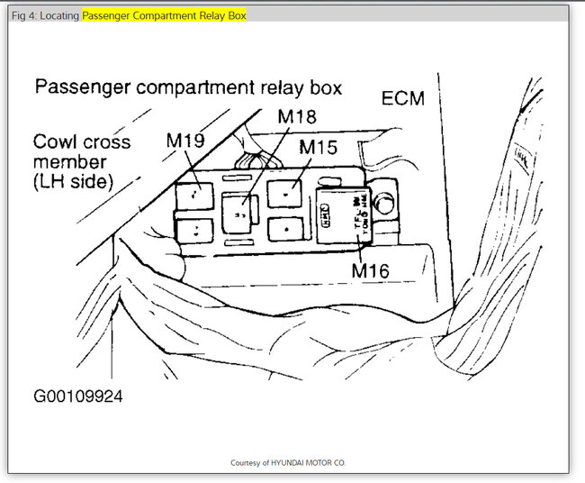

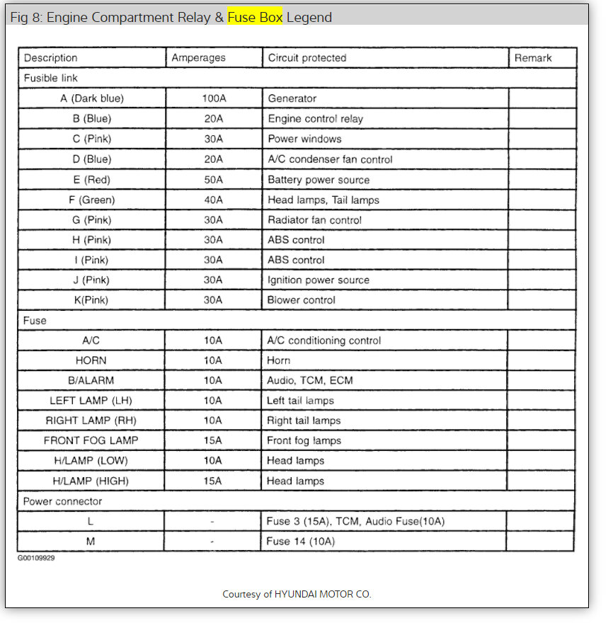

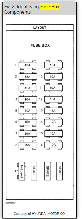

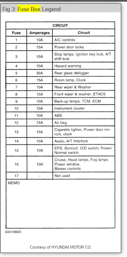

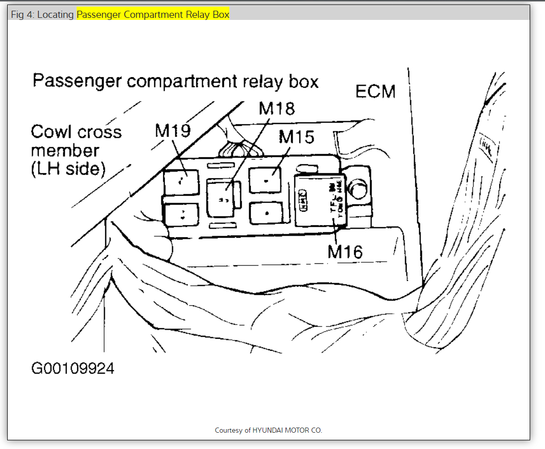

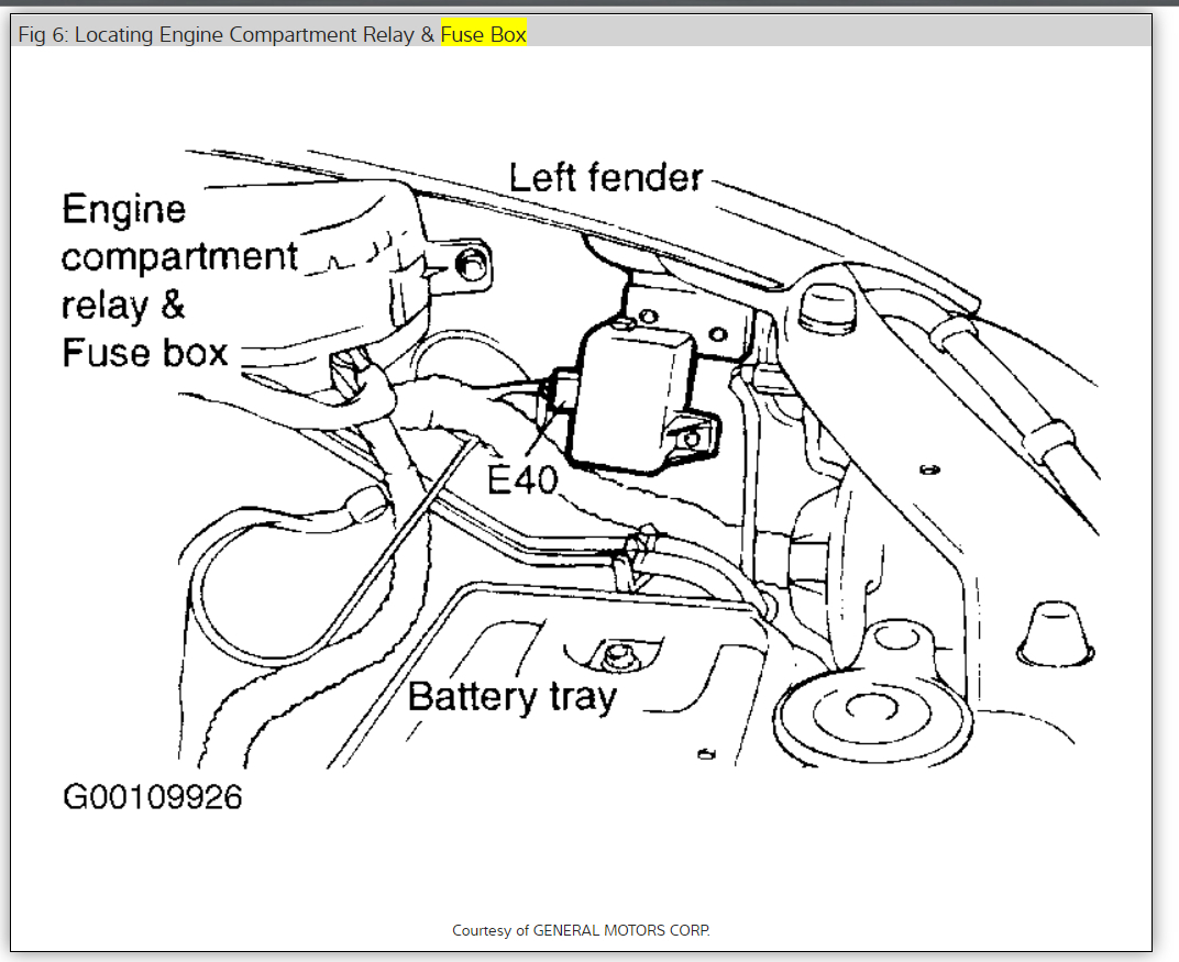

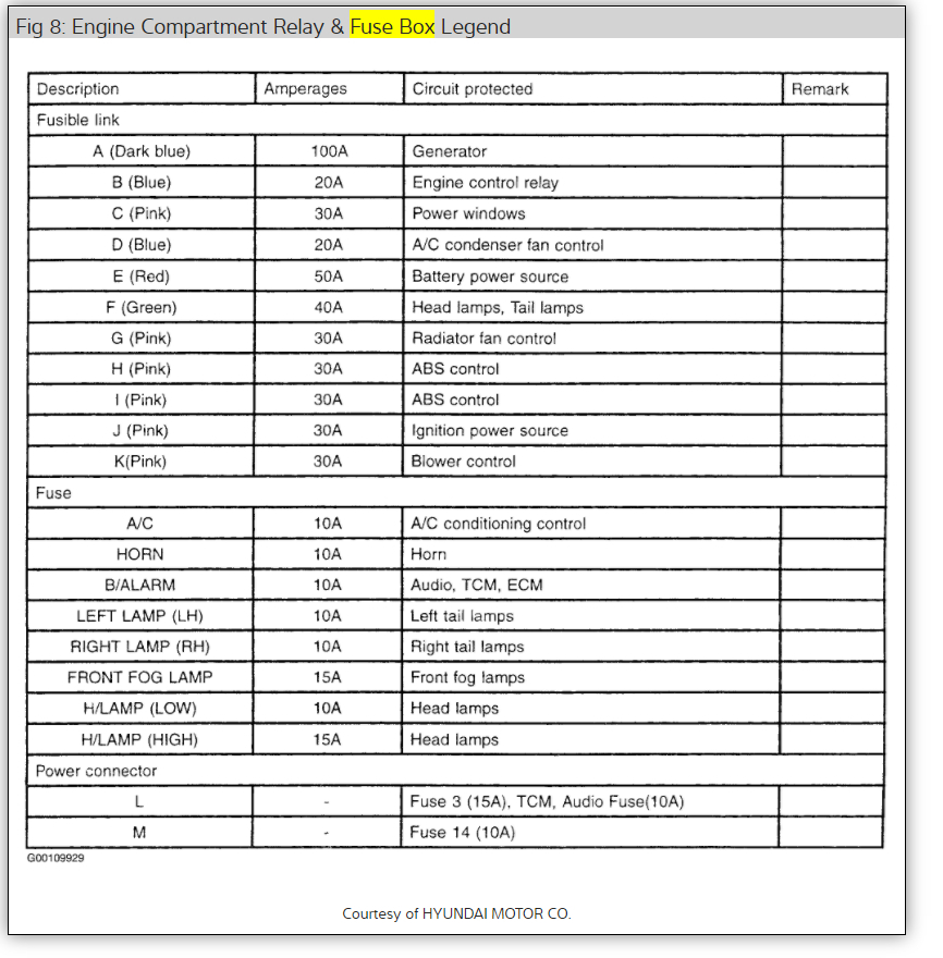

replaced starter now power to coil but no spark.
Mar 12, 2023 at 6:27 PM
Experienced Mechanic
55,709 POSTS
It sounds like it popped a fuse let's check all fuses. here is a guide and I have provided the fuse locations in the diagrams below:
