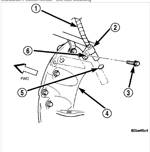

If the engine has no spark, one of the most popular causes for this problem is a bad crankshaft sensor which is located at the transmission bell housing. I would try swapping it out, but I would still like to hear the engine crank over. Check out the images (below). Let us know how it goes.

I've replaced this part already twice.

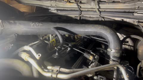

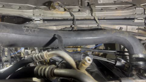

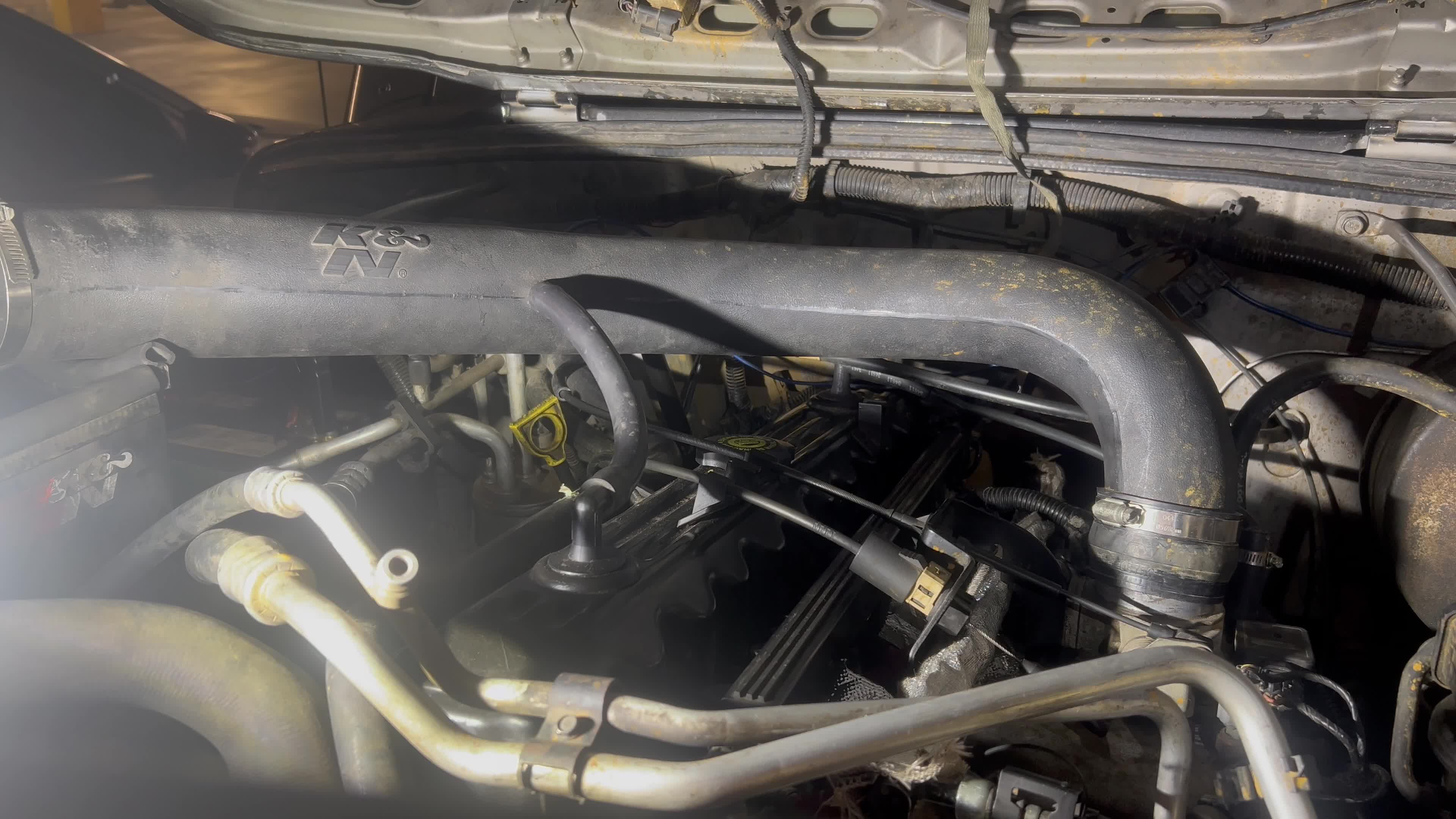

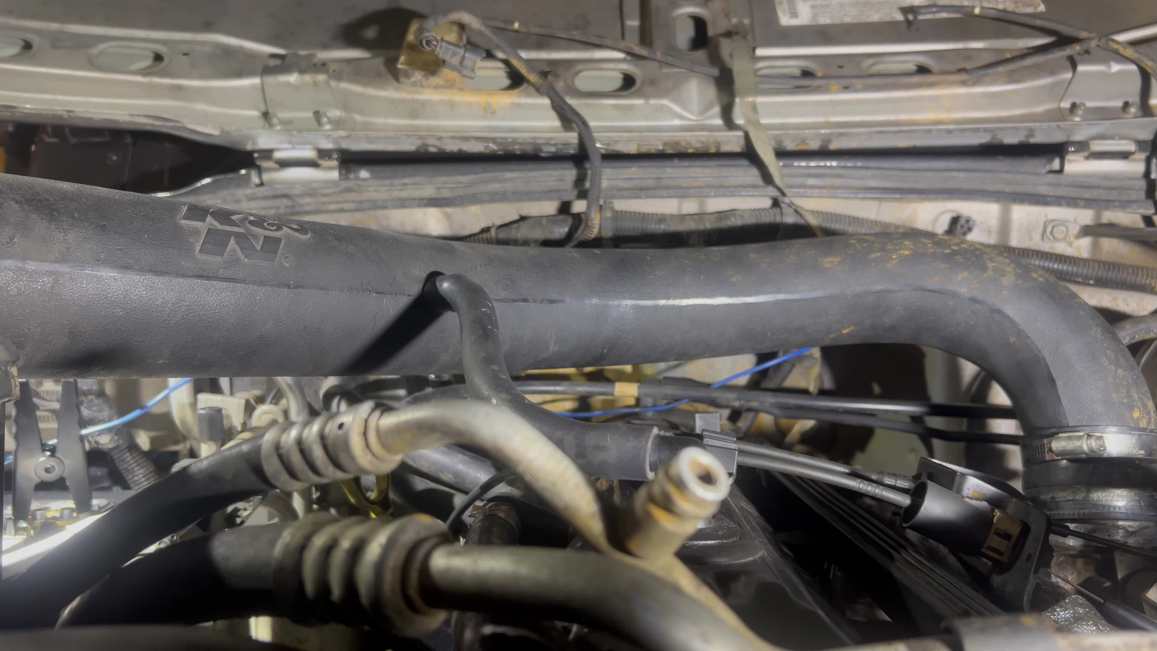

Vid 1

I had battery connected to a battery jumper as well.

Thanks for the videos, they had, the engine does not sounds good like it has jumped time, lets do a compression test which you can rent the gauge set at the auto parts store for free. Here is a guide to help confirm the issue.
Does the engine run when using starting fluid? Please go over these guides and get back to us.
