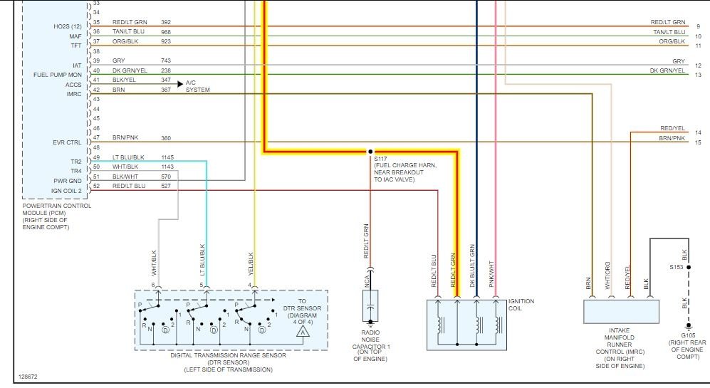

No spark after installing rebuilt engine but have power to new coil with key on but no connection to 3 negatives on coil plug when I crank it over.
Jan 9, 2020 at 10:45 PM
Good morning,
With the key on, you should have power to the positive side of the coil. You should also have power to the negative side as well. If you do not, replace the coil.
This guide can help us
Check out the diagrams (Below). Please let us know what you find. We are interested to see what it is.

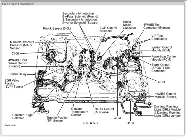

  • 110,248 POSTS
Under the hood is in the relay box is an EEC relay. If bad, it will shut down fuel and spark. Switch it with a known good one with the same part number and see if things change.

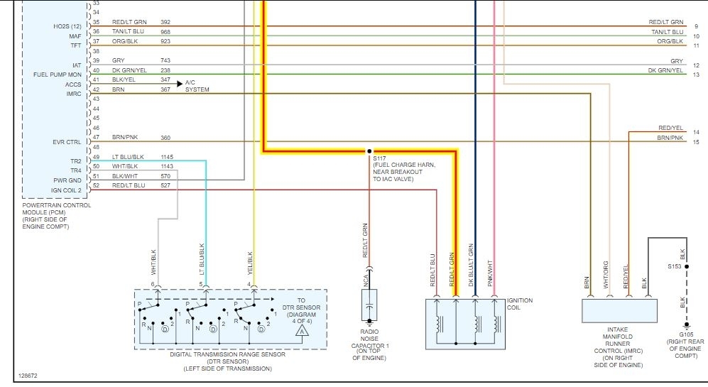

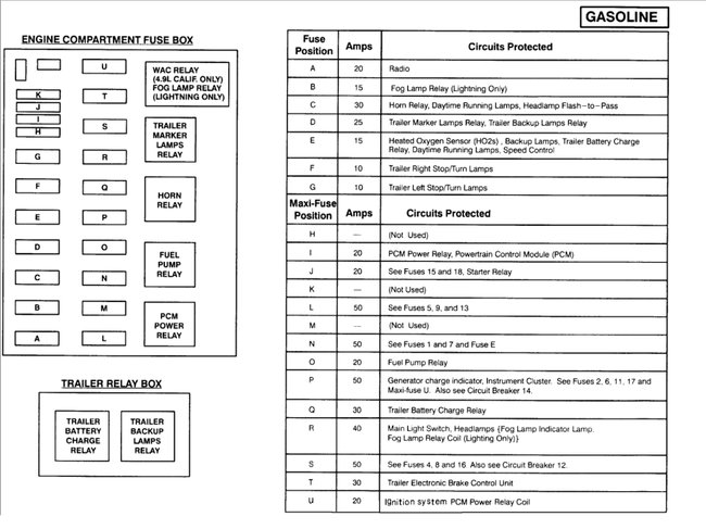

KIVISTO12
Electrical problem
1997 Ford F150 6 cyl Two Wheel Drive Automatic 65 000 miles
We just bought a 97 Ford F150 a few months ago and since it has gotten colder and a bit damper, the truck has started on some days and not on others. most recently it won't start at all. We've checked the relays and replaced them, and put a new coil in, but still no start. any suggestions on what needs to be done?

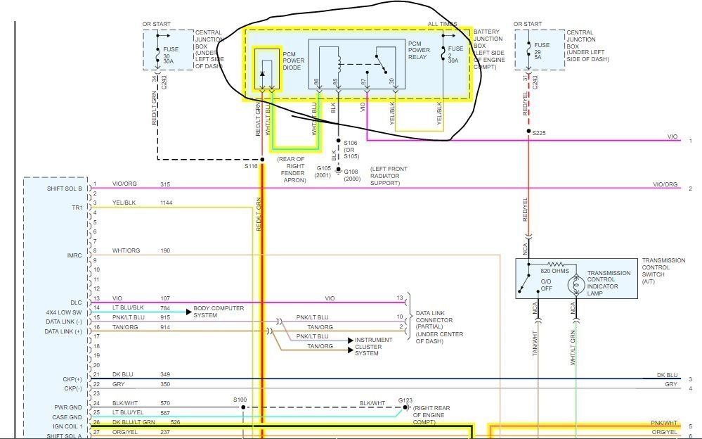

The truck ran when I parked it. i sprayed brake cleaner on driver side valve cover because it was rusty and was going to patch up. After the brake cleaner rinsed off with water hose did not spray at full force just rinse off to clean up. waited for a few days to make sure everything was dry. Did what I had to do the next day did not start. I replaced coil, control module, cap rotor. Sprayed electric cleaner on connectors dryer out with air hose and still nothing. any suggestions?
Oct 14, 2020 at 6:59 AM (Merged)
  • 55,721 POSTS
It sounds like you got the PCM relay wet.
Here is a guide and a diagram of where the relay is. Also, I would check the connector for the ignition module connector for moisture.
Please let us know what you find. I am interested to see what it is.
MATT PETERS
I blew out ignition module connector also replaced module it was tested and was bad. did you mean EEC or ECC not exactly sure everything I looked for was EEC.
  • 55,721 POSTS
Sorry, PCM relay.
MATT PETERS
Dryed out. Nothing yet could the relay be bad
  • 55,721 POSTS
O ya it could be bad here is a test you can use to check and bypass it just to see if the engine starts.
Also remove the connectors from the ECM and see if there is moisture in there as well.
