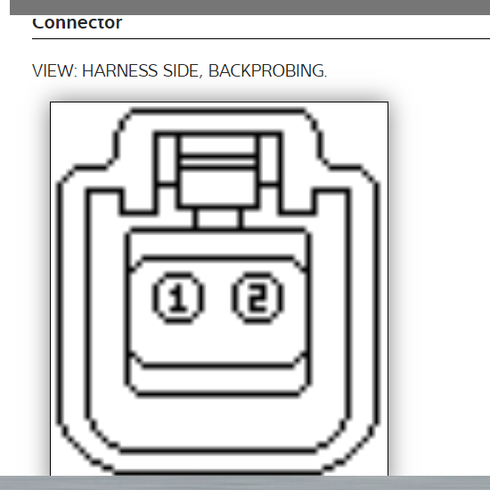

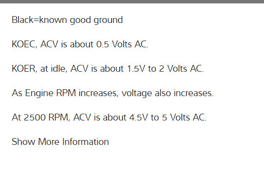

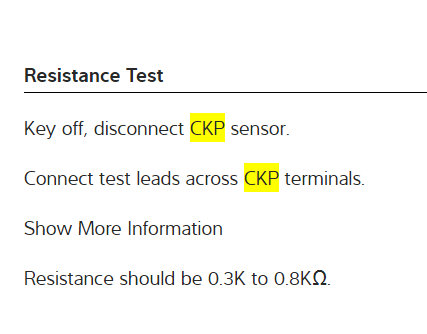

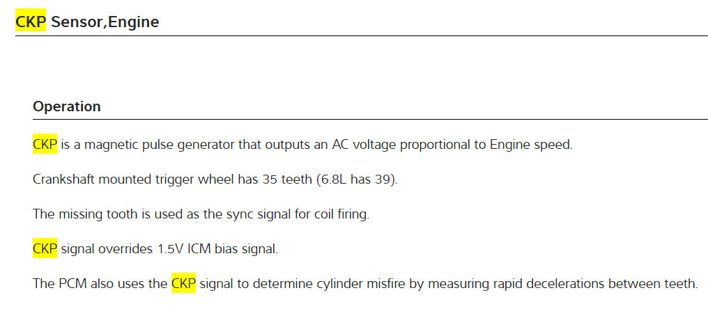

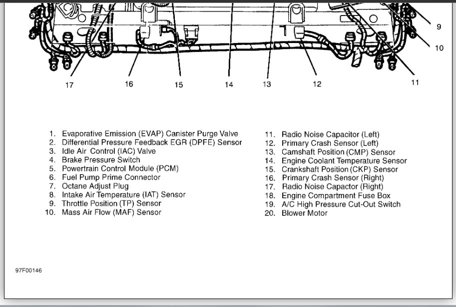

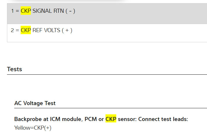

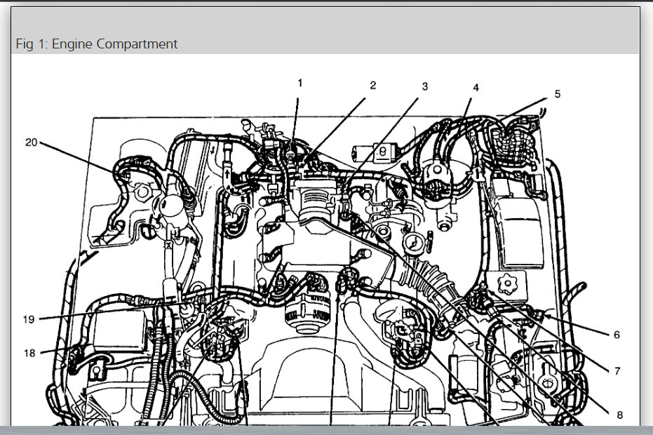

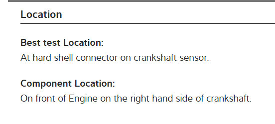

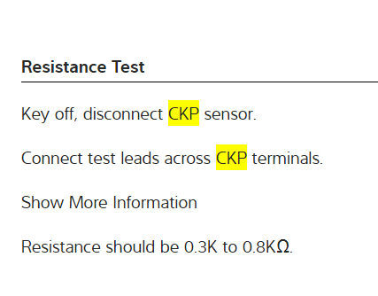

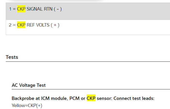

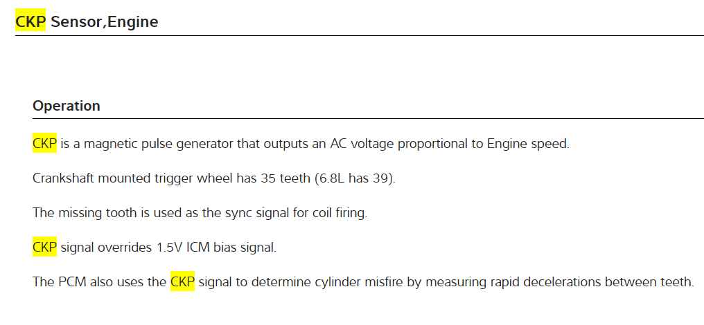

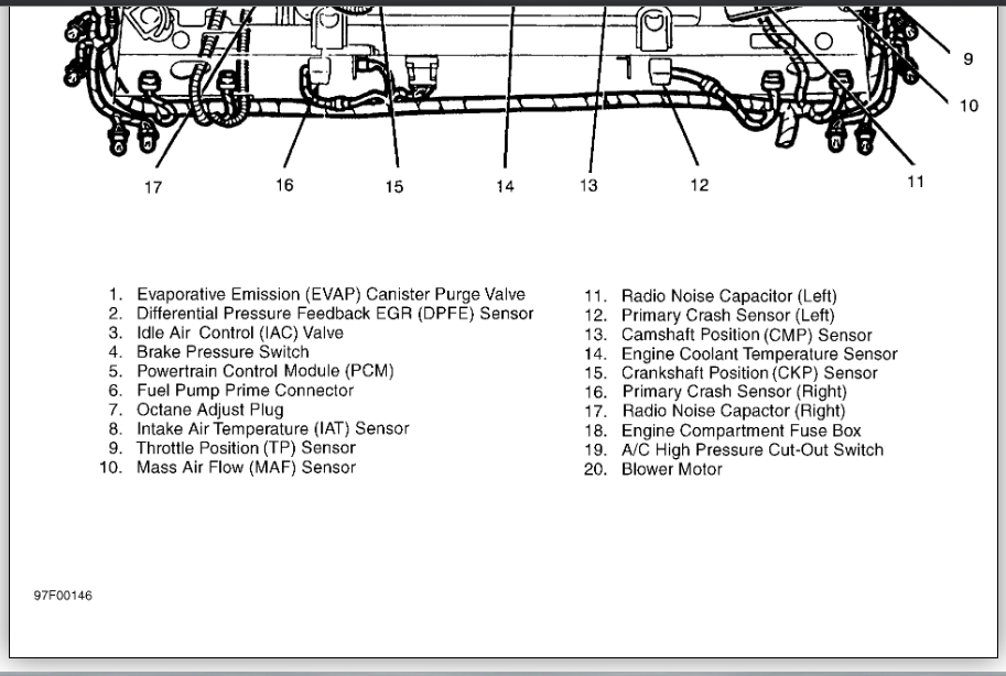

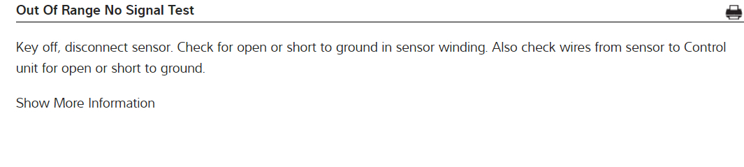

The problem probably is your vehicle's Crankshaft Position Sensor (CKP). Your vehicle's Power-train Control Module (PCM) use the input from this sensor to determine the speed of the crankshaft and for engine RPM's. The engine will not start if the PCM doesn't get this signal from the CKP.
I have included in the diagrams down below a factory troubleshooting guide for your vehicle's CKP. Please go through it and get back to us with what you are able to find out please.

The yellow/black wire at the PCM relay had corroded in too. Repair connection and am back up and running. thank you so very much for the help.
