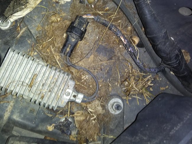

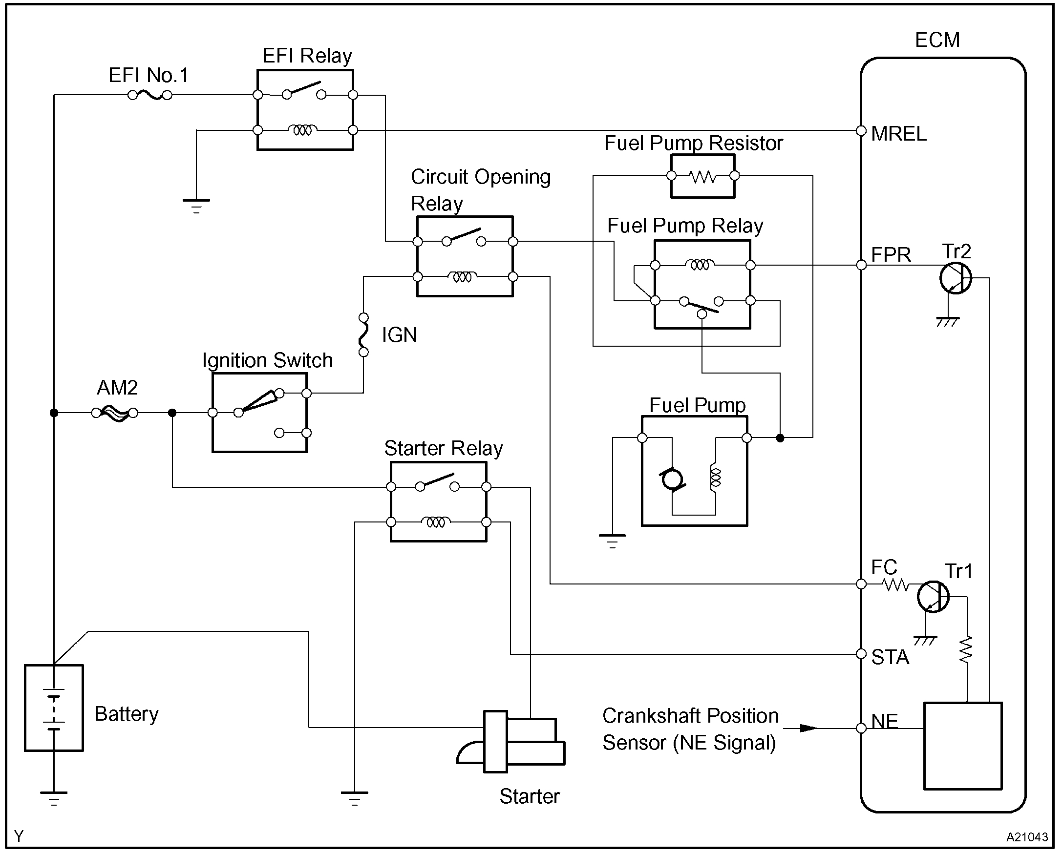

Truck starts but will not stay started. Found A nest on passengers side under hood noticed a wire broken. Is there a way I can take a picture and send?
Oct 20, 2018 at 11:02 AM
SPORK1979
  • 12 POSTS
Here it is:
Oct 20, 2018 at 11:27 AM
  • 110,194 POSTS

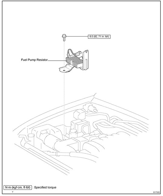

Based on the picture, that is a fuel pump resister. I attached a picture below (picture 1). This component is bypassed on startup which will allow power to the pump and the vehicle to start. When the key returns back to the run position, power goes through the resister to the pump. If the resister wiring is bad, it will start, but stall a very short time after.
The second picture I attached is a schematic of the fuel system.

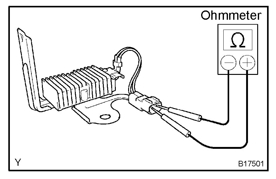

The wiring needs repaired. If you feel the resister has been damaged, here are the directions for testing. See picture 3.
INSPECTION
1. REMOVE FUEL PUMP RESISTOR
2. INSPECT FUEL PUMP RESISTOR
Using an ohmmeter, measure the resistance between the terminals.
Resistance: 0.70 to 0.76 Ohm at 20 °C (68 °F)
If the resistance is not as specified, replace the resistor.
3. REINSTALL FUEL PUMP RESISTOR
Torque: 8.0 Nm (82 kgf.cm,71 in-lbf)

Oct 20, 2018 at 5:59 PM

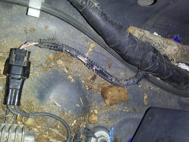

The fuel pump resister connects inside other wiring. How do I go about replacing and reconnecting?
Oct 21, 2018 at 8:38 AM
SPORK1979
  • 12 POSTS
The bundle of wires is what it connects to.
Oct 21, 2018 at 8:41 AM
SPORK1979
  • 12 POSTS
I am fairly sure it is just the connector wires that connect from the resister to that bundle of wires. Can I just change the connector wire?
Oct 21, 2018 at 8:46 AM
  • 110,194 POSTS
Hi again. Yes, just make the necessary repairs and it should be fine. If this does not remedy the problem, let me know. But, I feel confident that is what is causing the issue.

  • 110,194 POSTS
As far as finding that portion of the wiring harness, chances are you will not. And I am not sure what you mean by resistors. What I suggest is to simply cut out the damaged part of the wiring and using butt connectors, replace it with new wire.
Make sure to disconnect the battery negative cable before you start working on the wires.
As far as the bracket, it should be there to protect the component from bouncing or banging on things as you drive. You can use something like zip ties to hold it in place if needed.
Oct 22, 2018 at 4:54 PM

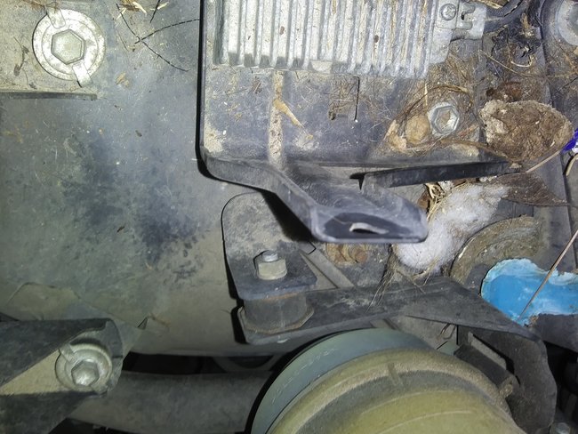

SPORK1979
  • 12 POSTS
This picture is the back piece. It has a hole but no screw. Does it need to be on the replacement?

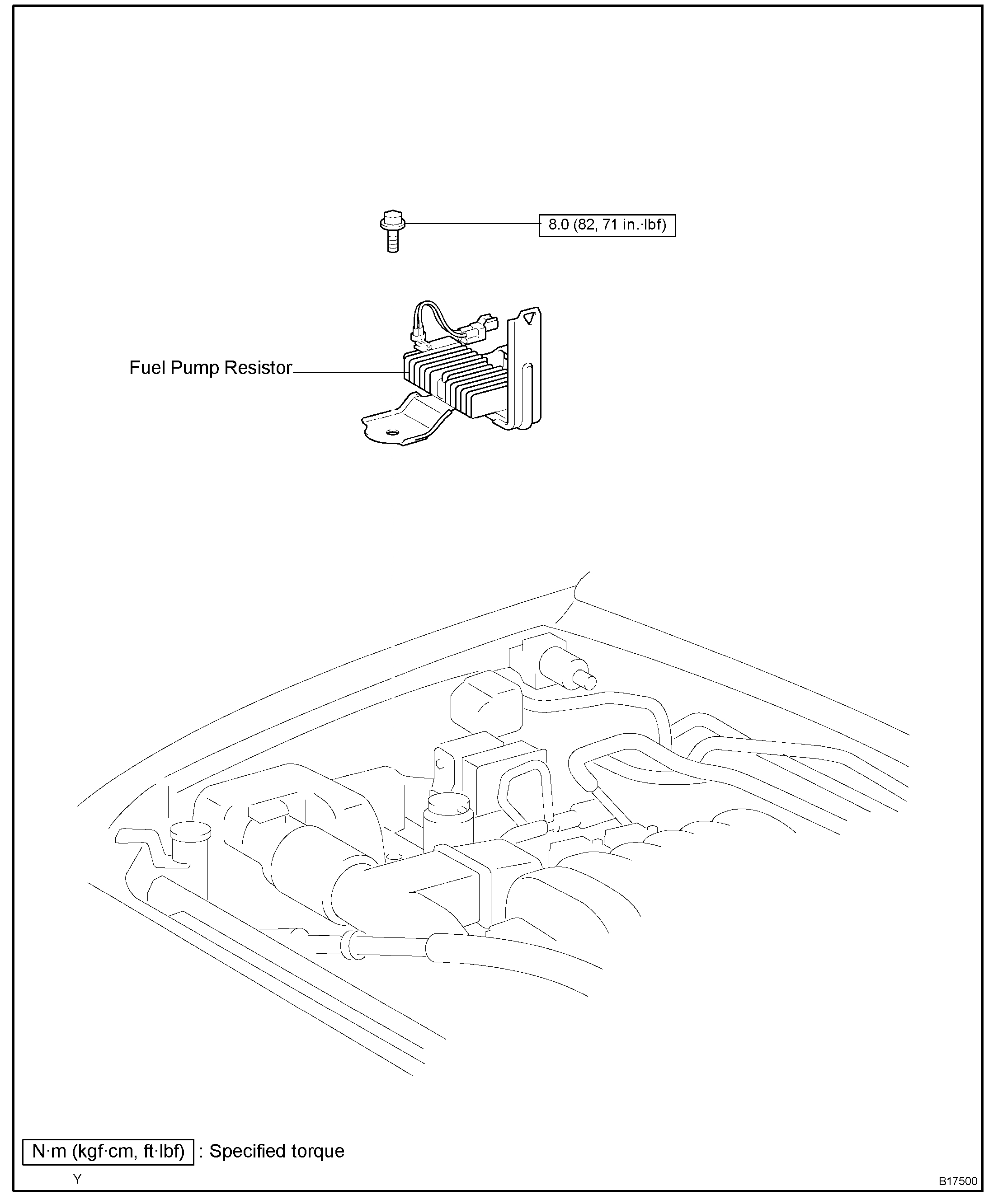

SPORK1979
  • 12 POSTS
This is the piece where the connector is. How do I disconnect it?
Oct 22, 2018 at 5:34 PM
  • 110,194 POSTS
On the opposite side of the component, there is a release on the connector. In the picture it is facing up (right side of the connector). Press that and wiggle the plug apart.
