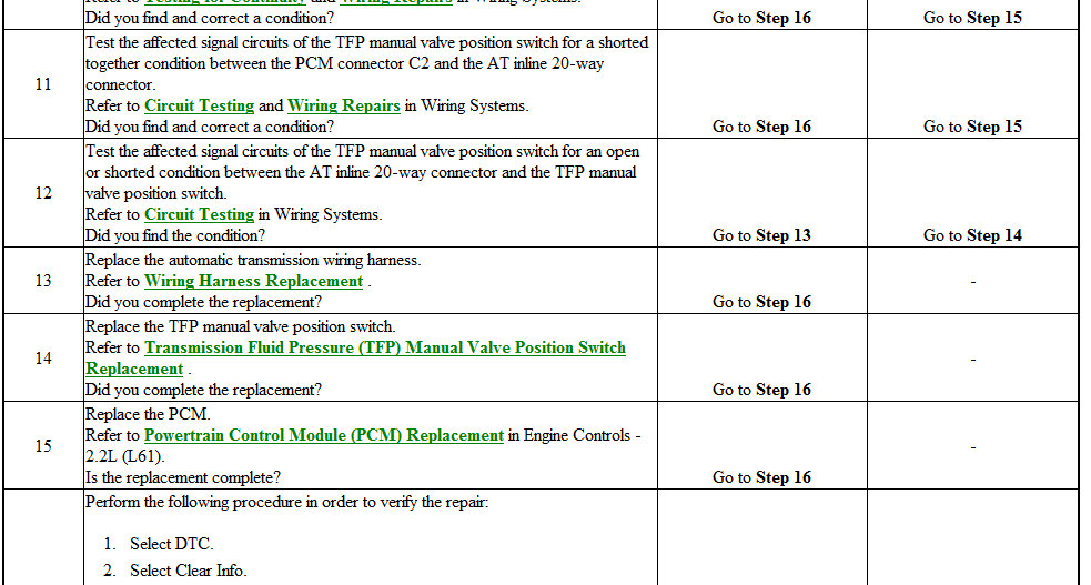

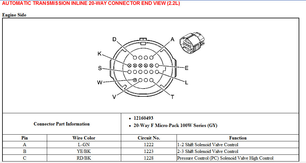

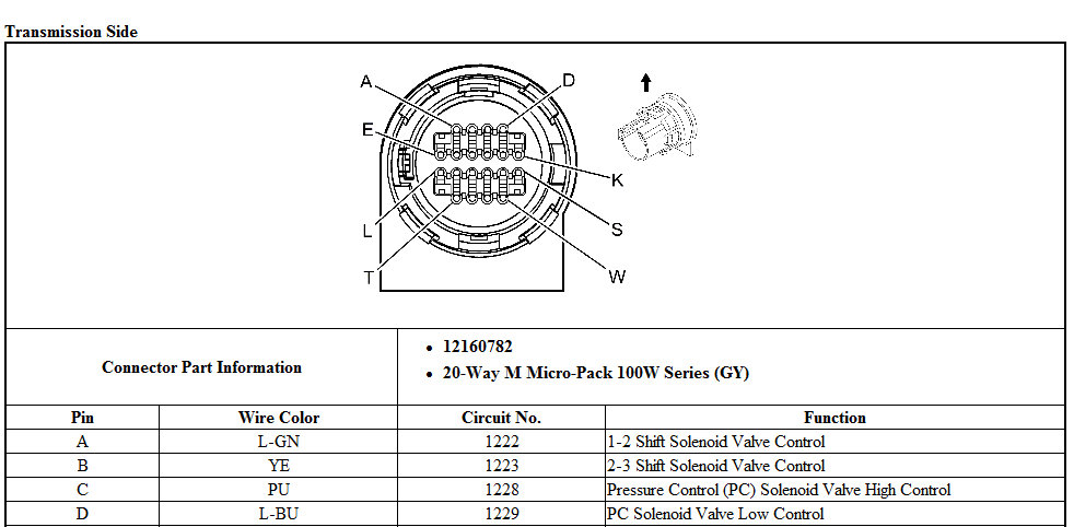

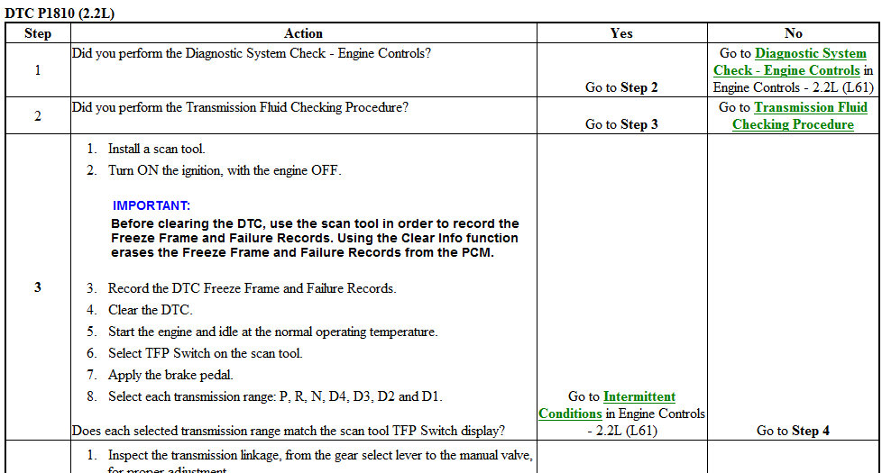

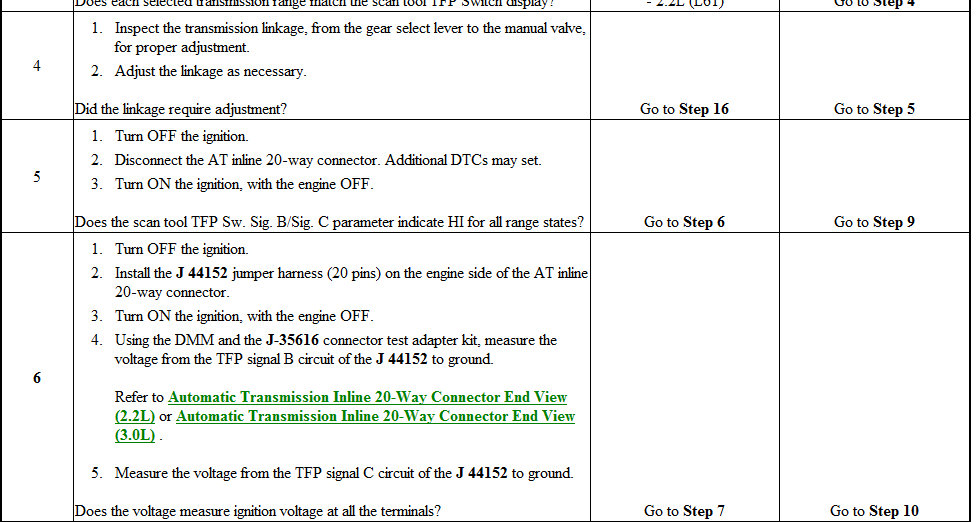

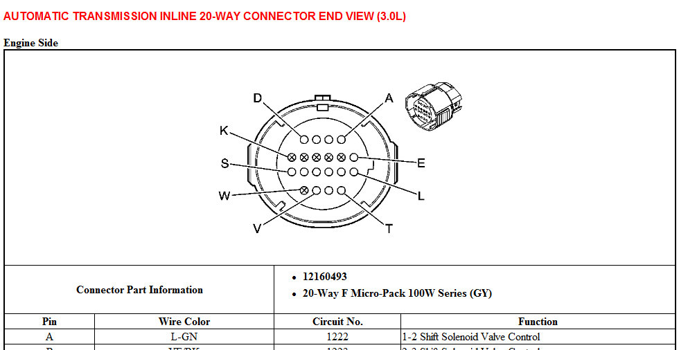

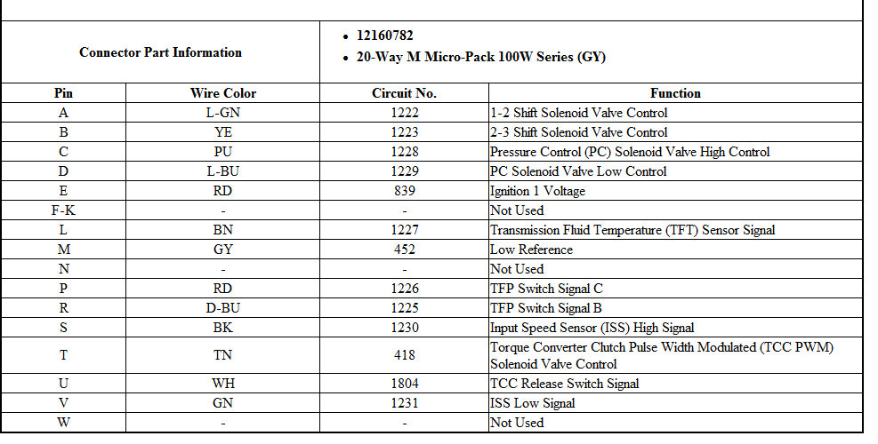

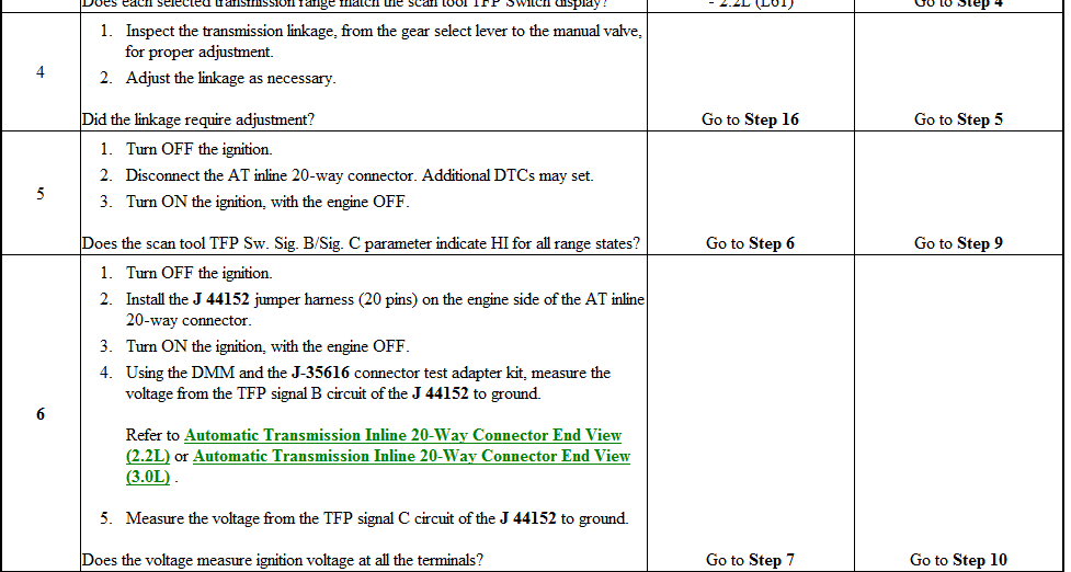

My car cranks but wont start. Code p1810 is what code i got on scanner.
Jan 18, 2021 at 12:33 PM
SEVAG P
Experienced Mechanic
405 POSTS

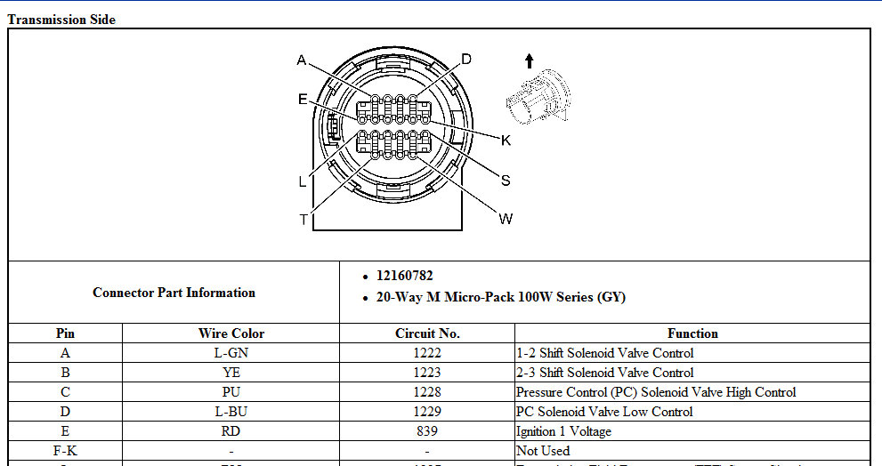

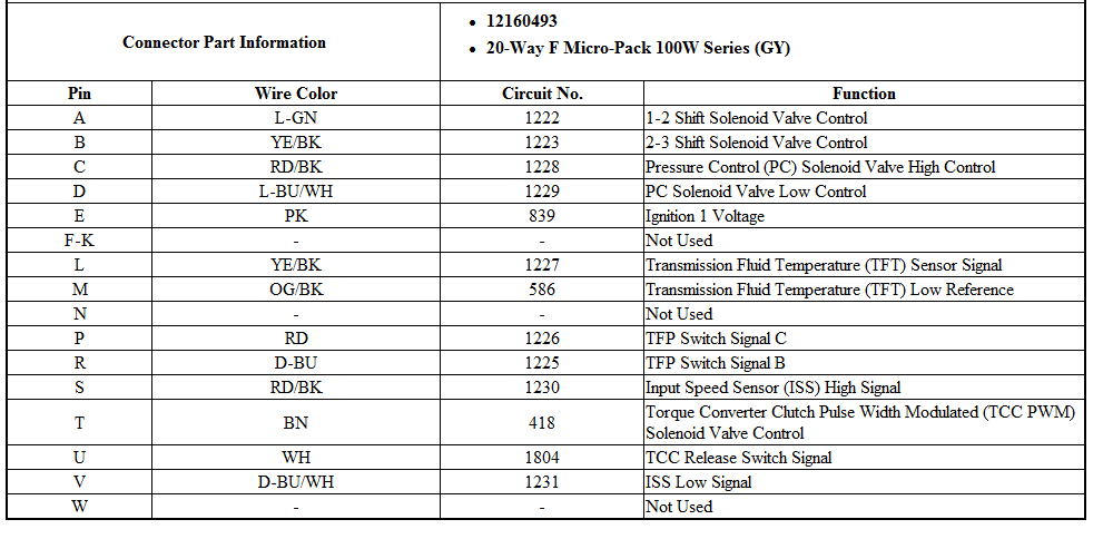

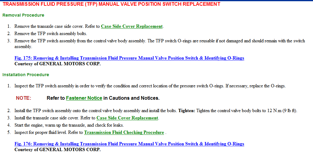

Engine does not start is not related to fault code p1810,this fault is related to transmission fluid pressure switch.
Check our guides below for engine does not start:
https://www.2carpros.com/articles/how-to-test-a-fuel-injector

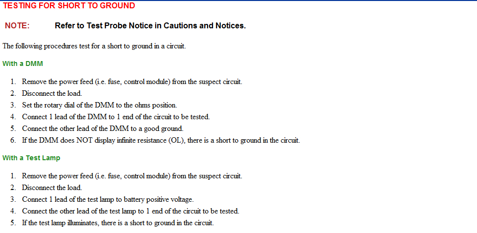

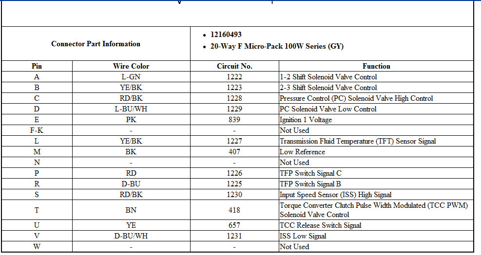

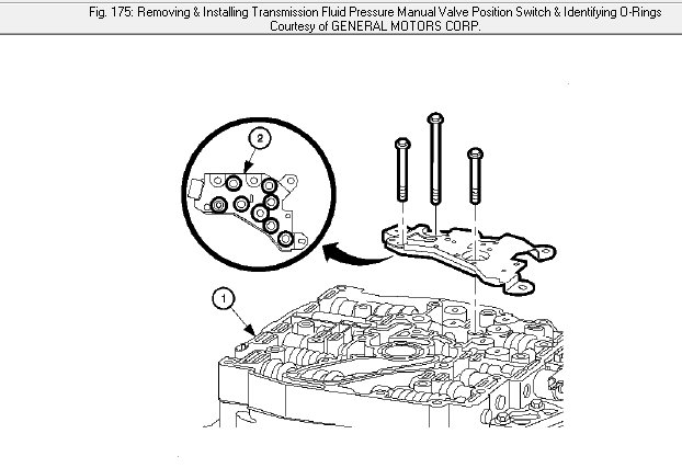

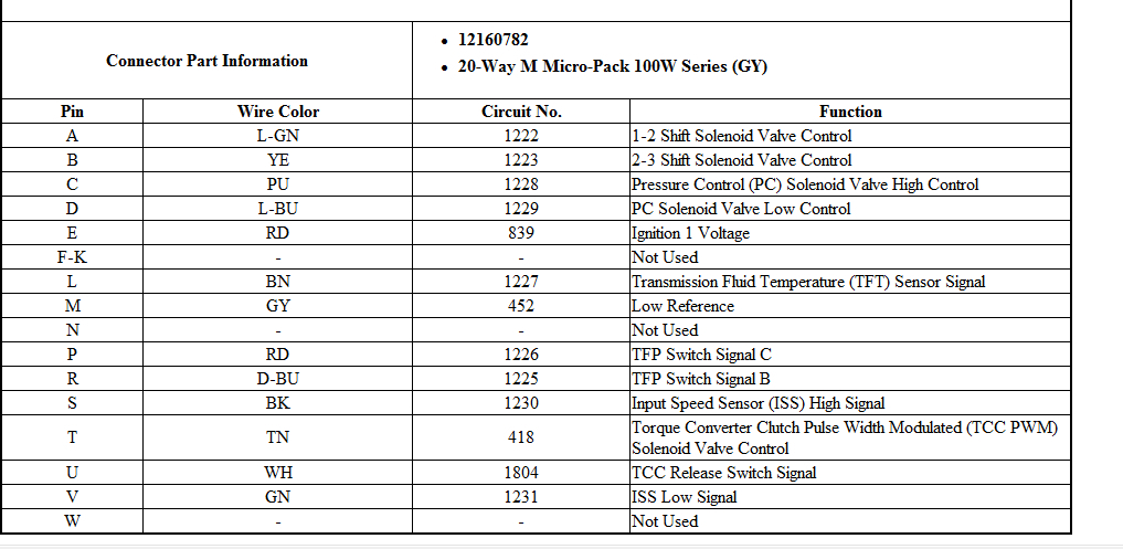

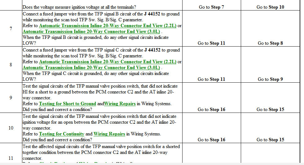

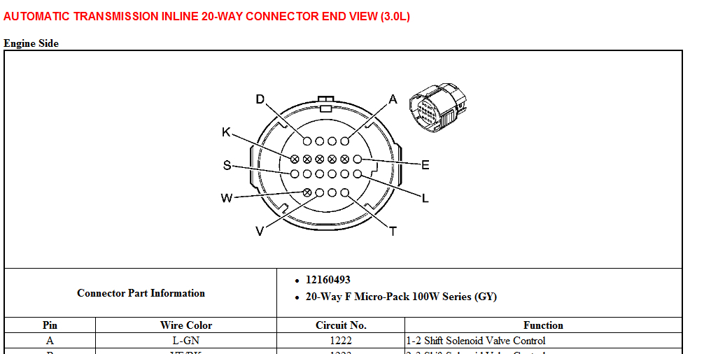

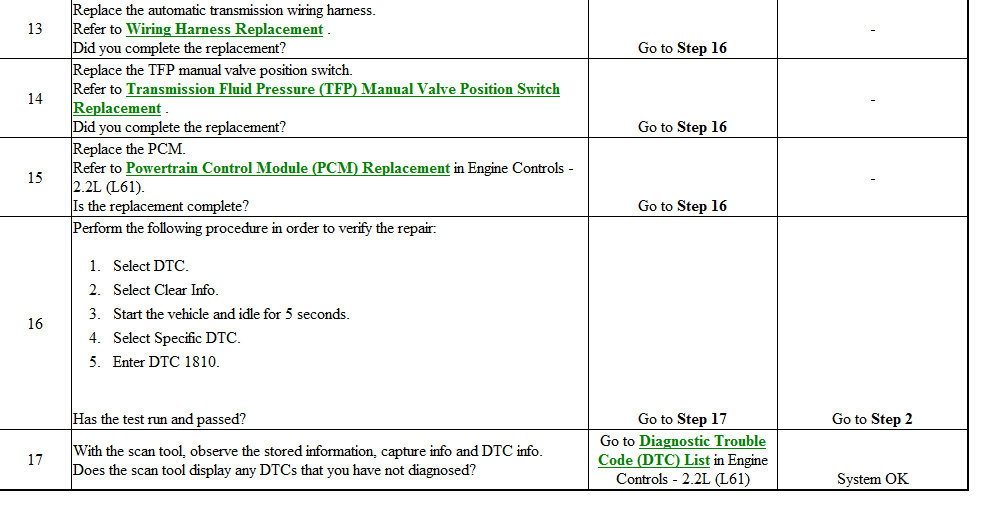

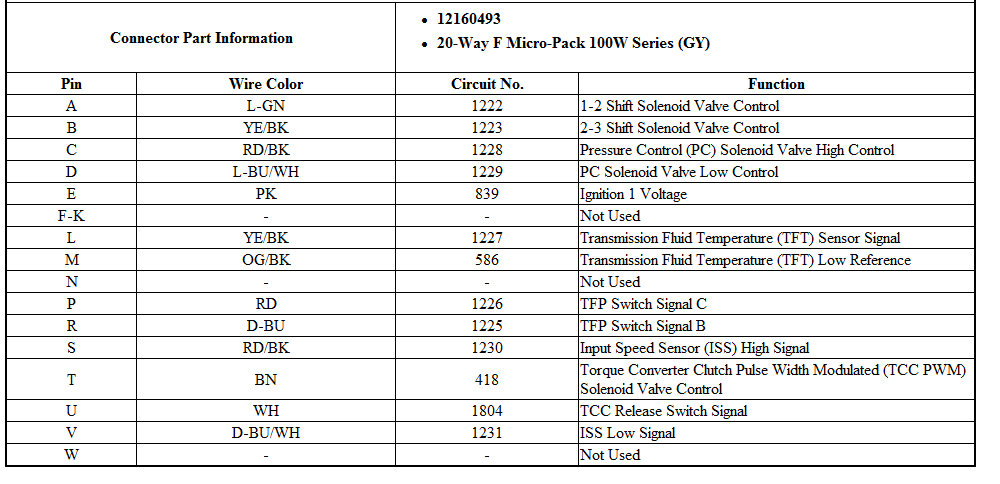

For the fault code p1810 check the figures below for diagnostic procedure and diagrams.
before any troubleshooting check transmission fluid level.
hope these help, let us know what happens with you.
Images (Click to enlarge)
