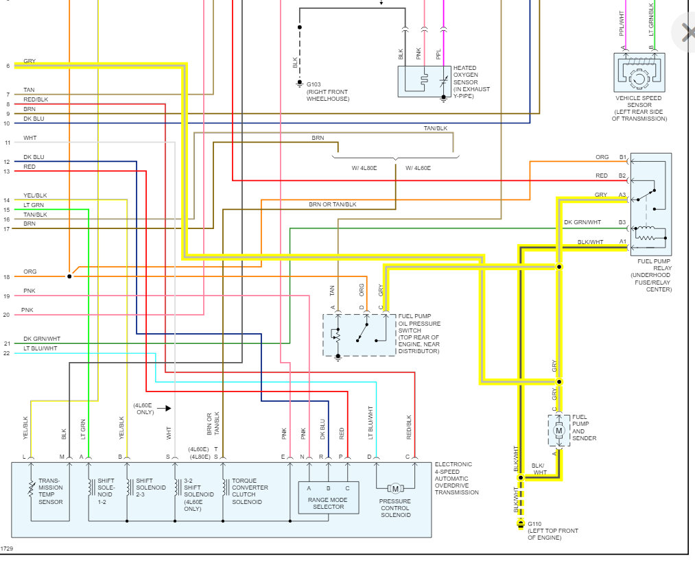

When I turn the key, I hear the fuel pump turn on. I checked for fuel and there isn’t any. I ran a Noid light test on both injector connectors and there was nothing, the light didn’t come on.
Interestingly though is that when I went out to the vehicle and removed the intake cover etc. and had a friend turn on the ignition it fired right up. I put the cover on again and the vehicle fired up three more times after running fine for about ten minutes each time. But when I went to start it again it is back to how it was cranking but not starting. I didn’t move the vehicle when starting and turning off.

That code 54 - EGR system failure or fuel pump circuit low voltage.
So could be a wiring issue with the fuel pump, corrosion can prevent it from getting full voltage.

You will need to check the voltage to the fuel pump. It should be at 12V.
Here is a helpful guide on how to test wirings:
I have attached the fuel pump wiring schematics below for your reference.
