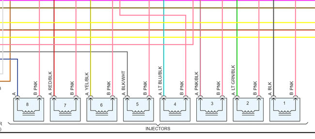

Try something for me. See if it starts for a couple of seconds using starting fluid. If it does and then stalls, it isn't getting the fuel.

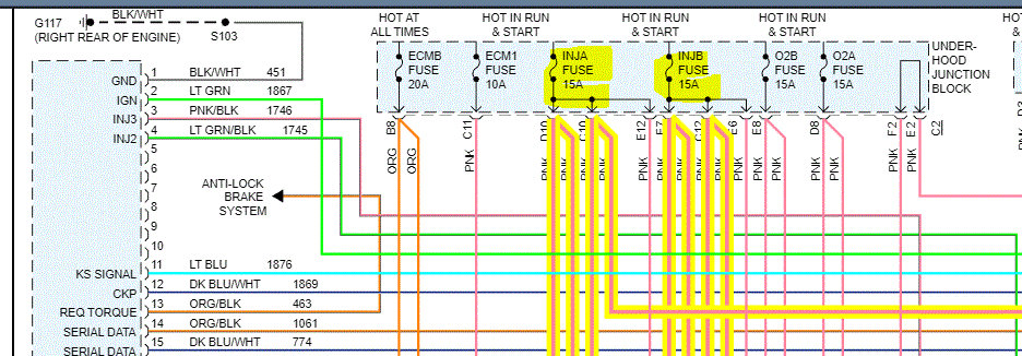

Keep in mind that you have good pressure and spark, so it should run. If it doesn't, we need to check for power at the fuel injectors. At each injector, there will be two wires. Each injector will have a pink wire that should have 12v with the key on or in the start position. I need you to confirm power is present.
Note, four of the injectors get power from injA fuse and four get it from injB fuses in the under-hood fuse box. Both fuses are 15 amp. If you don't have power at the injector pink wire, check those fuses.
I attached a couple of pictures below you may find helpful. If it starts for a couple of seconds using starting fluid, I suspect one or both of these fuses have failed.
Let me know what you find or if you have questions.

Thank you for the quick response! Gave the starting fluid a shot. It blew a flame out of the intake. I checked each injector with the key on and every injector reads 12v. All the fuses are good.
