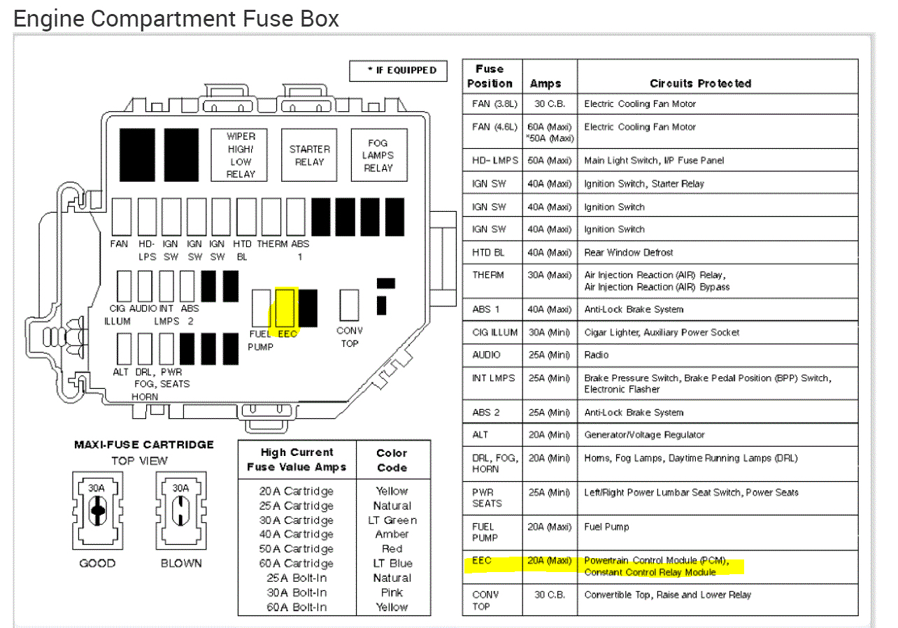

One day my car just stopped running. Nothing was wrong before, and all of a sudden when I turned the key the theft light would blink a theft code of 1:6 , fuel pump not coming on and all fuses are good. I tried to hook up a reg scan tool but it says cannot communicate with vehicle, so I tried to use a Ford an device which came back with "unable to communicate with PCM". How do I have my PCM checked, or what wires should I check? I'm at a loss of what to do next because it seems like I've tried everything.

First, did you try a different key? Also, since you aren't getting communication with the PCM and the anti-theft light is on, I need you to check the EEC fuse in the under-hood fuse box.
See pic 1 below for fuse location. Note: When you check this fuse, also confirm there is power to and from it.

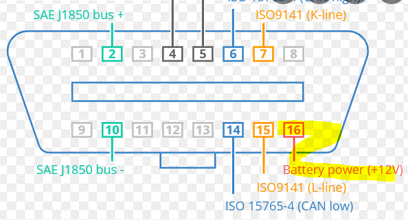

Let me know what you find. Also, if that fuse is good, confirm there is power to pin 16 at the data link connector. See pic 2.
Let me know what you find. Also, please confirm the engine size for me. The 5.8L wasn't offered this model year. If it's a v8, it should be a 4.6L.
