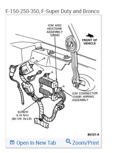

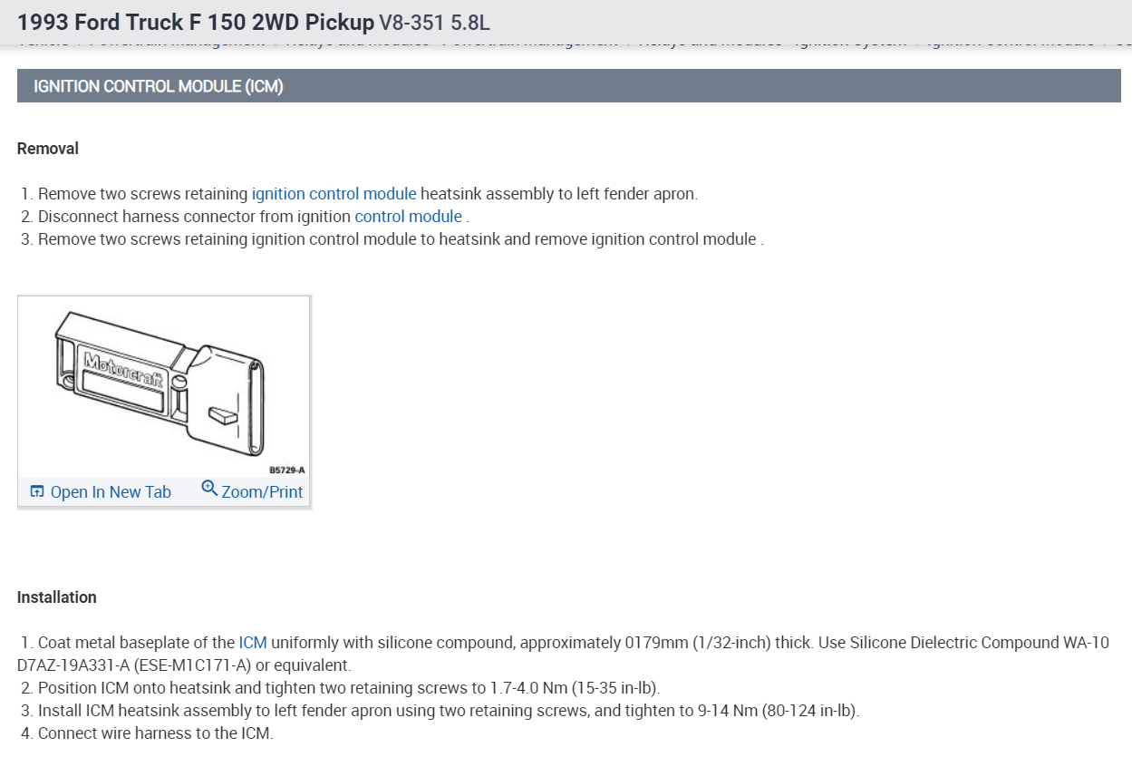

If it won't start with starting fluid and the engine sounds normal when you are cranking it over, you have lost spark. I have seen the ignition module go out on these trucks causing the problem you have described.
