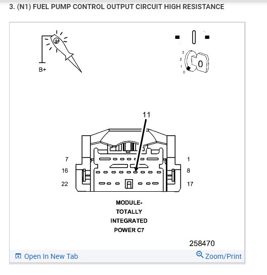

I was running errands and it was running fine. I parked it, did what I needed to do then when I came out and it would not start. Got it towed home found the fuel pump was faulty got it changed and it still won't start. I have already changed the crank position sensor had a recent oil change and tune up. Fuel pump works and the fuses look fine. Recent alternator and battery as well. The only code is P127F.

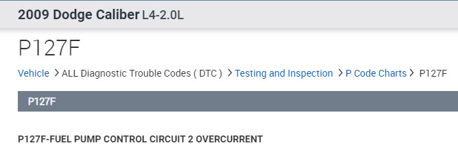

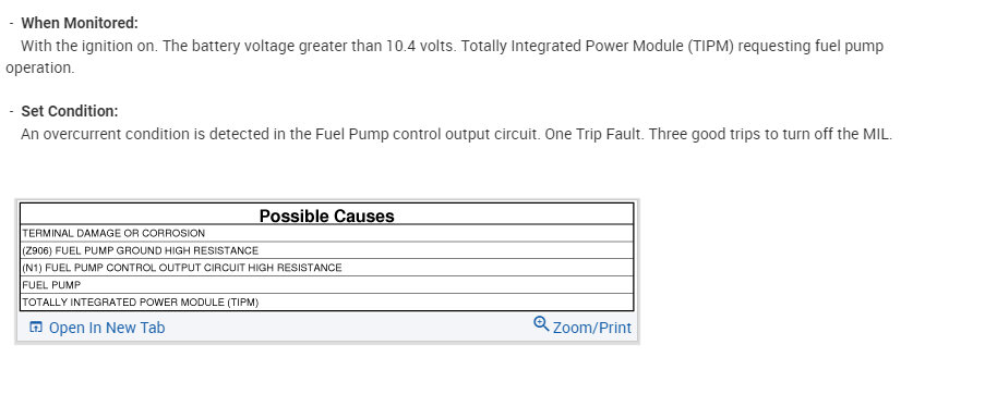

The code you provided is related to an electrical issue and not the pump itself.

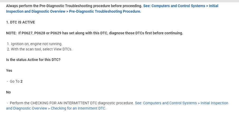

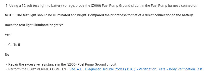

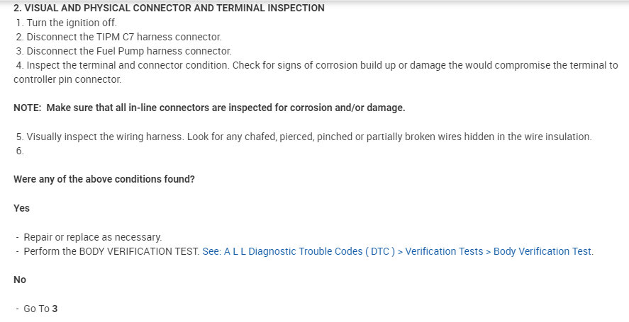

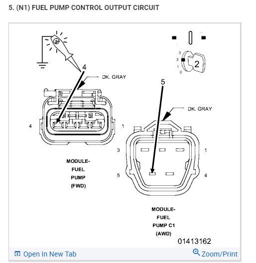

If you look at the attachments below, they provide the diagnostics specific to this code. Take a look and let me know if this is something you feel comfortable performing.

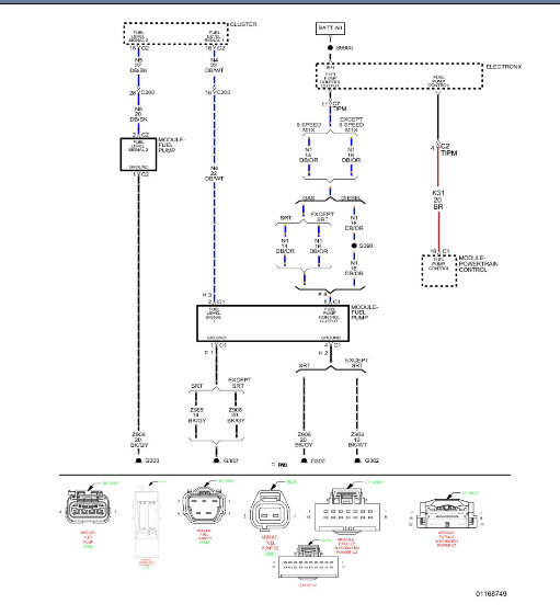

I found intermittent power to the pump and no fuel to the rail. It'll run on ether. Unfortunately, I feel it's the internal fuel pump relay....

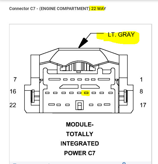

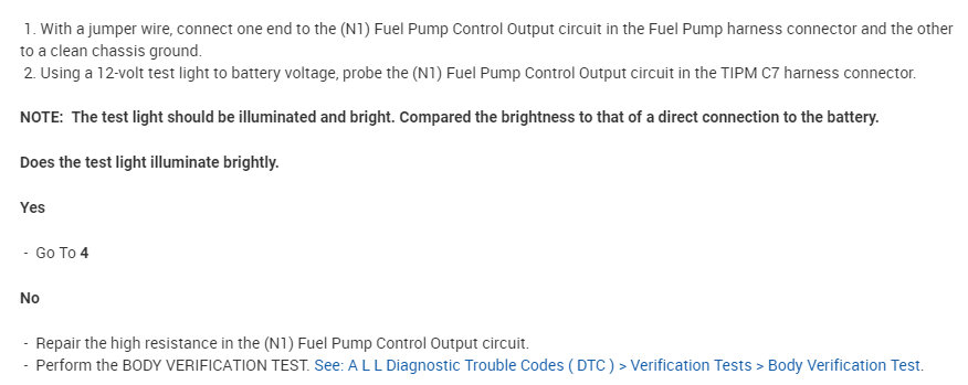

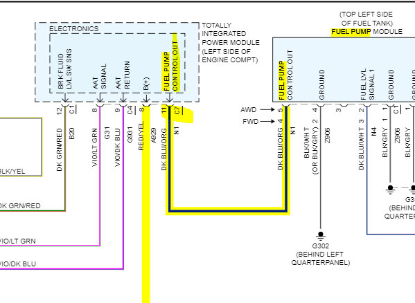

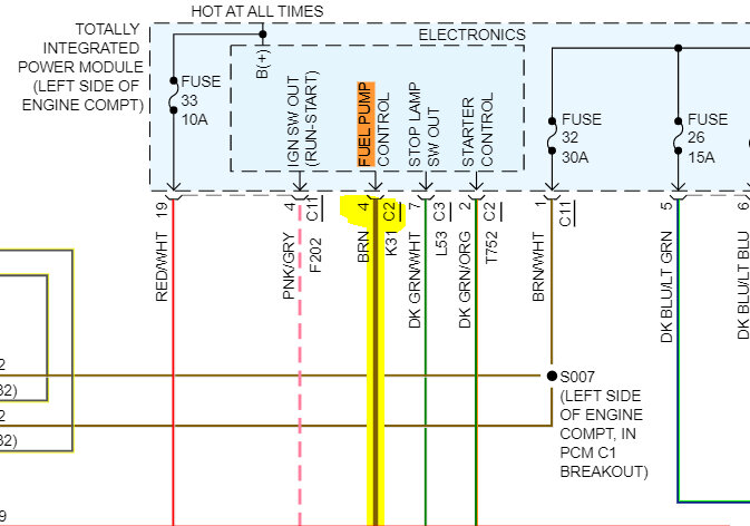

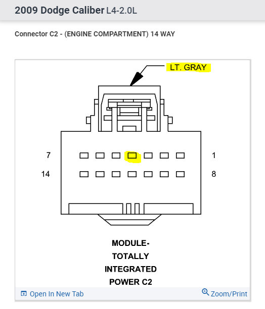

I suspect that is where there is an issue. There are two connectors, C2 and C7. See pics 1 and 2 below.
Now comes the fun part. LOL Disconnect the battery before you do this. There are eleven connectors on the TIPM. To add insult to injury, both of the connectors you need to find are light gray. One is a 14-pin connector, and one has 22 pins.

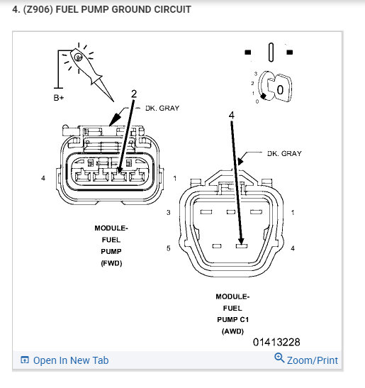

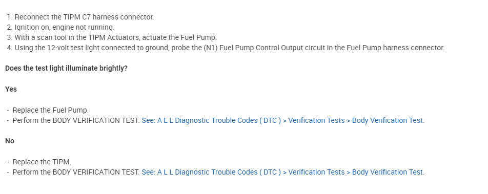

If you look at pics 3 and 4, they show the connectors. I highlighted the pins to check. Note that the connector is the female end, and On the TIPM side, is the male connector. Check both but check the pins really closely for corrosion and make sure the pin isn't broken.
Let me know what you find.
