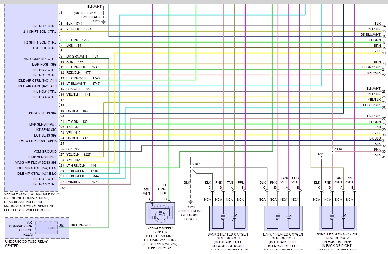

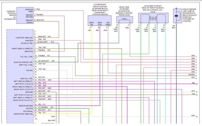

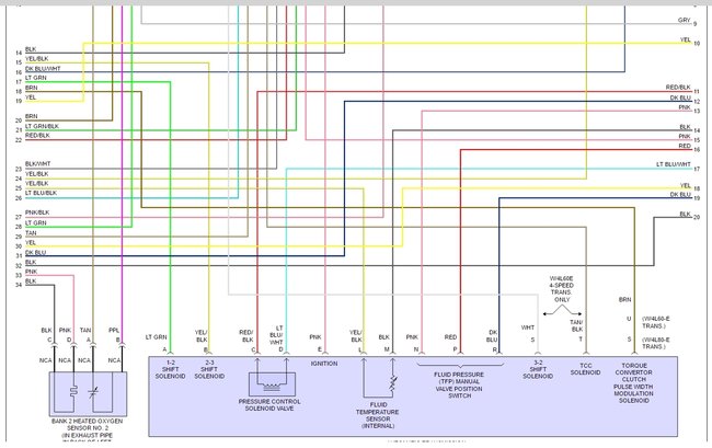

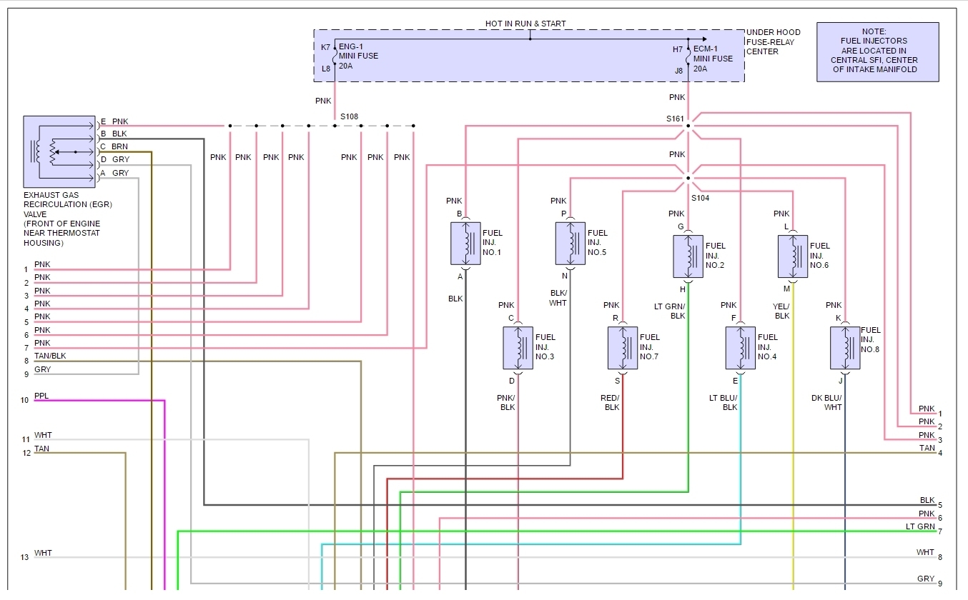

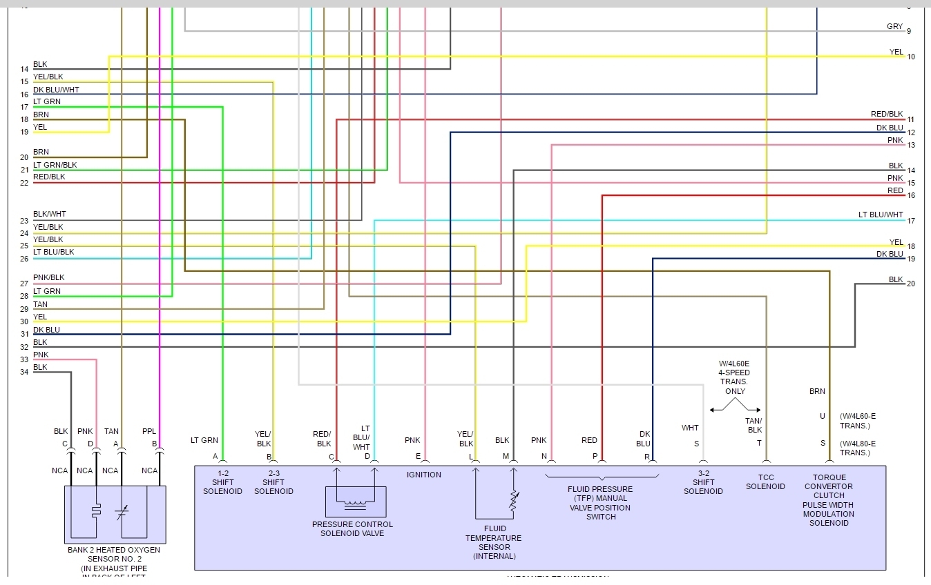

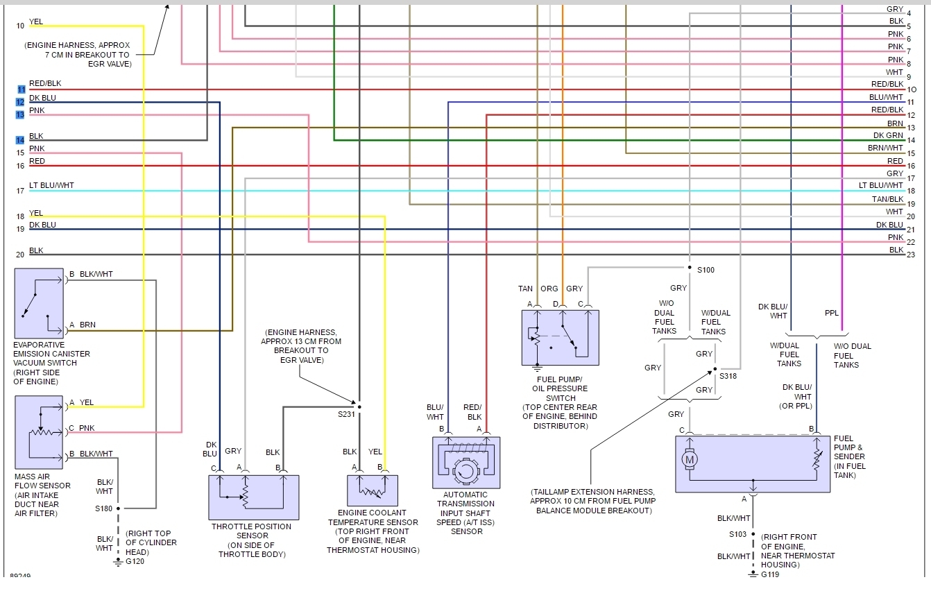

It sounds like you have an ignition module or a crankshaft sensor that has gone out, I would replace them both if one is bad because one can make the other go out. Use your volt meter and see if there is pulse at the sensor. Also it looks like you have two crankshaft sensors one down at the crankshaft and one in the distributor.
Here is some wiring diagrams to get you started.
Let me know what you find.
