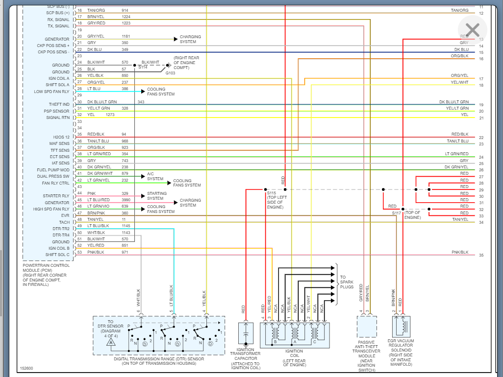

After doing an engine swap, the car ran for 2 minutes, cut out and isn’t getting spark anymore. Have checked the fuel and it’s all okay. Changed out coil pack, spark plugs, crank, and cam sensors and still nothing.

Feb 24, 2022 at 12:50 PM
Okay. Got it. So, this is going to be a little more difficult for us because we don't have an inline 6-cylinder engine, but this vehicle is closest to a Taurus which is sold here in the USA.
So, here is a guide that will help with checking for spark which is where we should start:
Next the way to check the coil is to see if it is getting 12-volts on the terminal coming from the power source which will be a fuse.
I attached a wiring diagram below for reference.
Then depending on how many coils you have, there will be a wire coming from the PCM which is what is used to interrupt the 12-volt signal to create the high voltage spike needed for the spark plug.
Basically, this is going to normally be a ground through the PCM but if you have a single coil then you are not going to have the A, B, C as shown.
Let's check for voltage here and go from there all assuming that you have no spark at the plug.

I’ve tested at the connector that goes into the coil pack, 4 pin connector with one pin reading at 12.4v. I'm guessing that this pin is the common pin and the other 3 are for the different circuits within the pack.
Feb 25, 2022 at 10:00 AM
You are correct that the one with 12 volts is the power supply. However, if you have 3 other wires, more then likely you have 2 coil packs, and the other is the return to the PCM.
If you want to get a picture of this that will help but normally a 4-pin connector on a coil is one power supply, one PCM return, 2 coil packs. So, these two coil packs will feed 3 cylinders each.
Feb 25, 2022 at 10:46 AM
JAKEK27
  • 8 POSTS
Okay. so, I think I understand what you're saying. In the connector the far left pin is the power supply making the 2 pins across from it the primary and secondary circuits in the coil pack and the far right pin the PCM return.
Feb 25, 2022 at 10:49 AM
Yes. That is correct. Technically the primary and secondary circuits are internal to the coil but the wires coming from the PCM are to create the voltage spike for the coil.
