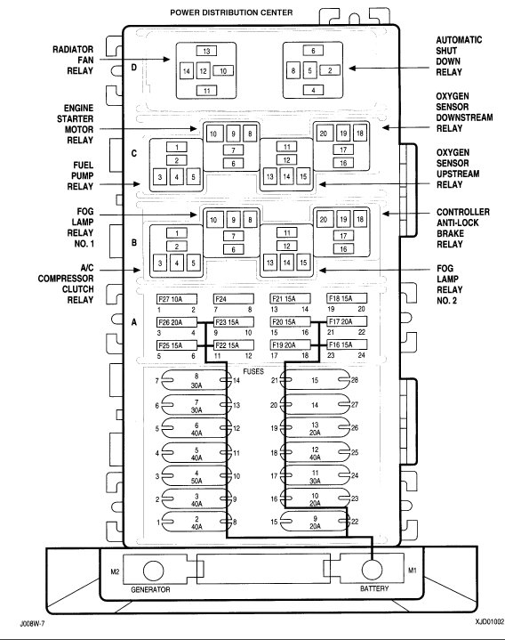

I went out to start my Cherokee this morning (drove it yesterday it was fine). it cranked but would not start. the key with the line through it keeps coming on and staying on steady not flashing and the fuel gauge is not moving at all.

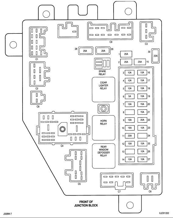

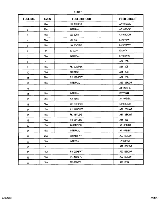

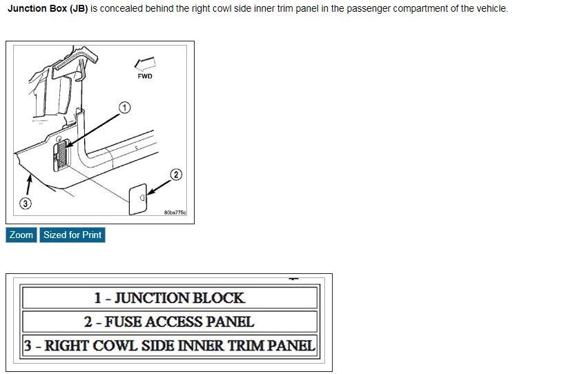

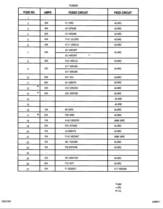

If you still do not hear the pump come on, then you need to check the fuses. There are fuse box diagrams attached below. The first fuse box to look at is the power distribution center, which is under the hood, right behind the battery. In particular, look at the fuses for "fuel pump", "ECM/TCM," "PWR Train," and "ENG Ign." ALLData's description (slightly confusing) is in the last image attached below.
