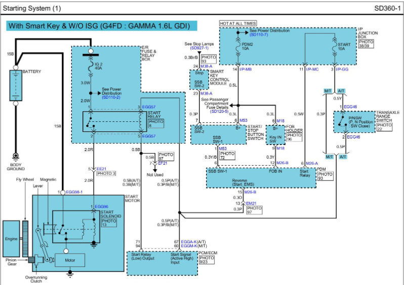

This car model is the Soul. It will crank but not start. All the lights work and there are no abnormal noises. I can get the car to start by rolling it and popping the clutch and once it starts I have no issues. Any ideas?

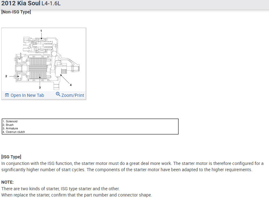

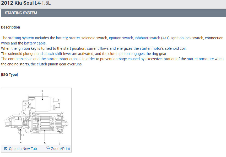

The second item needs to be checked is the starter. As when you do a rolling start you bypass the starter to start the car.
https://www.2carpros.com/articles/how-a-starter-and-solenoid-works
