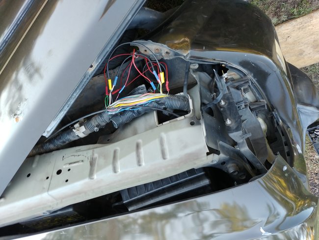

I know this was completely dumb, but my front fender wall was hanging and rubbing the tire when i turned right and i had the bright idea of using a sheet-rock screw to hang it up. Well my screw went through the plastic into the wire bundle. Didn't immediately shut off but within the time to put my screw gun back in building and come back out it wasn't running. It cranks but doesn't catch. I've taken off the quarter paneling and spliced new wire into the damaged ones. Getting spark to the number 1 and i can hear fuel pump whine. Checked all fuses and relays under steering wheel and fuse box on passenger side. Got frustrated and haven't checked relays on driver side. Spayed starter fluid but still didn't fire. I'm curious if it's the timing or what. Please any information would be appreciated.

Can you take a picture of the wiring that was damaged and upload it for me to see? I'm not sure what was damaged.

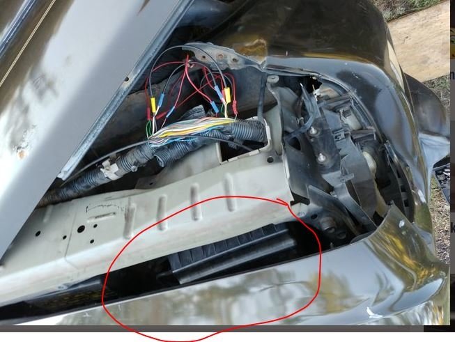

I re-posted your picture and circled a component. I believe I'm looking at the power-train control module (circled). Is there a large connector going to what I circled? Are you certain you hear the fuel pump? Also, have you checked any other spark plugs for spark other than number one?
I suspect (and this is a guess) you aren't getting fuel. Since it was running and then slowly died when you left, that is my first suspect. If I am correct and I'm seeing the PCM, you may have shorted something internally, so recheck fuel and spark. If you have both, it should run. One must be missing.
