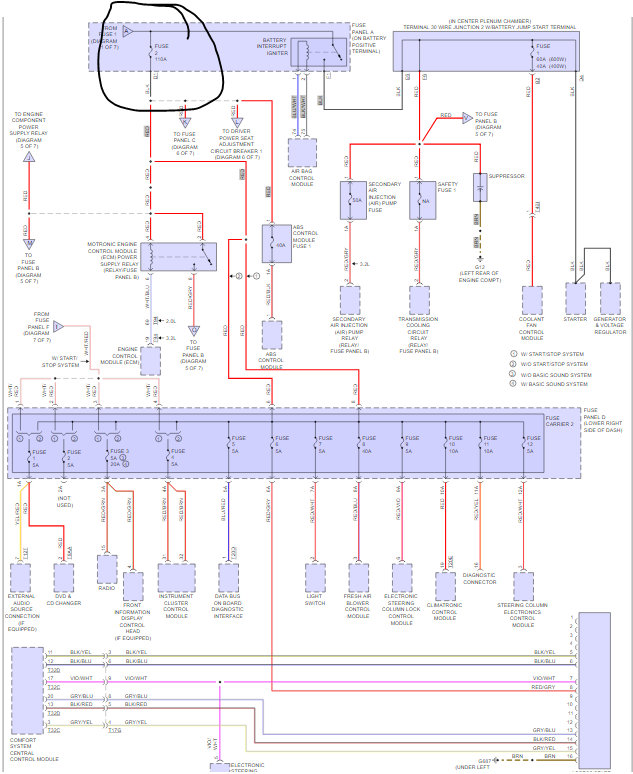

Drove home from New Jersey. Christmas night. Next morning wont start. Changed coils no change. Change spark plugs no change. Change crankshaft position sensor (on top of engine) no change.

Hi Dacosta1, my name is Alex and I will be helping you today. Have you check the fuse going to ECU? Here is a wiring diagram with it circled for you. Hope this helps.

Where do I find this fuse location under the hood?

On the positive battery terminal.
