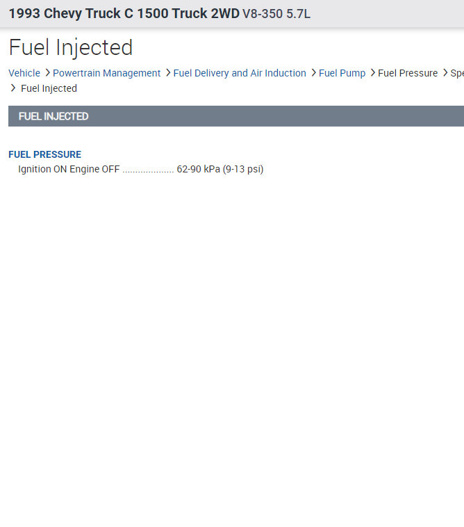

Can you hear the fuel pump with the key to the on position?

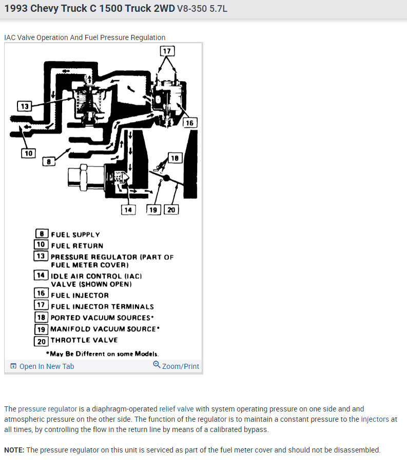

If you can hear the pump then you need to see if you have fuel pressure. In case a faulty regulator is causing the issue.
You should have 9-13 PSI of fuel pressure with the key on and engine off.

So if the pump is coming on then you need to check the fuel pressure. If the pressure is low then you could have a bad regulator or could be a restriction in the line.

Make sure you are getting fuel. It should be 9-13 PSI with the key on and engine off.

If the pump is coming on but you do not have proper pressure, it could be due to a clog in the line, could be a fuel filter that is jammed or a bad regulator.

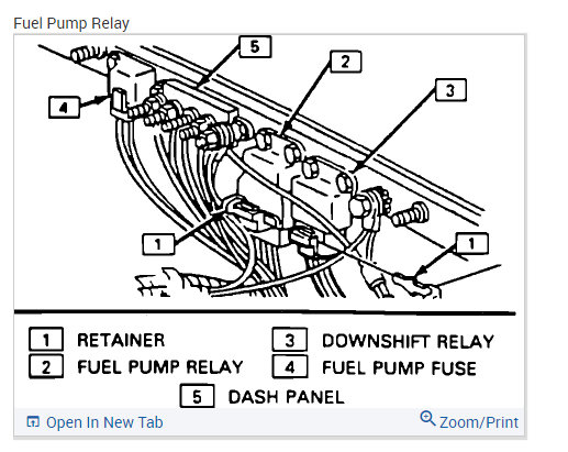

What exactly does the fuel pump relay do??
Sep 20, 2021 at 3:54 AM
SQM
  • 6,383 POSTS
The fuel pump relay provides power to the pump. If the relay is bad then the pump will not get any power and will not turn on. So if you can hear the pump come on the relay should be good.

What's weird is what I started out with, wouldn't start, then I changed the fuel pump relay then it started, but only lasted a week..

It does sound like the engine is not getting enough fuel. It could have a restriction on the line. Like a clogged fuel filter or a bad regulator. Only way to tell is by testing the fuel pressure. Did you say that you checked the fuel pressure?
