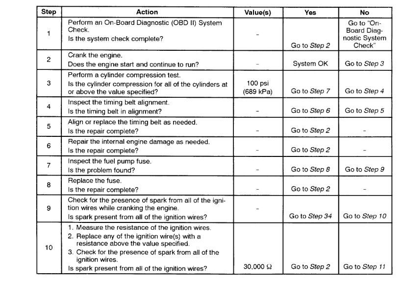

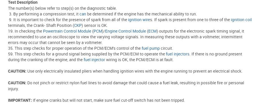

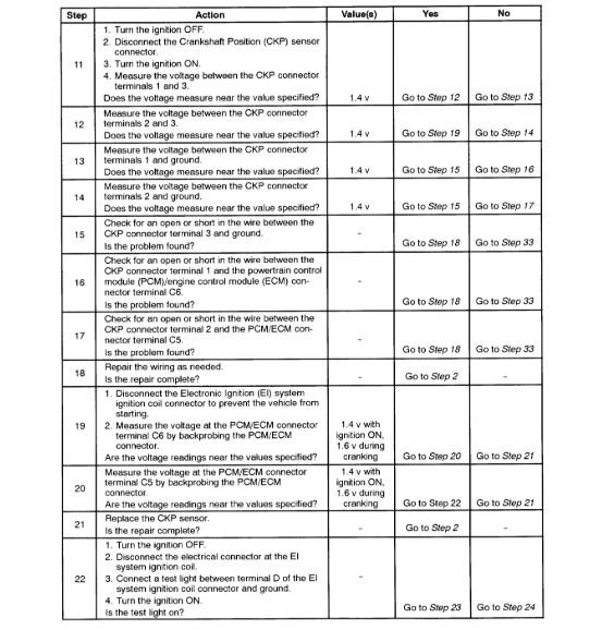

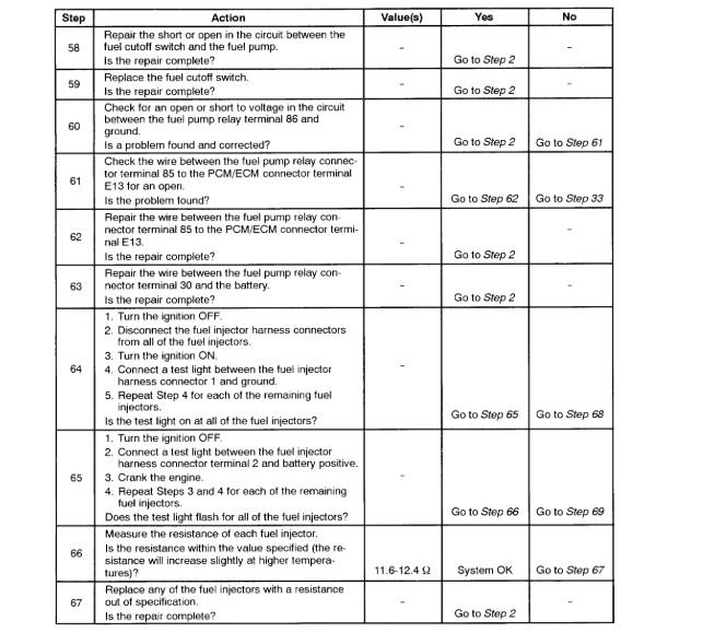

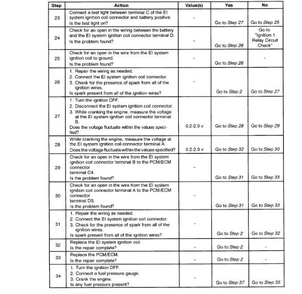

My car keeps cranking but does not start I removed the cam and crank sensors and replaced them now it still does then same. The cam looks like its fora Lenos and doesn't fit behind the timing head could it be that is the main issue uptill now
Feb 12, 2020 at 4:28 AM
Much better thank you.

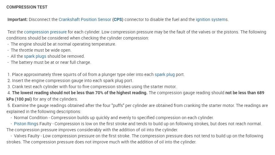

You need to check the compression to see if the timing belt has failed.
You need to test for spark at the plugs.
You also need to check for fuel pressure.
I attached flow charts to help determine the source of the failure.
Feb 16, 2020 at 1:37 AM

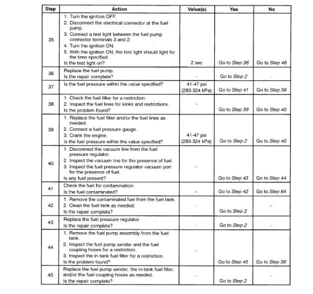

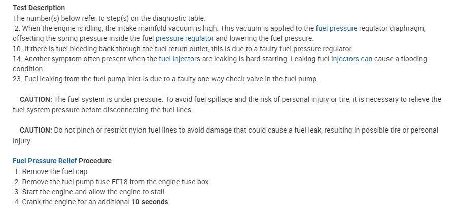

There are many things that can cause this type of an issue. Do the simple things first. Check the air filter to make sure it or the induction tube are not plugged.
Check to make sure there are no engine vacuum leaks.
Check to make sure fuel pressure is within the manufacturer's specifications.
Here are the manufacturer's specs for pressure.
Fuel Pressure .................... 283-324 kPa (41-47 psi)
If the check engine light is on, check for trouble codes which can direct us to where the problem is coming from.

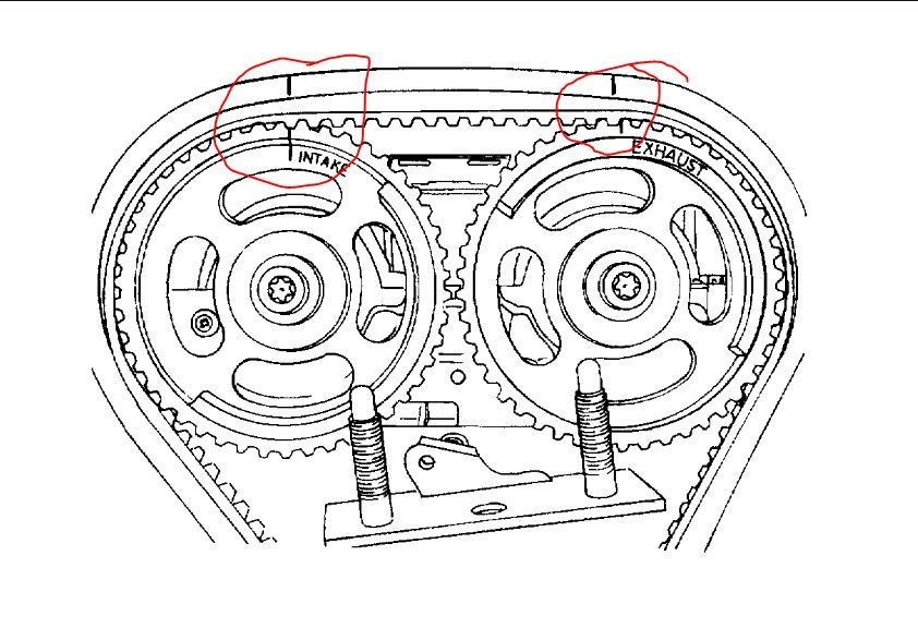

Hi my car wont start after all is been don , you gave me the firing order sequences a. remove and install of head and replace gasket, torque sequences, but now try to start engine and it won't run, what else need to be done all the fuses are new battery.
Please Help :-)
Jan 21, 2021 at 8:39 AM (Merged)
KHLOW2008
  • 41,812 POSTS
You should have replied to your earlier post so that whoever attended to you can response when notification is received.
Did you check the engine compression?
Do you have sparks at the spark plugs?
Have you checked the fuel pressure and does starting fluids work?
JOISHUA2625JR7
  • 7 POSTS
Yes i did all that still i was told that the firing order is 1342 and how would i know in which position are they in the ignition coil? and how would i know is the timing is correct? i beleive if iwould get the correct answer i have ask my dad for some money to send to who ever help me out..
JOISHUA2625JR7
  • 7 POSTS
A while ago i ask of you to give me the timing sequence and firing order of a 1999 daewoo nubira but what i didn't now is that this vehicle carries a 2001 engine, would this make a difference? and by the way still engine won't run or start?
KHLOW2008
  • 41,812 POSTS
You should continue with your previous post so that whoever attended to you can response when notification is received. This would keep the history of what had transpired in one thread for easier reference.
Yes , both engine are the same. Have you check the engine compression and are there sparks and fuel pressure?
