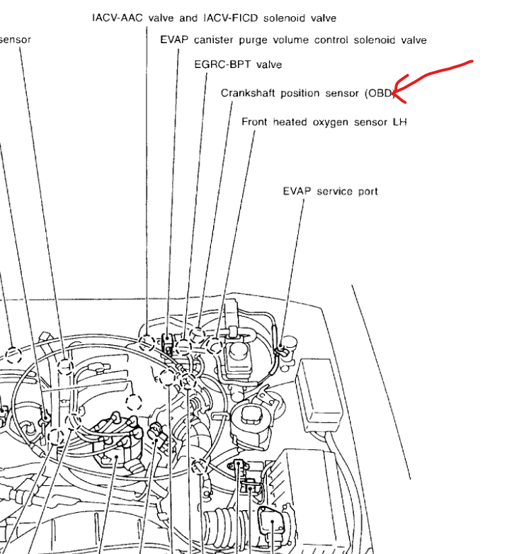

All sensors have been replaced, the crankshaft angle sensor in the distributor has been replaced. but can't find the crankshaft sensor on the bell housing. This is an Automatic is there a second crankshaft sensor on the vehicle listed above R50 model.

here is the location of the crankshaft sensor. Check out the images (below). Please let us know how it goes. Does this engine have a distributor or no?

Yes, and the rotor button and crankshaft positioner have been replaced.

I am sorry I don't have a better image for you, this is all it says:
Crankshaft Position Sensor (OBD) On transmission housing, facing flywheel gear teeth. See Figure .
Does the engine have spark? If so, the crankshaft sensor is not the problem.
