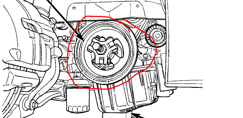

So the crankshaft is not moving when I try to start it.
May 3, 2020 at 9:16 AM
  • 110,244 POSTS
Is the starter turning the engine? If it is, the crankshaft has to turn. The flywheel that the starter turns is connected to the crankshaft. Does it sound normal when cranking? Can you record it and upload it for me to hear?
Note that the crankshaft pulley is the big one at the very bottom of the engine. It drives the serpentine belt.
I attached a pic for you to see. In the pic, they have a puller attached, but you can see how it is located at the bottom of the engine.
Could you mean the camshaft isn't turning?
Let me know. Also, if you could record the engine cranking, I may be able to identify by how it sounds what is happening.
I will watch for your reply.
