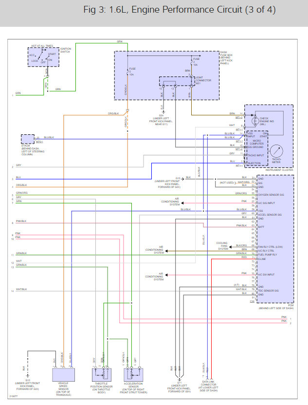

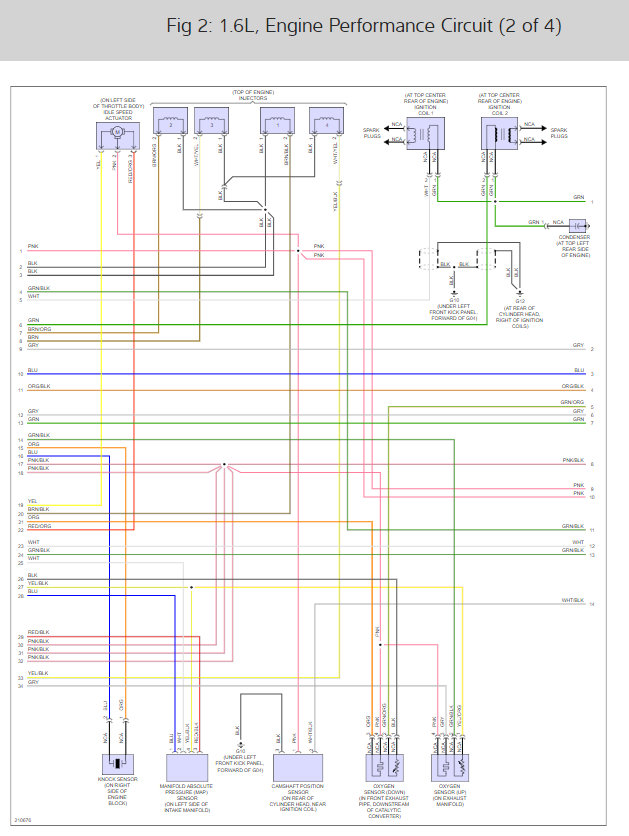

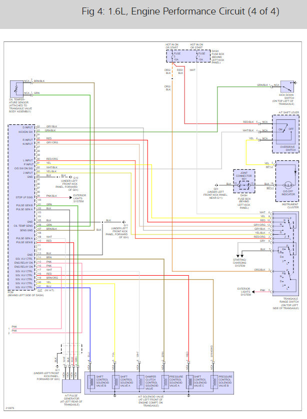

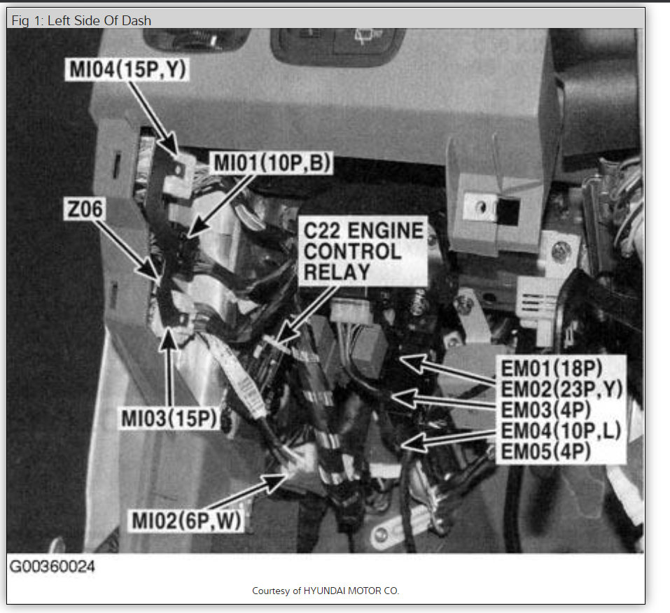

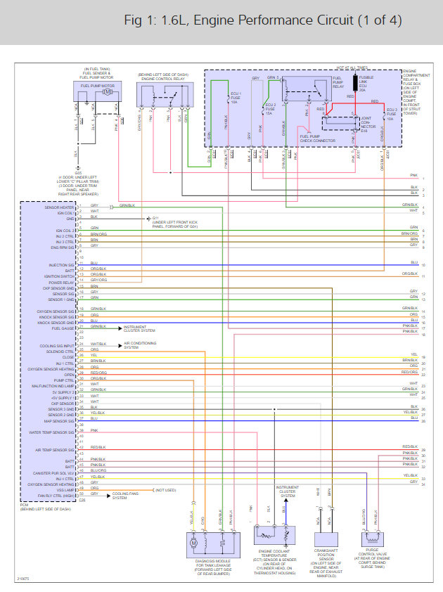

I have no spark, no fuel, timing belt good. replaced crankshaft sensor, but still no start. took to garage and it started, drove home and parked it. no start the next day. Do you have any ideas?
Apr 17, 2018 at 4:02 AM
  • 55,748 POSTS
It sounds like you have a PCM relay that is going bad. Here is a guide to help you test the relay:
We should run the codes as well.
Here is the location of the relay and the engine wiring diagrams so you can see how the system works.
