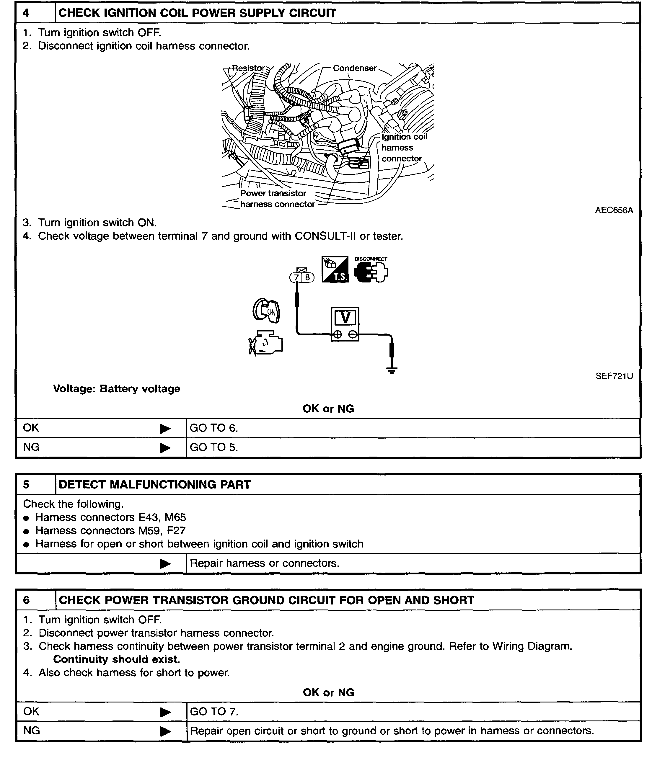

Engine cranks but no spark.

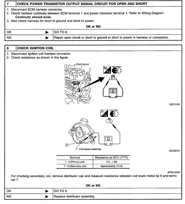

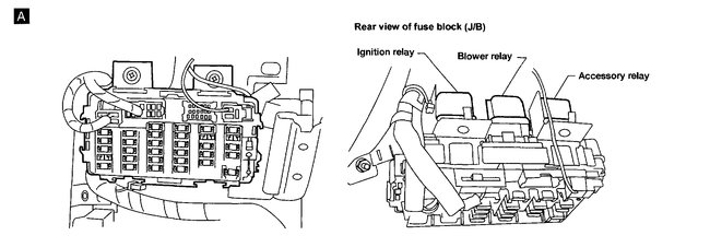

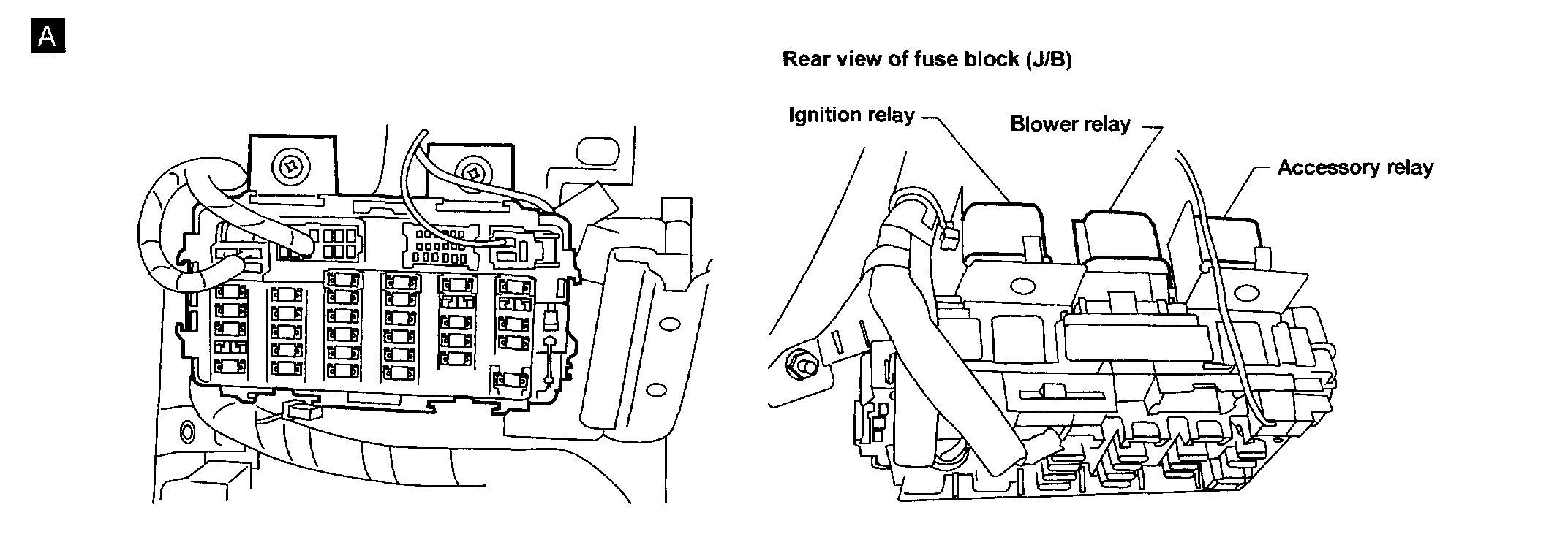

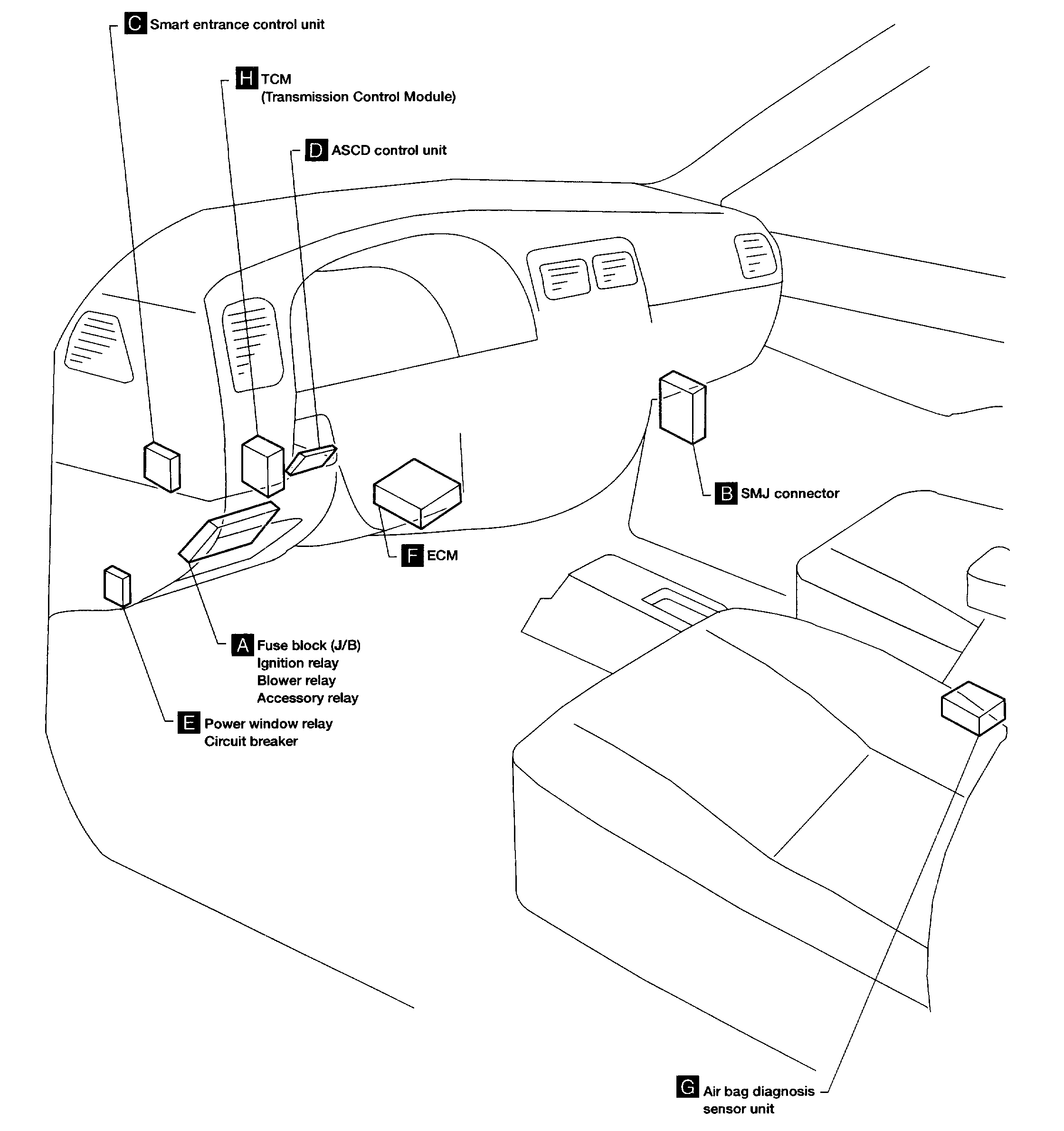

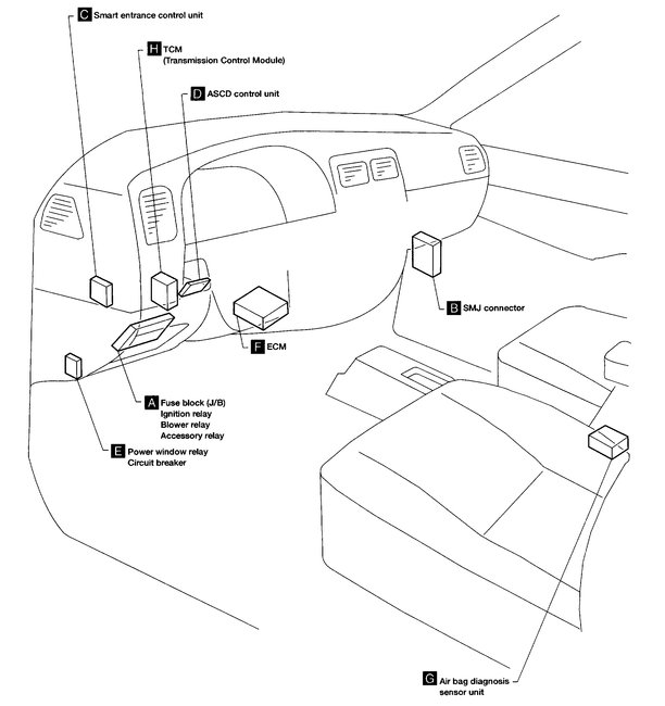

If you have no spark, the first thing to check is the ignition relay. It is located under the dash. I attached pictures of its location. Switch it with another relay that has the same part number. If you can't find a matching relay, here is a test that shows how one is checked:

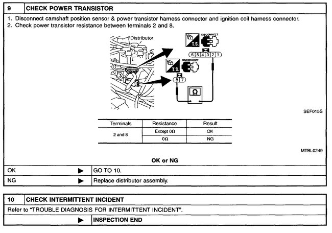

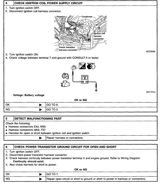

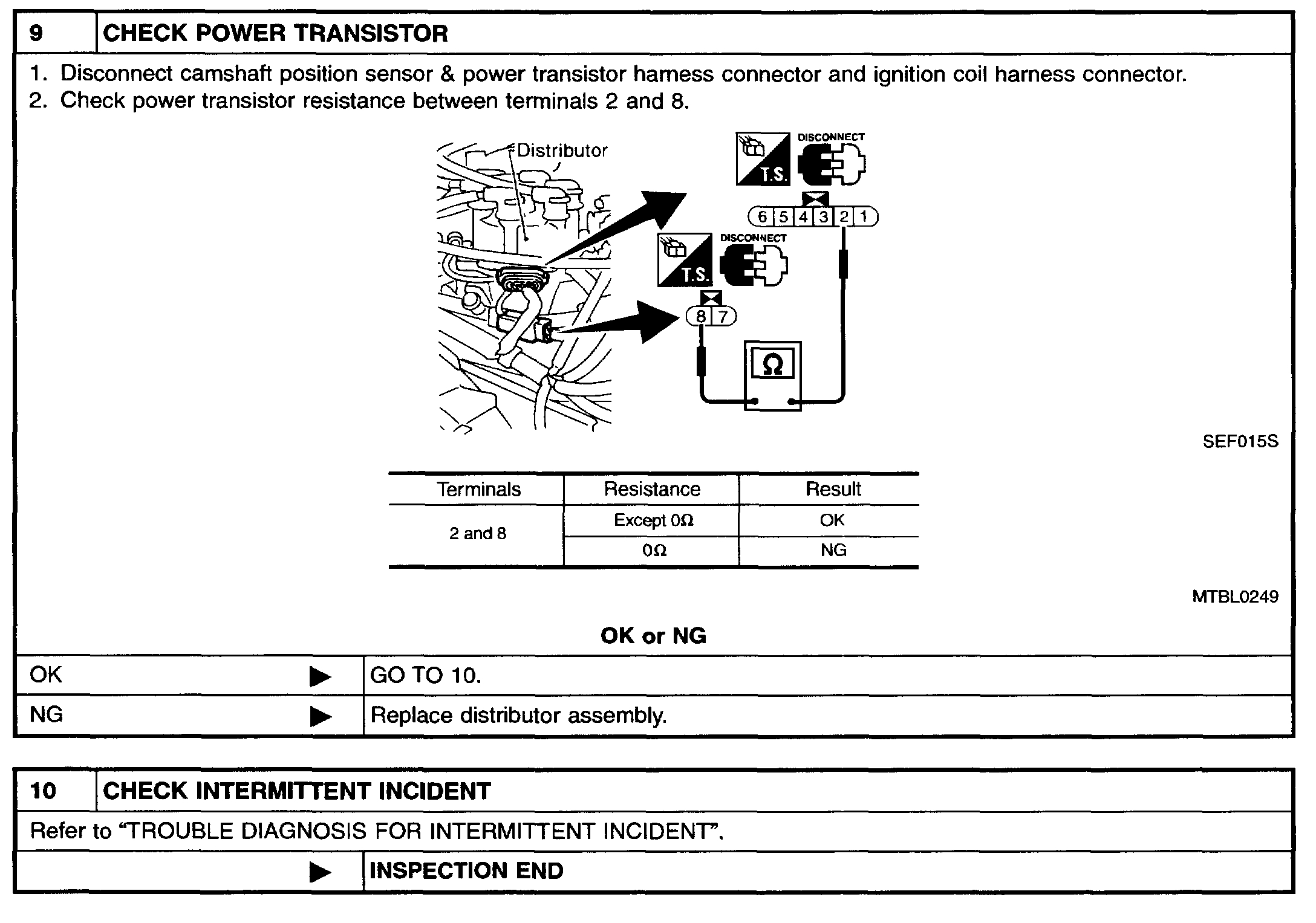

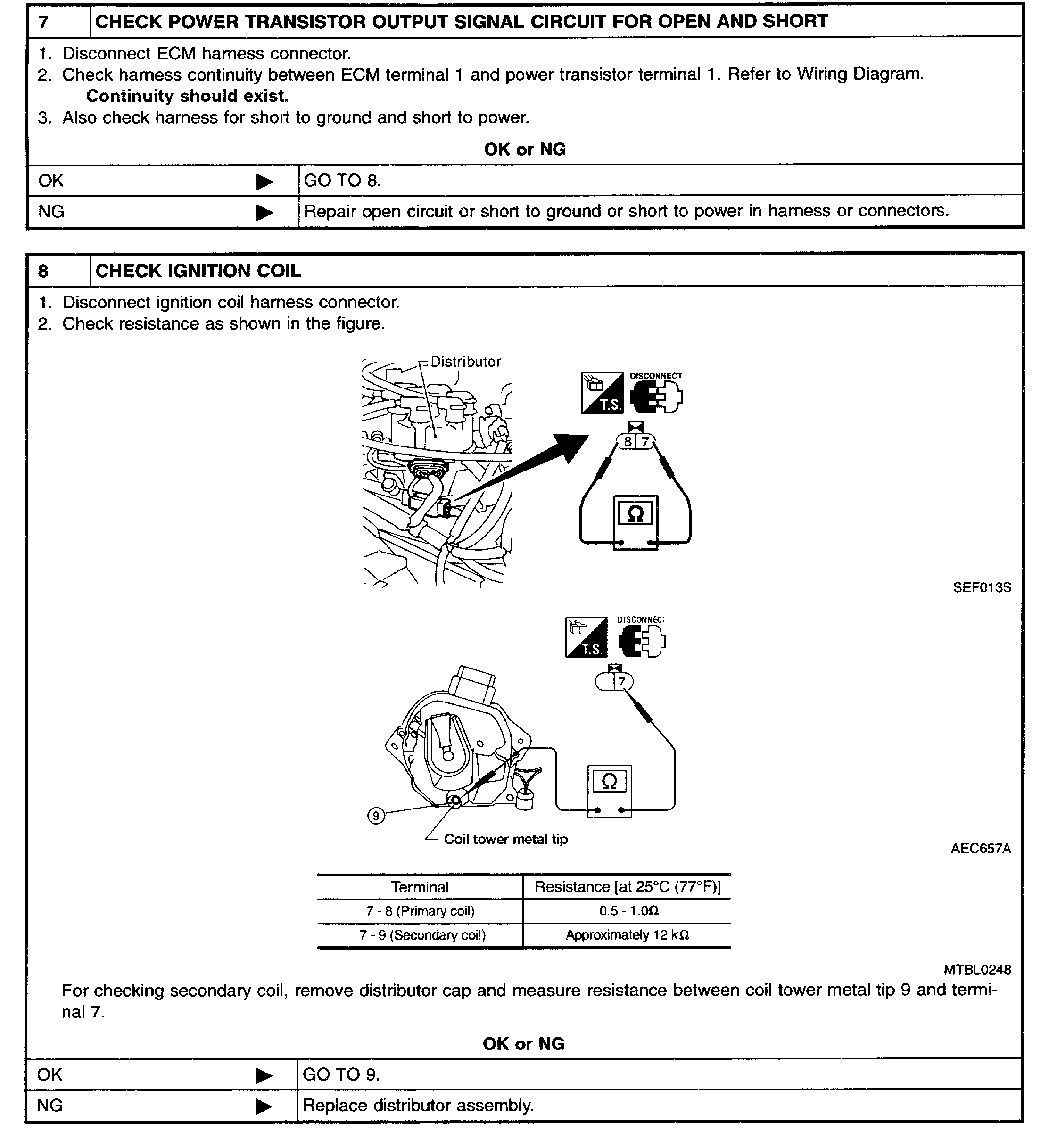

If the relay is good, the coil and power transformer is part of the distributor and are not serviceable. I attached the flow chart to check the components in the distributor. See Pictures 3, 4, and 5. These test are somewhat involved so I'm not sure you feel comfortable doing them. However, if you do, here are a few links you may find helpful when performing them:
Let me know if any of this helps or if you have questions.
