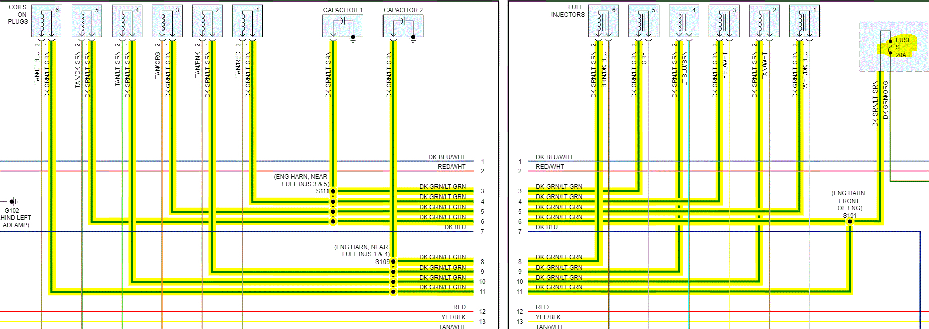

It shut off while driving slow, cranks, but not getting any fire to any coils. I changed the Cam sensor, the crankshaft sensor, and battery. I checked everything with a multimeter and I'm getting voltage everywhere but the coils.

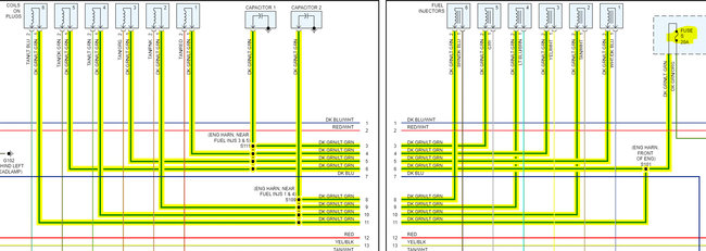

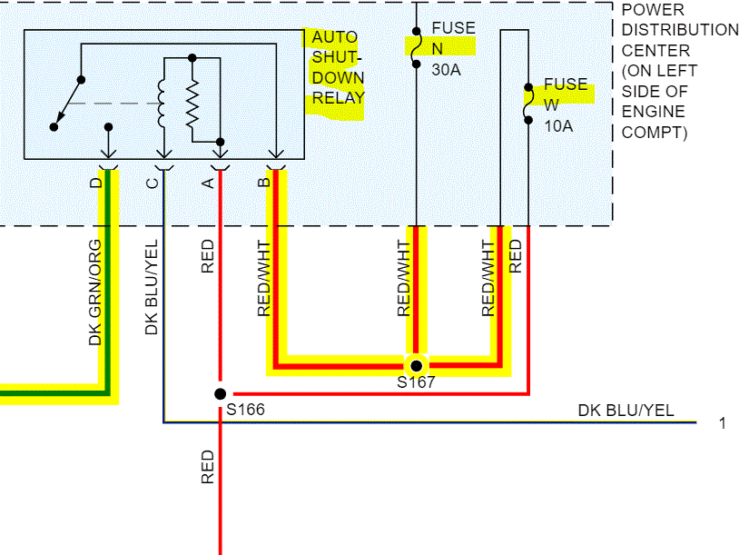

If you are getting power to the fuel injectors, power should be available to the ignition coils as well.
If you look at pic 1, it shows how the two circuits are powered (coils and injectors). The dark green wire with a light green tracer should have power with the key on.

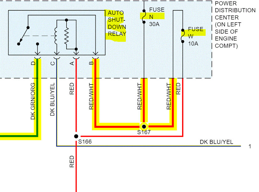

Please double-check if the injectors (same color wire) have power. If they don't, we need to work backward from there. If you haven't already, confirm the auto shut down relay is good and has power. Also, check the fuses in the two schematics below.
When you check the fuses, also make sure they have power to and from them.
Here are two links. One will help with checking power at the fuses and the other is for testing a relay.
Let me know what you find so I know which direction to go.

I checked the ASD by switching the relays around, all of them work in other spots. I have to dig out the old test light, but that's a great idea.
Apr 27, 2022 at 7:19 PM
  • 110,194 POSTS
When you switched the relays, that was a good idea. However, also make sure there is power to it.
There are 4 pins on the relay identified as 85, 86, 87, and 30. Pins 85 and 86 are the primary sides of the relay. Power transmits from pin 85 through the relay and is provided a ground path via pin 86. (Note: these two pins' power flow can be opposite as well). When this happens, there is an electromagnetic field created which draws a switch closed allowing power to fun from pin 30 through the relay and out pin 87 to the accessory being powered.
With that in mind, also check pins 30 and 85 at the ASD for power. This must be done with the key on.

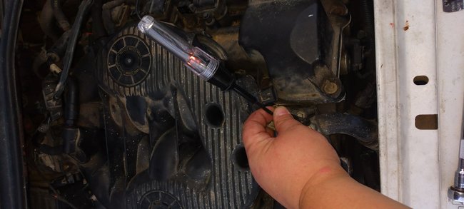

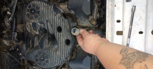

I found my light, I figured out where my short is, but I don't know how to get the valve cover off to fix the short. I'm attaching pics, the one where I'm holding the test light, you can see the very dim glow.

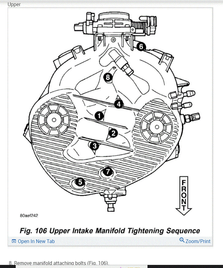

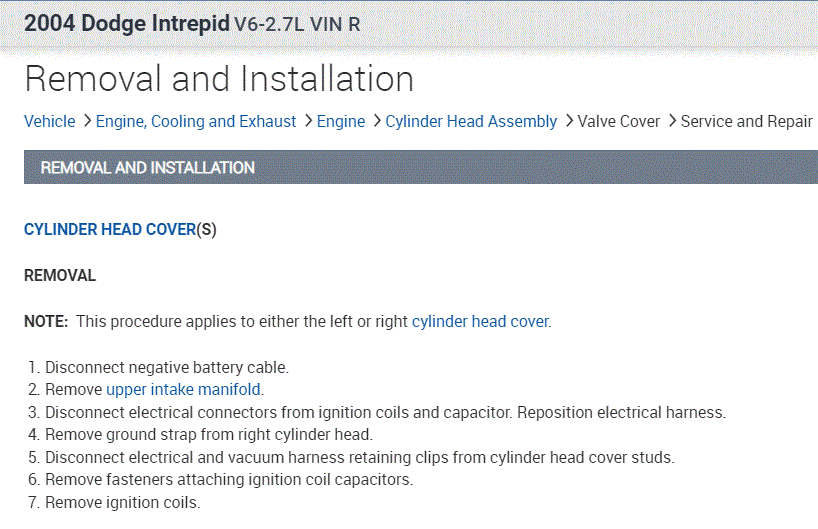

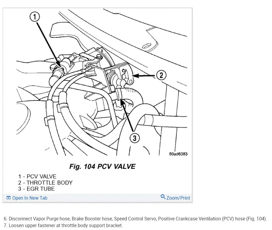

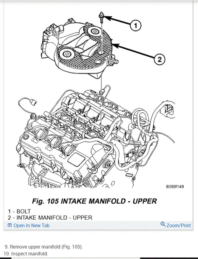

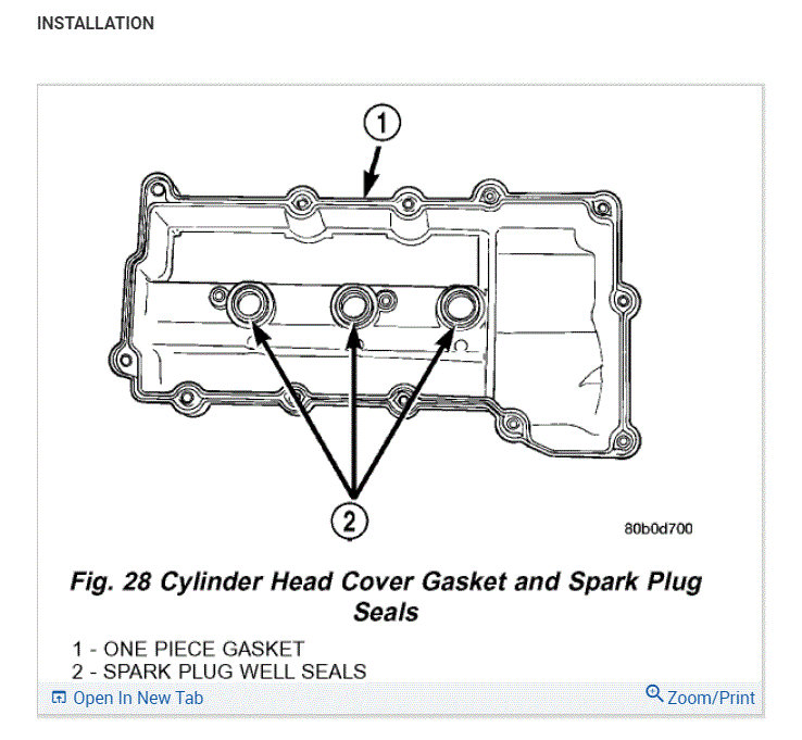

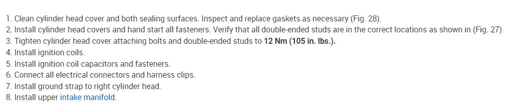

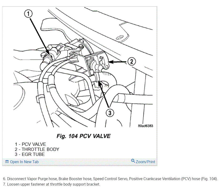

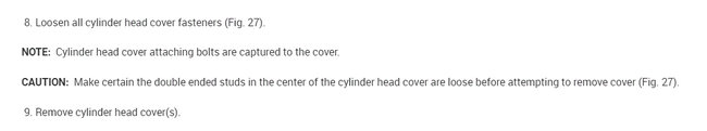

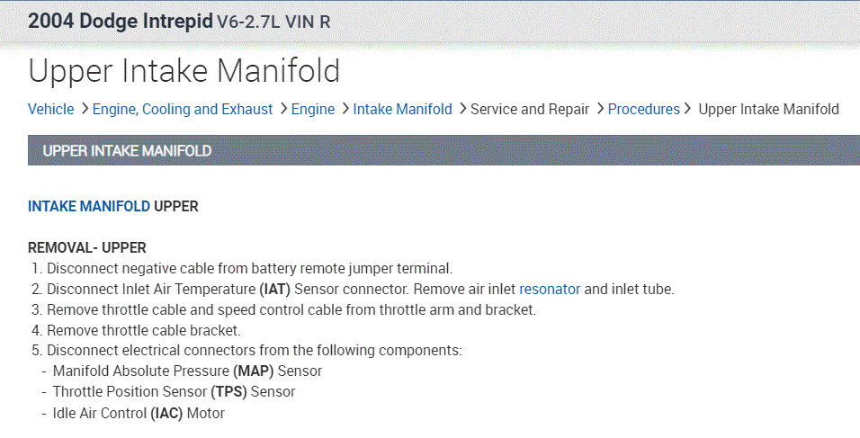

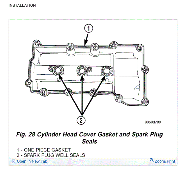

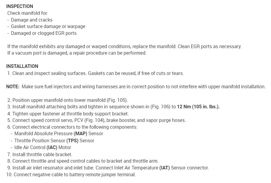

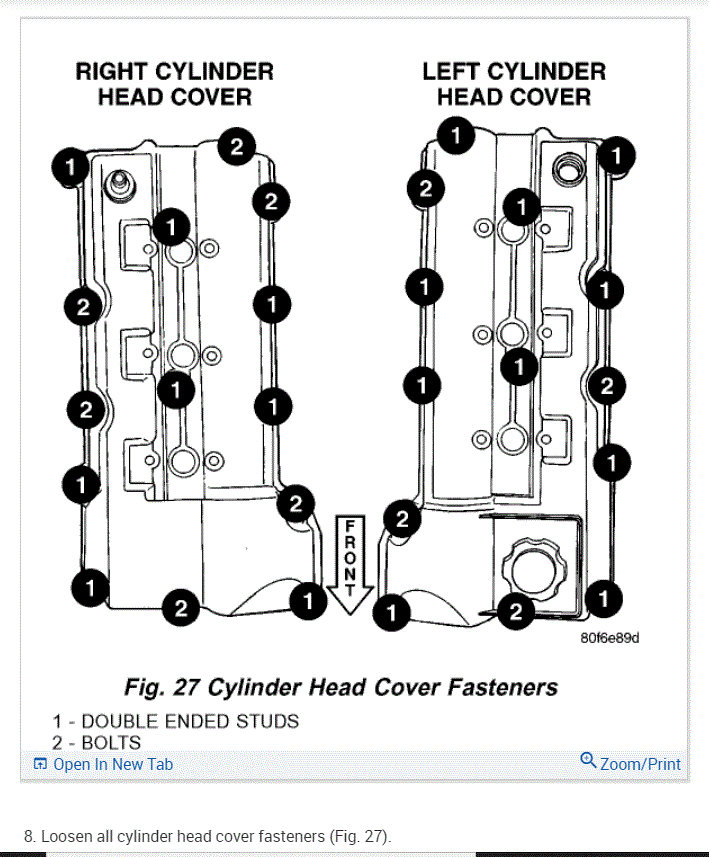

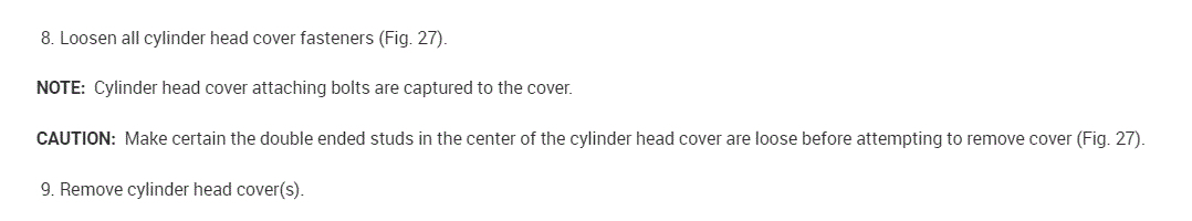

To remove the valve covers, you first need to remove the upper intake manifold. It isn't hard, but just one more step in the procedure.
If you look below, first I provided the directions for the removal and installation of the manifold. The second set of directions is for the valve cover.
I assume there is a pinched wire. Is that correct?

Please forgive my nativity, I'm not exactly mechanically inclined. The intake manifold is where the issue is, the dim light is on the MAP sensor. was given the idea of taking the breather off and spraying starter fluid directly into the intake. That way i can see if it tries to turn over.
