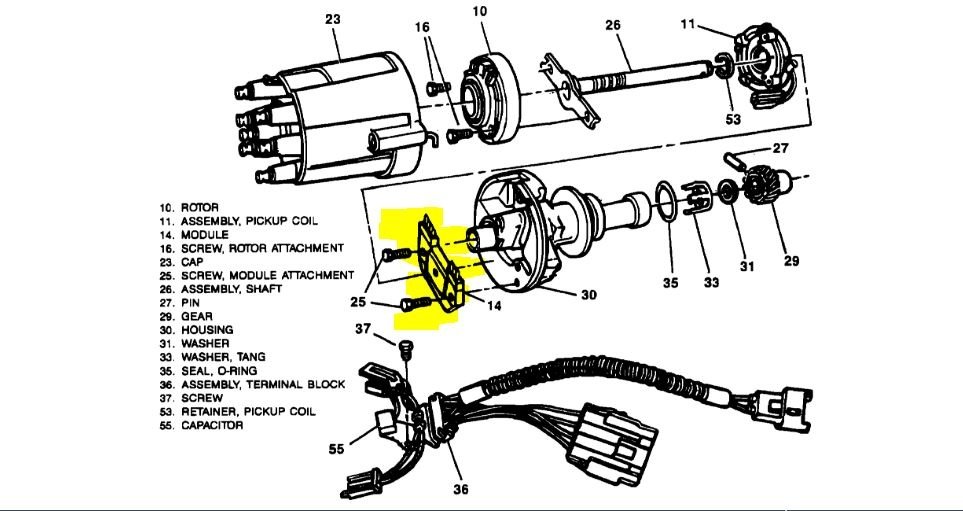

so i broke down because my clutch stuck to the floor. i bled the clutch it works now, but my truck will crank but not start. i replaced ignition coil and knock sensor still just cranks. haven't tested spark plug because i know i am not getting spark and compression on fuel pump is 10-12 psi. but i have throttle body injection, so psi should be 13-17. i can here my fuel pump come on and i smell gas when i crank it. I am really confused because i don't know what else it could be. any help appreciated.

If you smell gas, chances are there is no spark. I recommend checking that first. here is a link that explains how to test it. Confirm it is or isn't getting spark and let me know the results.

It is not getting spark. I looked up what the problem could be, most said a crank position sensor, but on my year/model it doesn’t have one.

First, you are correct. A crank sensor wasn't used on this model. However, the most common cause of spark loss on it is related to the ignition control module in the distributor. Here are directions for replacement:
________________________
1993 Chevy Truck S10/T10 P/U 2WD V6-173 2.8L
Ignition Module Replacement
Vehicle Powertrain Management Relays and Modules - Powertrain Management Relays and Modules - Ignition System Ignition Control Module Service and Repair Procedures Ignition Module Replacement
IGNITION MODULE REPLACEMENT
Typical Distributor Components
Pic 1

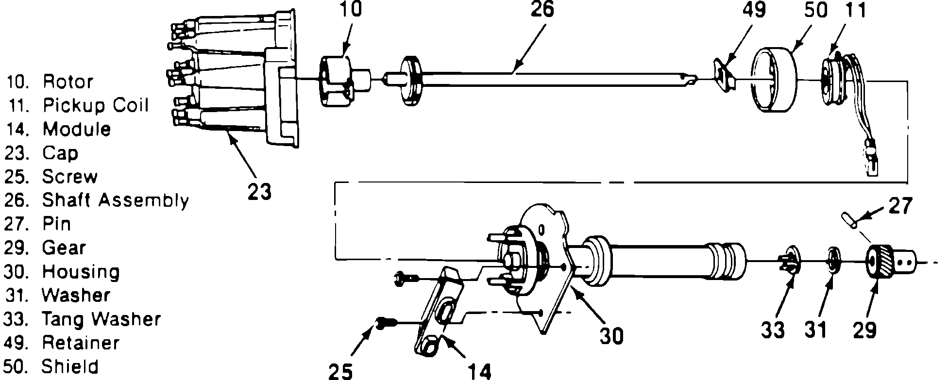

I highlighted the part in Pic 2

Before just replacing it, pull trouble codes. You don't need a scanner. You can do it with a short jumper wire or even a paper clip. Here is a link explaining how it's done. Do this and let me know the results.
