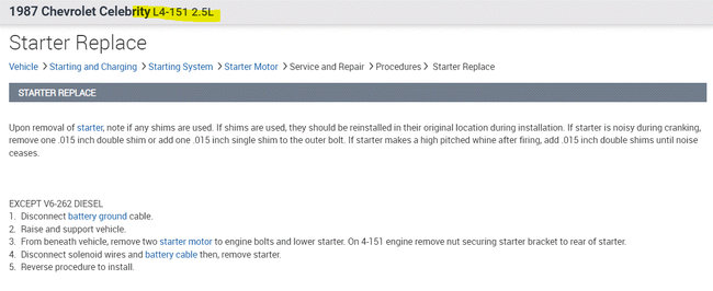

The attachment below is from the manual and are for a 2.5L 4 cylinder. If that isn't correct, let me know.
See pic below.
