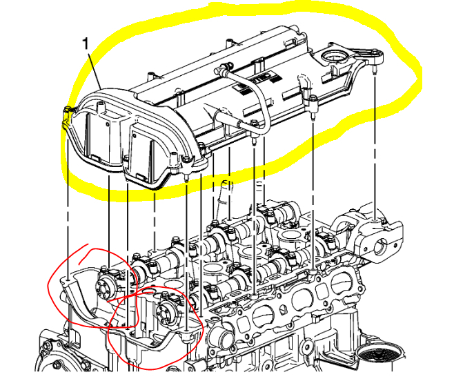

No problem whatsoever. Listening to the video you provided and knowing the engine is actually turning, it sounds like either the timing chain has broken or has jumped time.
What I suggest is to remove the valve cover at the top of the engine so you can see the chain. Check first to see if it is still intact. If it is, then see if it appears to be extremely loose.
The biggest concern at this point is if the chain has failed in one way or another. This is an interference engine. That means if the timing is far enough off while the engine is turning, internal damage is likely to take place.
I attached a pic below of the part I'm referring to.
Let me know what you find.
See pic below.
