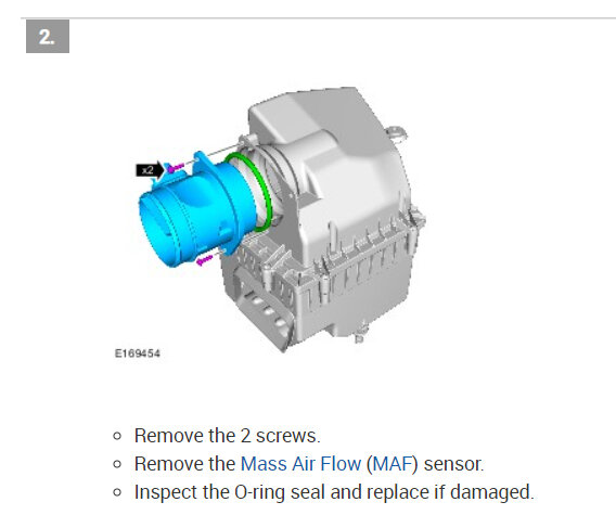

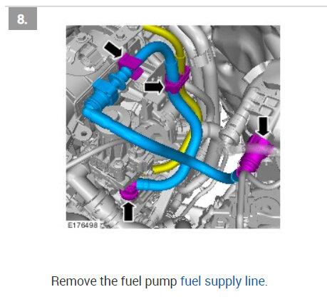

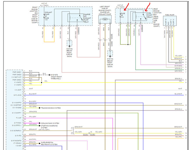

That is a good sign, so fuel seems to be the problem, the car has diesel in it correct? Sorry I had to ask you would be surprised. Let's check for power at fuse #28 in the rear fuse panel which is for the fuel pump, also swap out the fuel pump relay, and one more thing, unplug the MAF sensor and crank it over, when this sensor goes bad it will tell the PCM not to engage the fuel pump.
Here is the location of the MAF sensor. Check out the images (below). Please let us know what happens.
