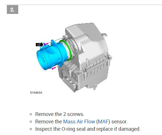

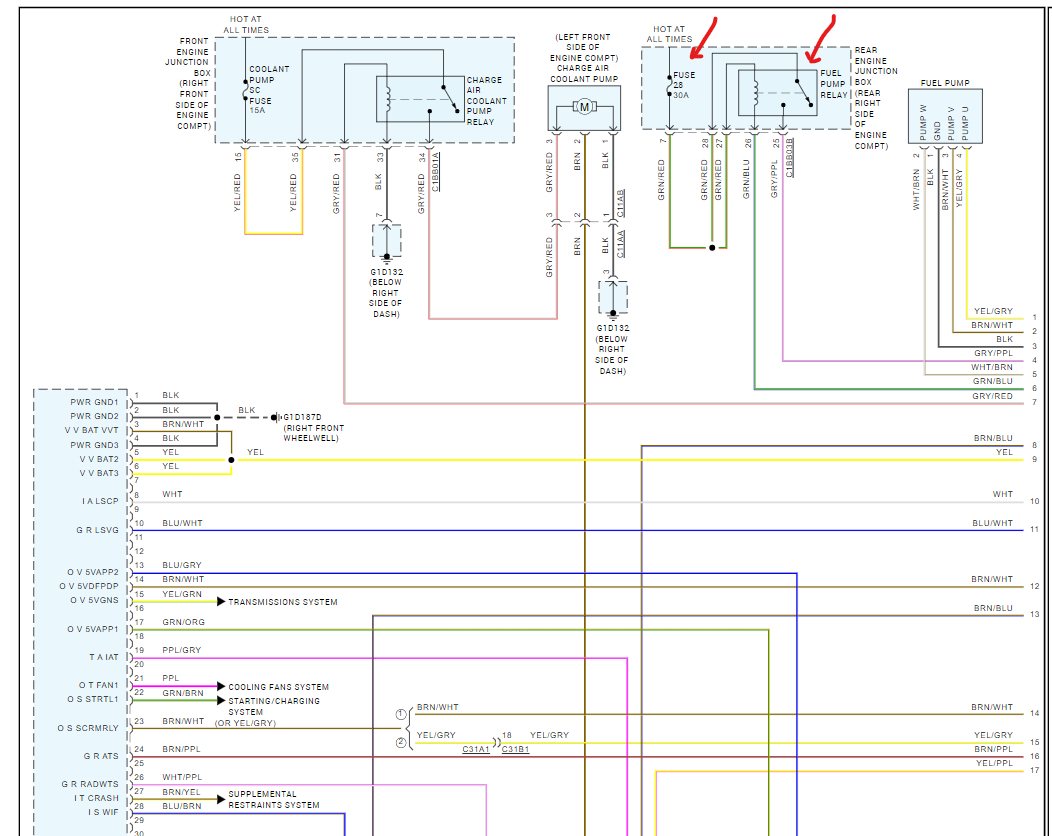

That is a good sign, so fuel seems to be the problem, the car has diesel in it correct? Sorry I had to ask you would be surprised. Let's check for power at fuse #28 in the rear fuse panel which is for the fuel pump, also swap out the fuel pump relay, and one more thing, unplug the MAF sensor and crank it over, when this sensor goes bad it will tell the PCM not to engage the fuel pump.
Here is the location of the MAF sensor. Check out the images (below). Please let us know what happens.

Hi Ken,
I know fuel is getting as far as the fuel filter because when I reassembled, one of the pipes wasn't quite connected properly so when the system pressurized, it popped off and squirted diesel everywhere.
It has, however, made me think of something else that may cause the issue, which is that the car has been sitting on the road for a couple of months and then in my garage since February. Could it possibly be that the diesel fuel has gone bad and needs replacing?
Many thanks.
Sep 8, 2024 at 6:50 PM
  • 55,399 POSTS
Not in a couple of months the fuel should be okay. But if someone contaminated the fuel that is another story. Can you hear the fuel pump relay click on when you turn the key on but don't crank the engine over?
Sep 9, 2024 at 1:20 AM

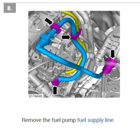

Hi Ken.
So, I took off one of the pipes to the injectors and put a rubber tube on it down into a container and turned the ignition to on (but not crank) and the fuel did end up in the container.
With this in mind, am I correct in thinking that it is either bad fuel, bad injectors, or low compression? Would there be anything else that it might be?
Many thanks
Sep 9, 2024 at 5:29 PM
  • 55,399 POSTS
It could be bad fuel, or a bad injector pump which is common or low compression, I don't think the individual injectors are bad because they would all need to go bad at once. Can you confirm there is fuel getting to the high pressure fuel pump? Turn the key on and fuel should be present. Check out the images (below). Let us know what you find.
Sep 10, 2024 at 2:25 AM
MYFATHERSSON
  • 29 POSTS
Hi Ken,
Yes, the fuel is getting to this pipe.
Many thanks
Sep 10, 2024 at 4:03 AM
  • 55,399 POSTS
Okay, so those are the choices, bad fuel, (doubtful), bad high pressure fuel pump or low compression.
