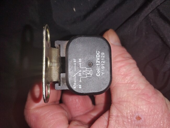

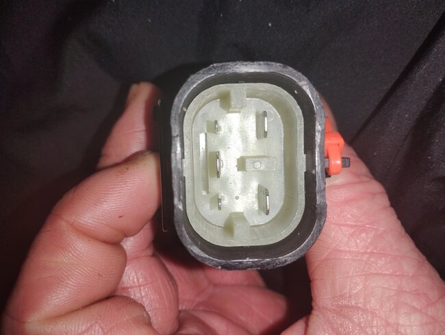

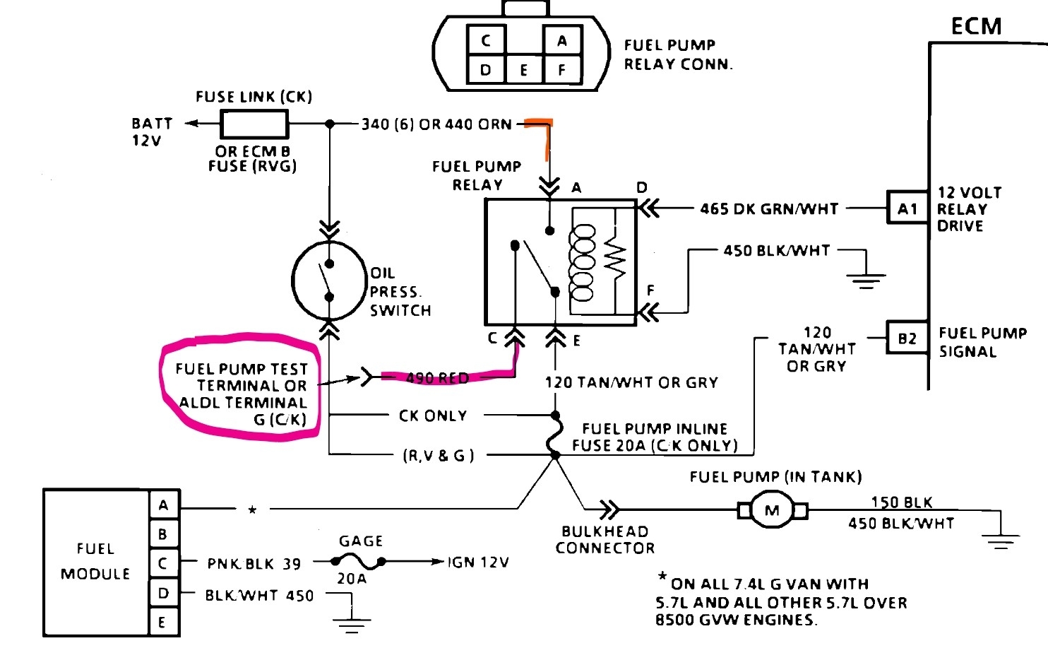

Truck cut off on me will not restart. I have replaced the fuel pump filter and battery. I picked all the relays everything comes on fuel pump and all still won't crank. Is it possible to hotwire the 5-prong fuel pump relay on the firewall under the hood and if so, what number do I run the wires from and to. Truck almost cranks but won't quite crank. And yes, I do have the fuel filter in the correct way the arrow pointing towards the motor. Also, the truck is getting gas when I take the breather off and I have somebody try to crank it I can see the gas.

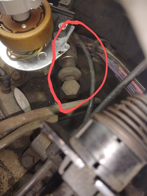

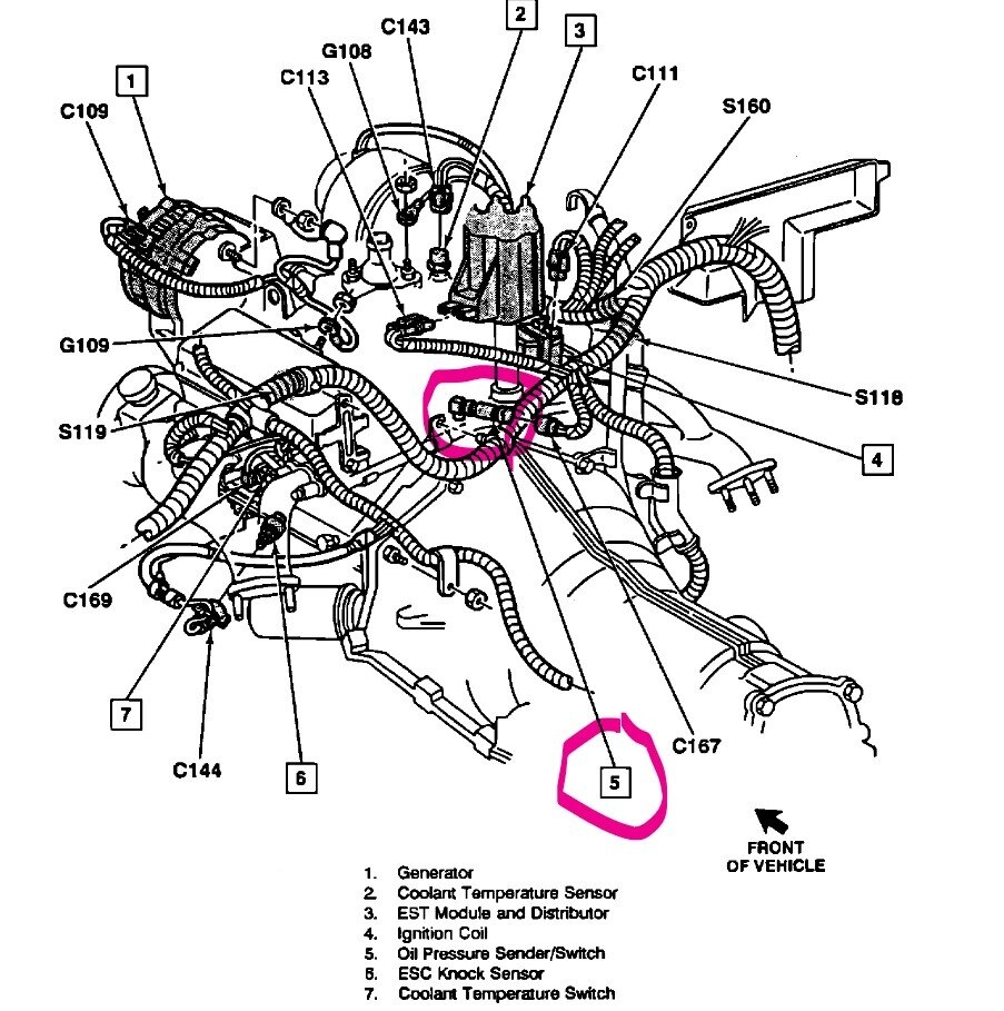

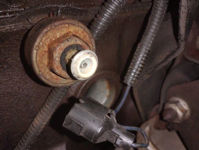

Is this the oil pressure switch?
Mar 14, 2025 at 3:29 AM
54&LEARNING
  • 26 POSTS
I went ahead and replaced the oil pressure switch and still need won't crank. I don't know what else to do.

Did you try bypassing the power to the pump yet? If it runs that way then there is a wiring issue.

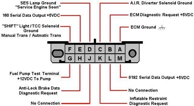

You just need a chunk of wire to connect between battery power and the prime wire or the G terminal in the ALDL and see if the pump powers on and stays on and the engine runs. If it still doesn't start and run, then we need to continue.
Mar 14, 2025 at 12:23 PM
54&LEARNING
  • 26 POSTS
That's what I am not sure if I get that I need 12v but where exactly do I get it from, plug one end of wire in G terminal and then where do I plug the other end into?

Anyplace with battery positive, right at the battery works.

Okay, I ran a wire to the battery and G terminal with a negative result. so, now I am trying to find something in the wiring that goes to the oil pressure switch that is broken or not connected if I am understanding you.

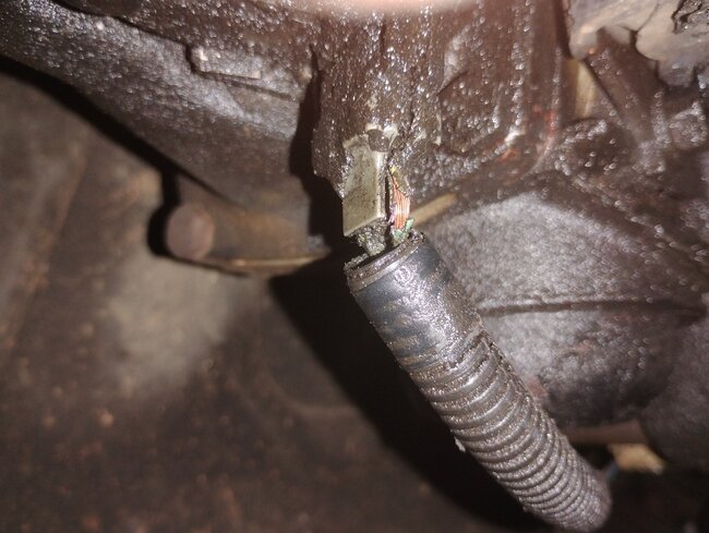

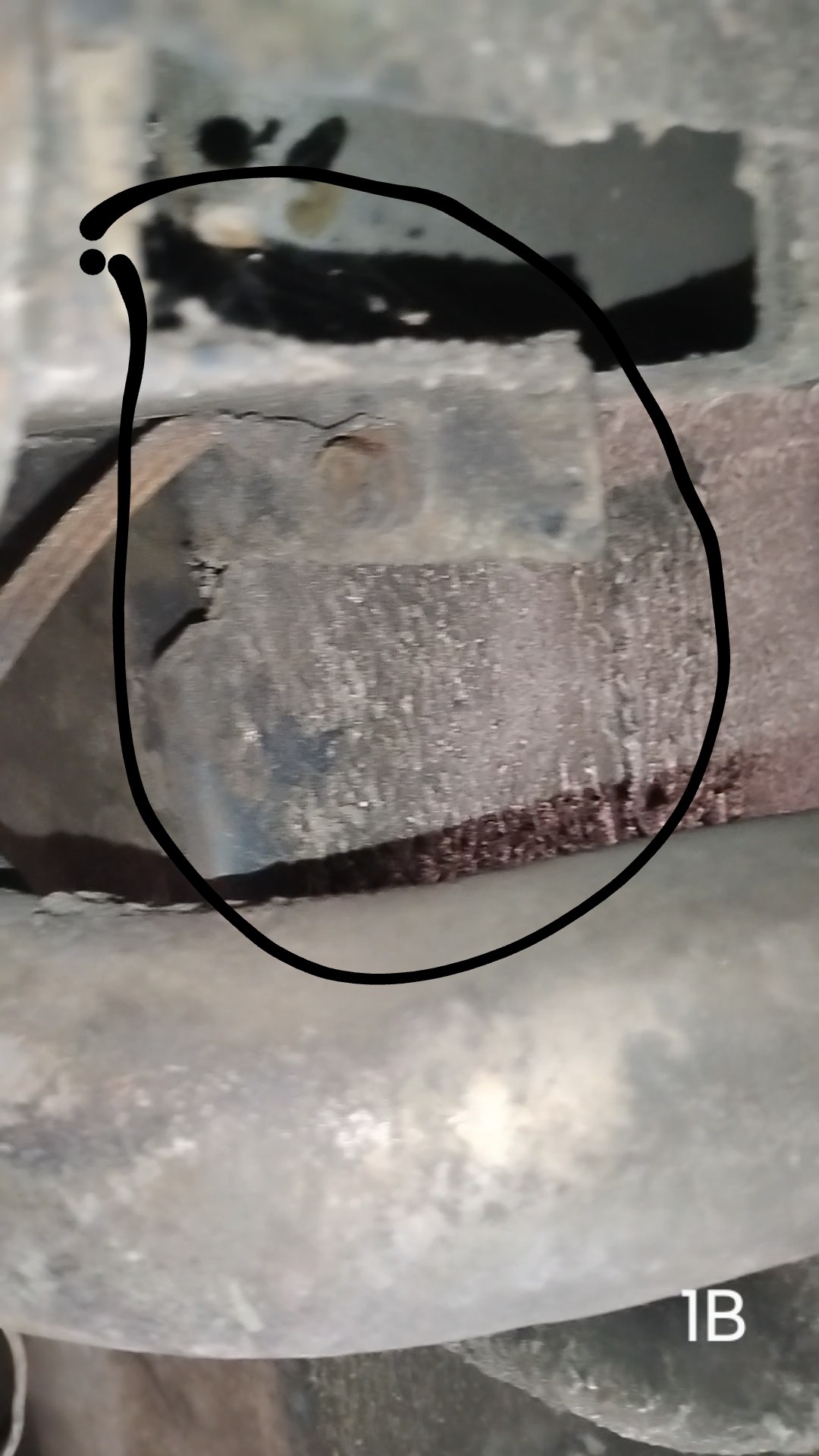

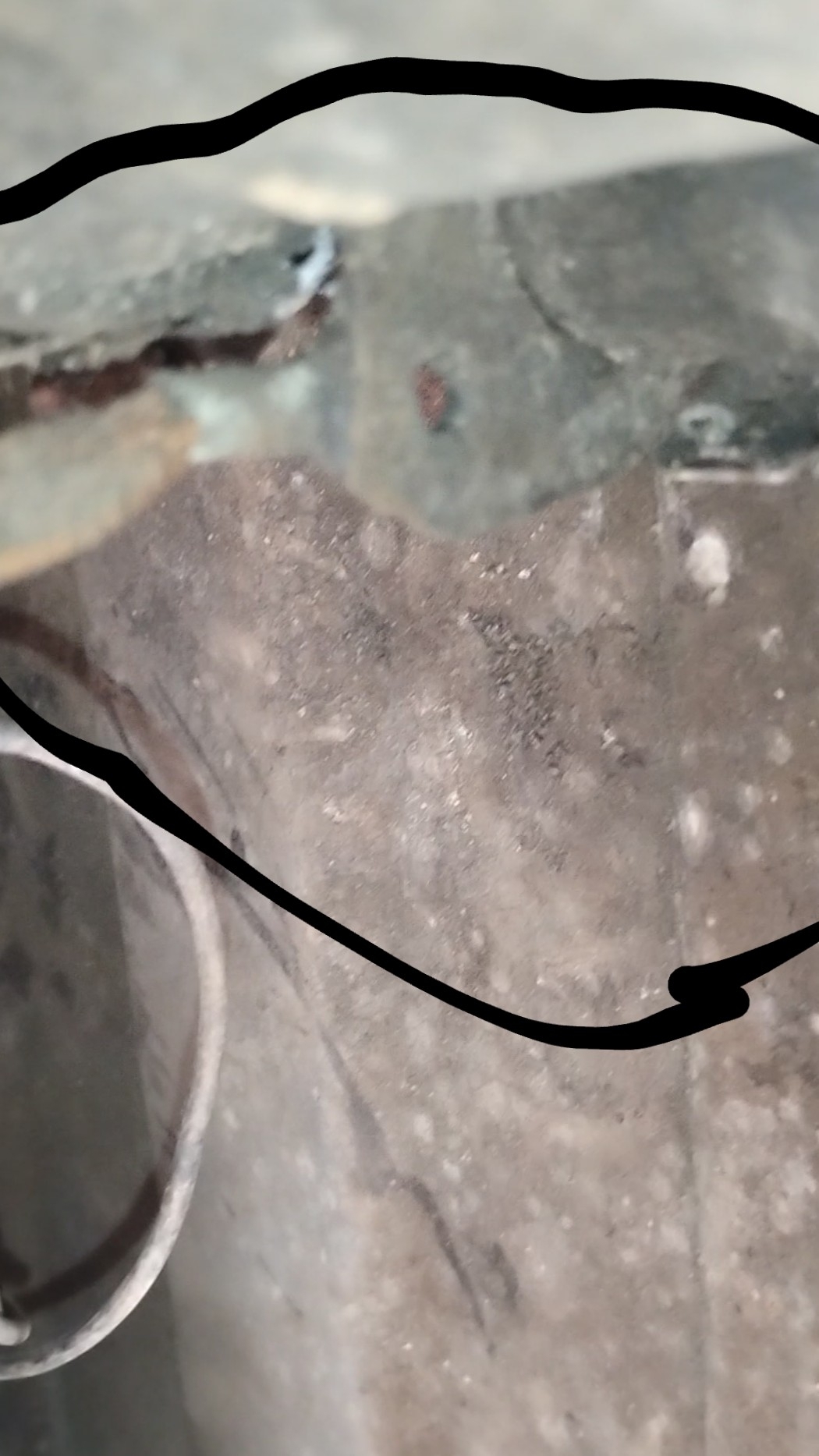

Here is some photos from underneath the truck, a sensor on the block and the other speaks for itself. How many things do I need to fix and could this be the problem? ?

I got the crankshaft sensor out and it was filthy, I cleaned it, and bench tested it and got a small reading from it but the problem is I think between the dirt and the messed-up wiring as you seen in the video that that was my problem. I have to put it back on and put fluid in that I lost, and then do I have to reset the timing or go straight to trying to crank ?

I put the cleaned crankshaft sensor back on and still no change. I didn't mess with the other sensor and wonder if I should take it off and clean it? I included a picture of the one in question. I don't understand because at one point the truck actually did turn over and crank for a moment (I sent a video remember?) so it has to be something I did wrong between them and now. The codes are back on the dash, and it just continues to flash 12. Any thoughts?
Apr 10, 2025 at 1:13 AM
STEVE W.
  • 15,354 POSTS
Flash 12 just means it hasn't stored a code. If it was mine, I'd start at the basics. You know it turns over, so that's okay, you had it running before so it should have compression and be in time. So that leaves spark or fuel as the likely culprits. With the way it has progressed as it is getting worse, I would look at the PCM itself as being the item that is failing. It could be as simple as a bad capacitor in the PCM that shuts off fuel or ignition as soon as it heats up. I would probably proceed by using an OBD I scan tool like a SO MT2500 or OTC Genisys to watch the live data from the sensors that it can show and see if there is something there that gives a clue.
