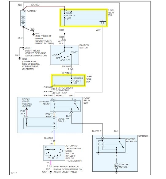

Swapped the transmission out and now that I got it back in and everything it won't crank. It sounds like the starter is getting hung or something not really sure.

Good morning,
Is the starter making any noise in the start position?
Did you verify power to the solenoid for starting in park and neutral?

It's clicking and I looked at it while a buddy tried to crank it and you can see the starter come out barely and go back in.

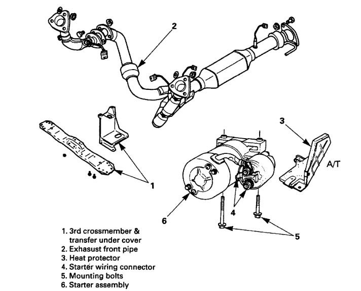

Can you verify voltage to the starter solenoid? If it has battery voltage cranking, then you have a bad starter.
Removal
Preparation: Battery ground cable
1. 3rd crossmember & transfer under cover.
2. Exhaust front pipe.
3. Heat protector.
4. Disconnect the starter wiring connector from terminals "B" and "S".
5. Remove mounting bolts on inside and outside.
6. Remove starter assembly toward the bottom of engine.
