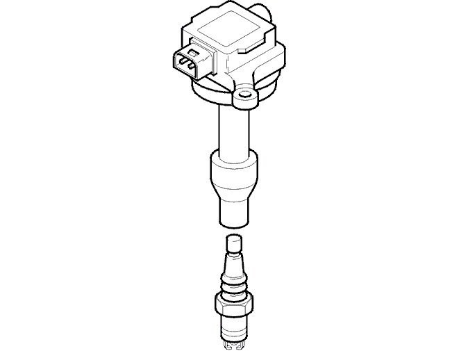

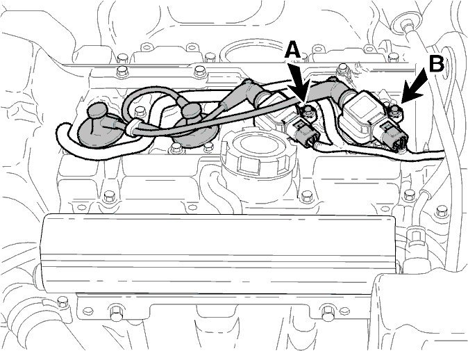

Car was running fine until we changed the spark plugs. Now it cranks but will not turn over.
May 28, 2018 at 1:41 PM
  • 110,244 POSTS
Hi and thanks for using 2CarPros.com. Either you have not reconnected the coil packs or you switched them and not it is out of time. Here are the directions for removal and replacement. Read through them and see if there is anything you missed.

Pull off the ignition coils.
Remove the spark plug with special tool 999 5702 Socket See: Tools and Equipment999 5702 Socket.

Position the ignition coils. Press the ignition coils into place.
Tighten the screw. Tightening torque 10 Nm .
Connect the high tension cables.
Reconnect the connectors.
Note! The grayconnector is for the left coil (cylinders 2 and 3), the blueconnector is for the right coil (cylinders 1 and 4).

NEXT: If everything is okay, read through the following directions related to removing and replacing the coil packs. NOTE: It indicated the wire colors related to cylinder location. Make sure you have them correct.
Reconnect the connector.
Note! The gray connector is for the left coil (cylinders 2 and 3), the blue connector is for the right coil (cylinders 1 and 4).
