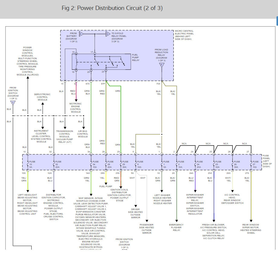

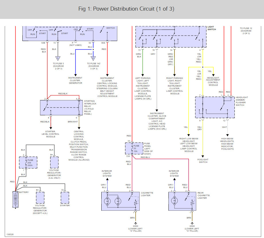

No current on fuse 32/ 34 plug did not spark, no current on crankshaft sensor. also, no ground on crankshaft sensor.

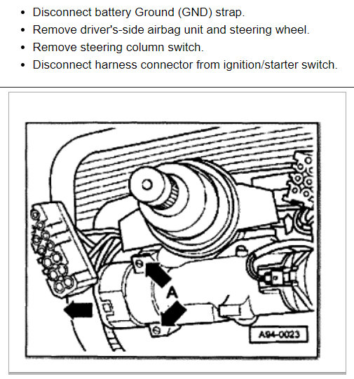

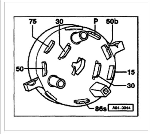

It looks like you lost the ignition switch, but to confirm the issue follow this guide to test through the switch.

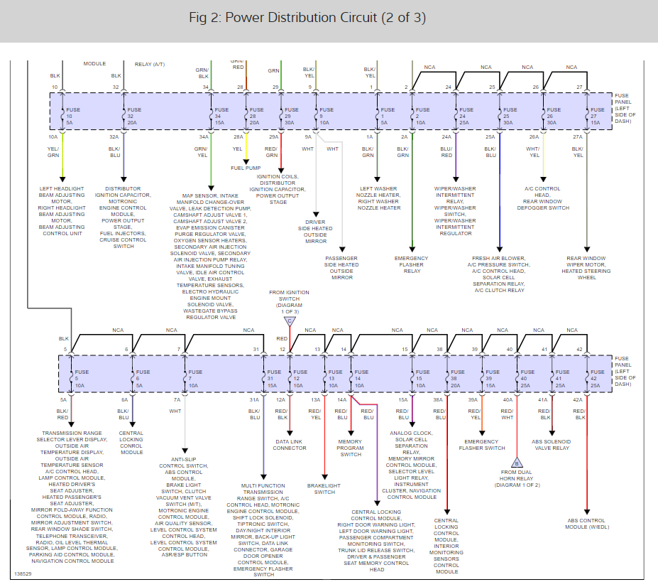

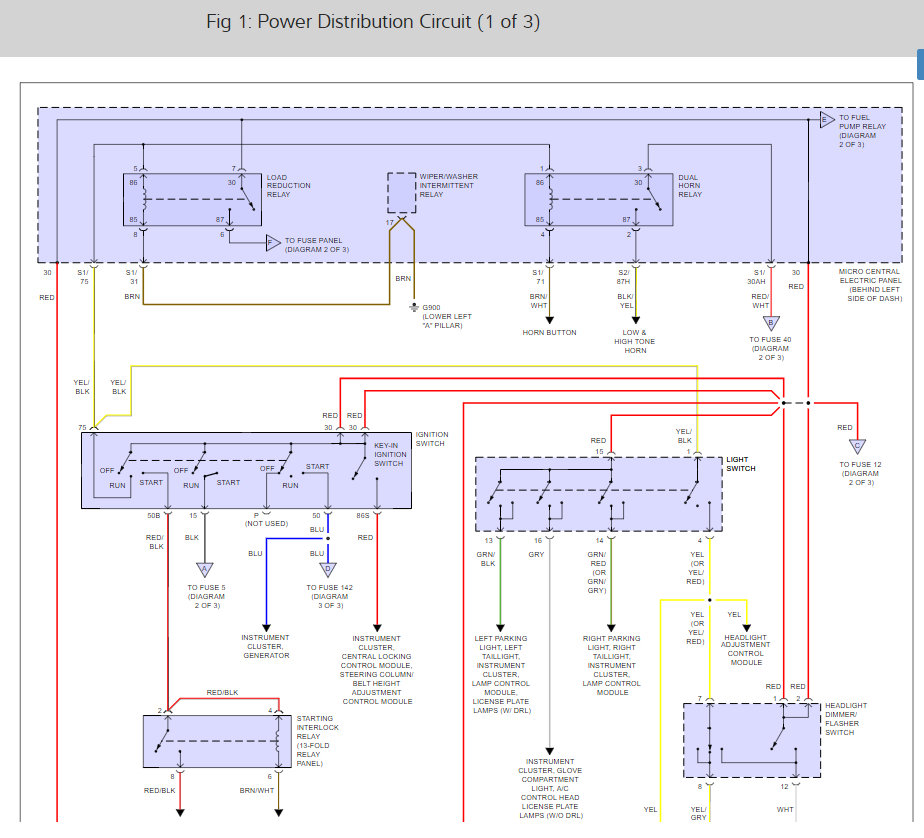

Here is the wiring diagrams so you can see how the system works and the ignition switch removal diagrams
