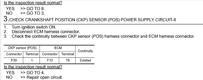

I changed the crank sensor and Nissan tested it with a known good sensor. And there’s nothing on my tachometer when it cranks.
May 4, 2023 at 1:40 AM
  • 110,241 POSTS

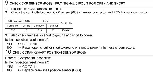

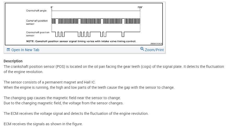

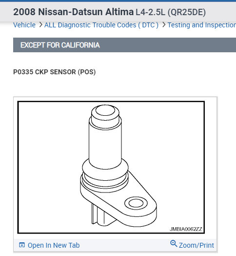

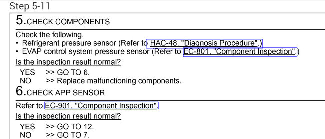

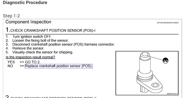

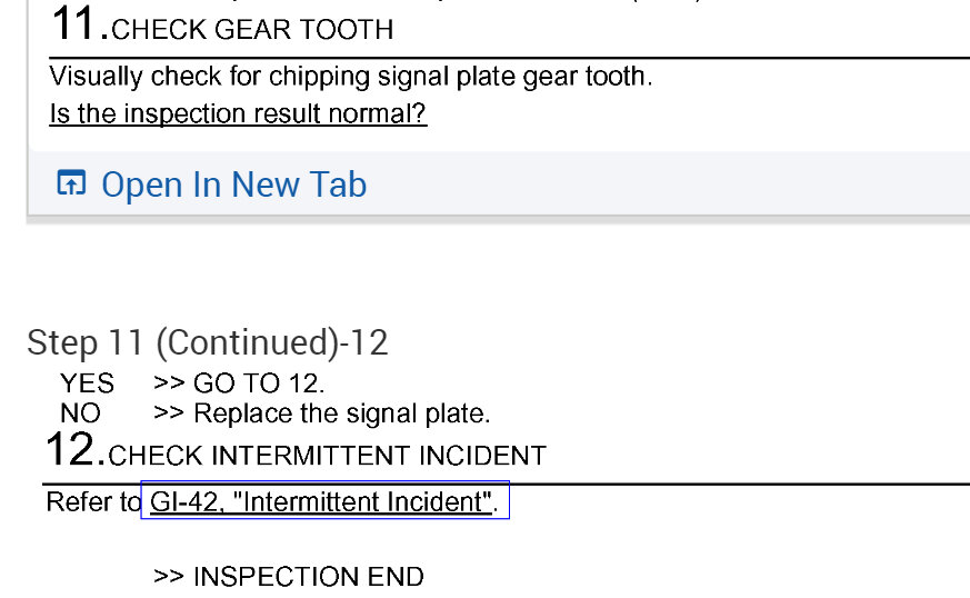

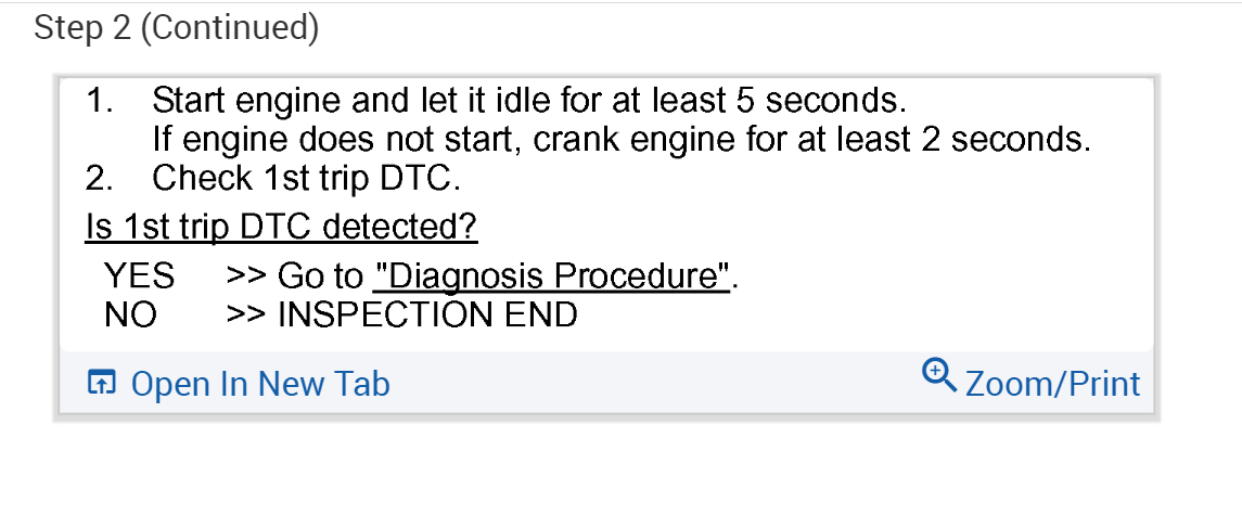

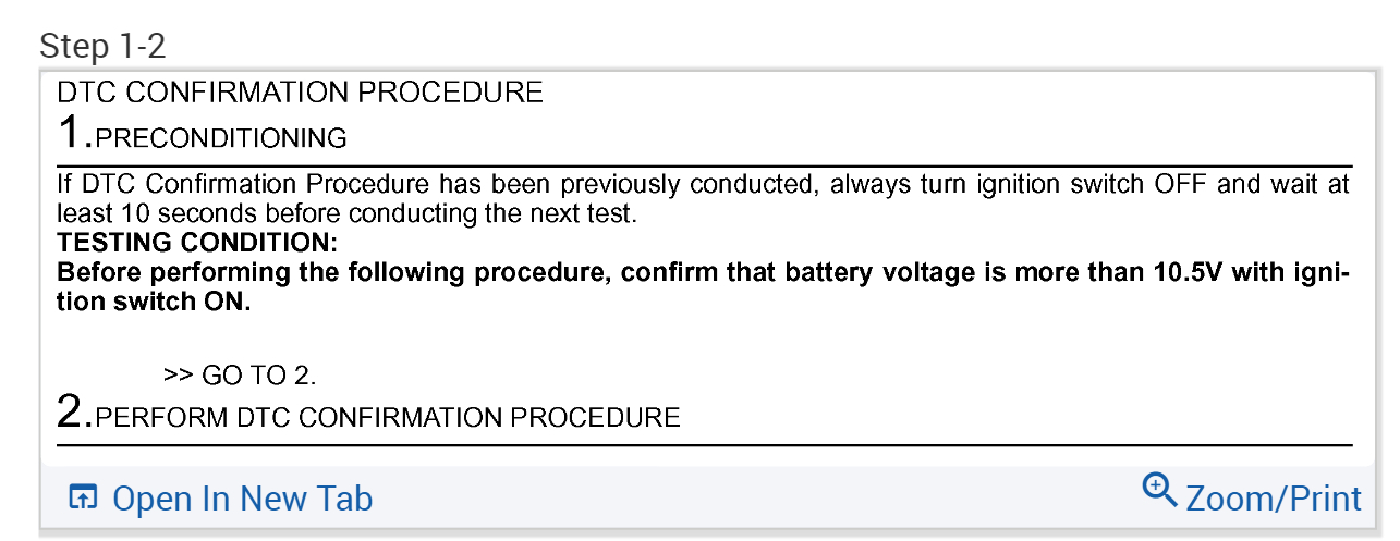

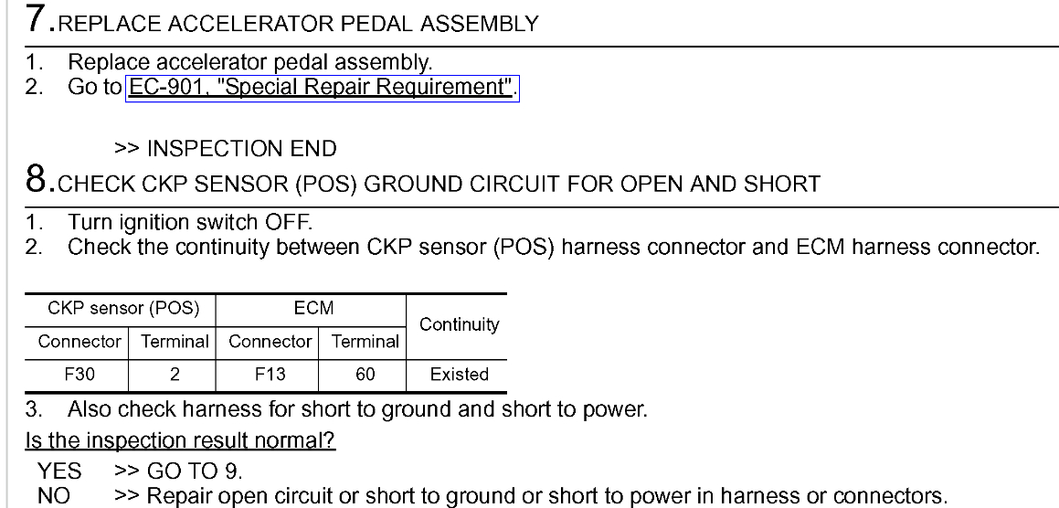

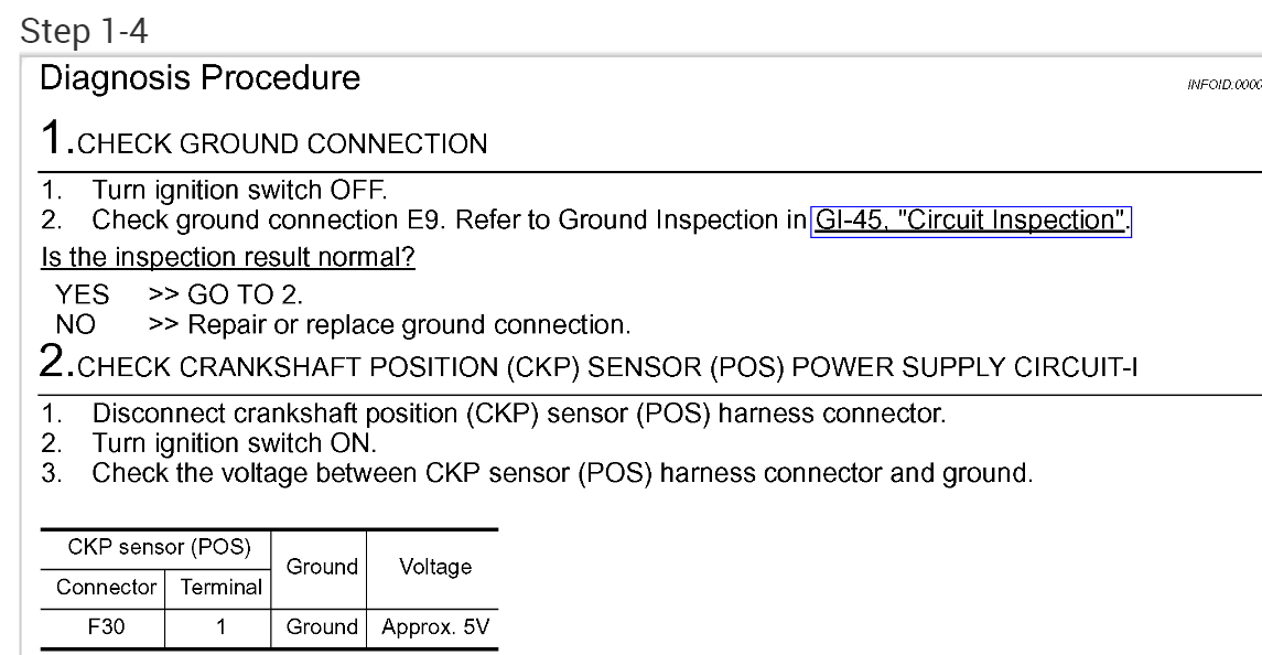

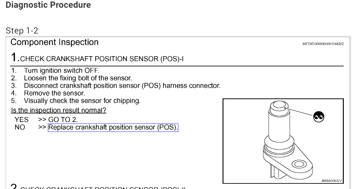

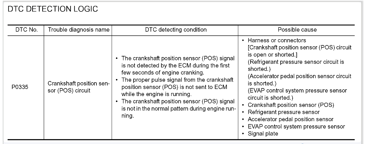

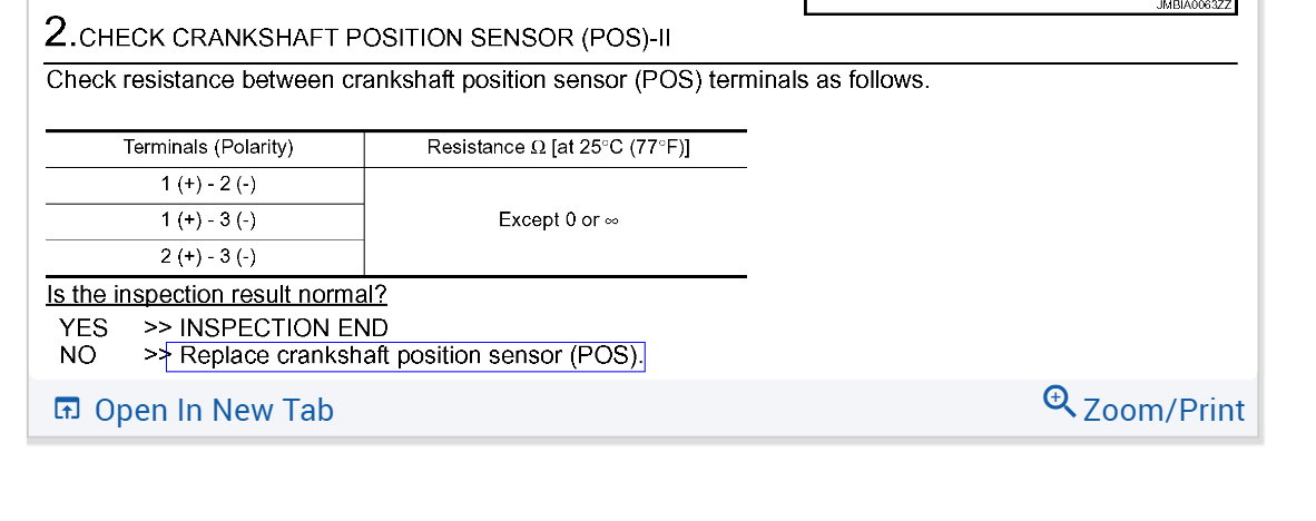

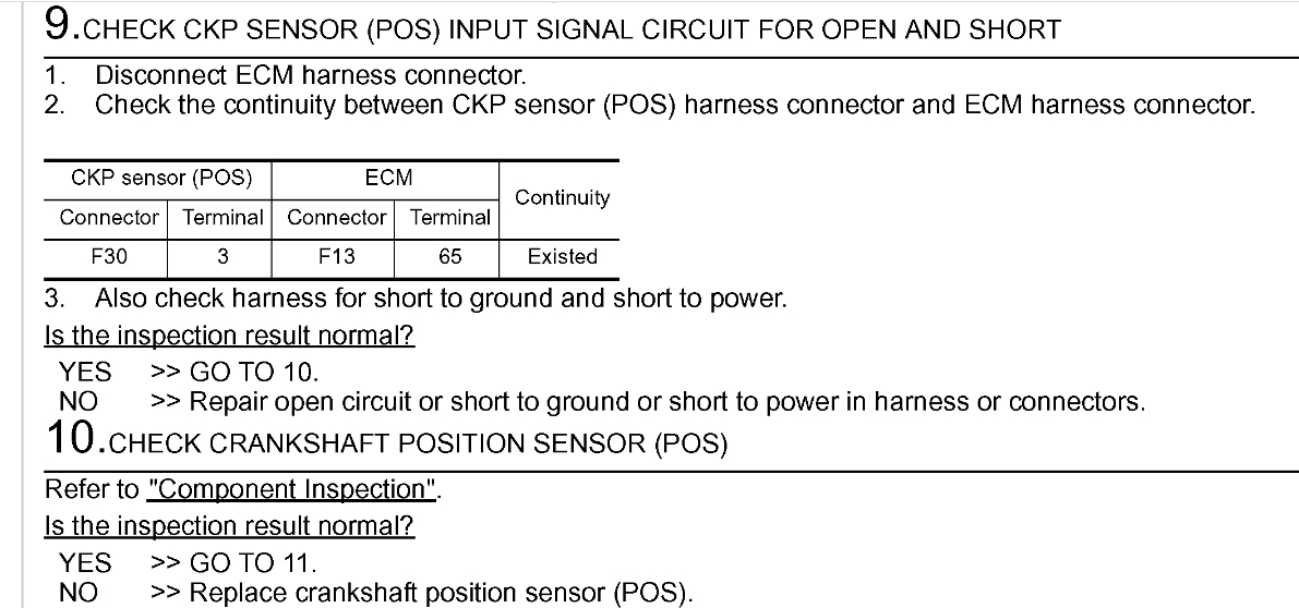

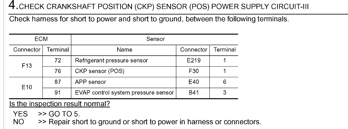

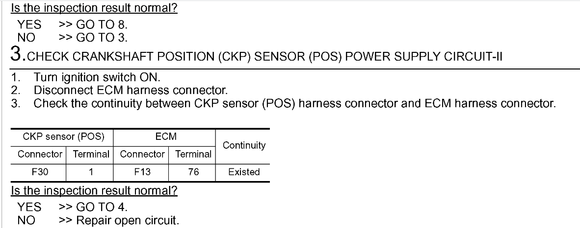

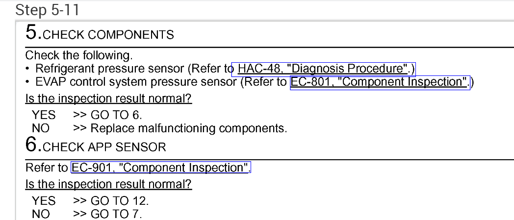

If there is no RPM signal, then we likely have an issue with the wiring at the sensor or the PCM.
Do me a favor. I attached the diagnostics below for you. Take a look through them and let me know if you are comfortable performing them.
I realize you are not finding codes, so I selected a P0335 because it checks both the electrical and mechanical portions of the system.
